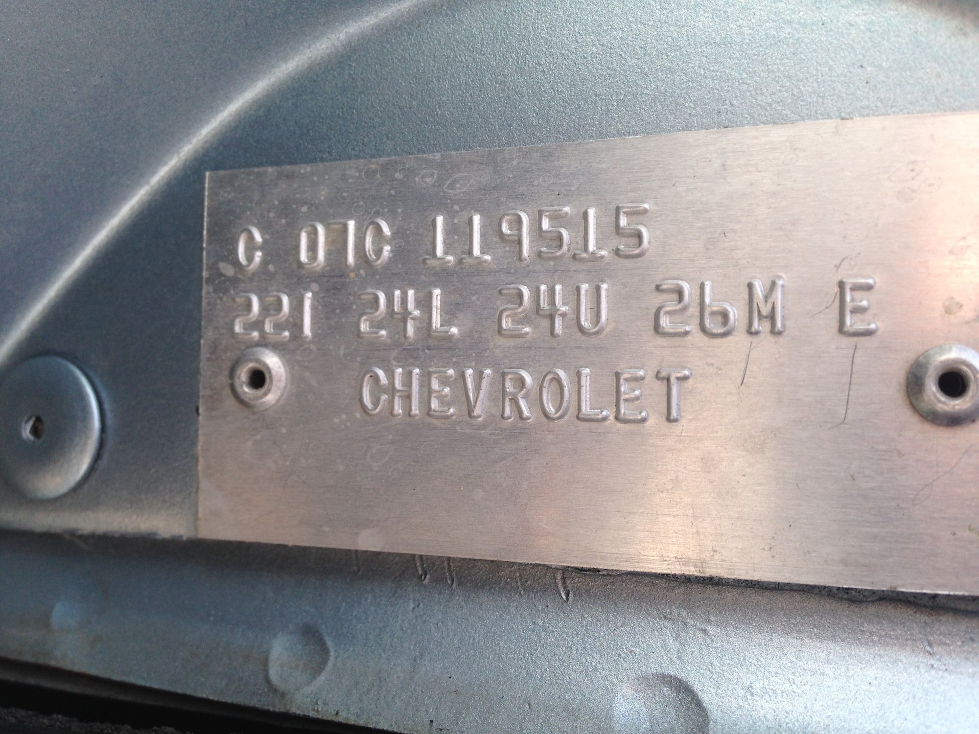

This is my interior code, I'm trying to order new carpet, but can't quite decipher the code:
Oh yeah, 1982 C3 Corvette..

It appears the only recommended interior color available for your exterior colors 24/26 (Silver Blue/Dark Blue) is dark Blue, code 221.

We know. The C is the code for the 1982 model year.
07C indicates the seventh month of production, third week of the month (C).
Remaining characters are the consecutive unit number.
