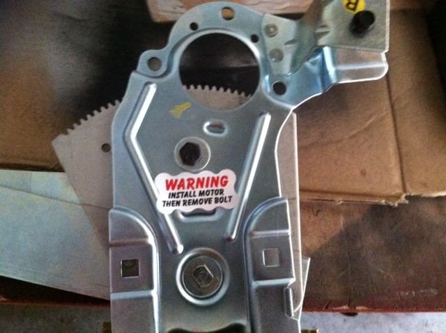

Right now I am rebuilding everything in my doors and had the same issue with the window not going up. I messed around with a ground wire to the door itself and managed to move the window. The first thing I did was REMOVE the glass. You just need to get the window to where you can uncrew the glass from the track then slide it out. The other thing I noticed, and I could be wrong here, but I think the bolt is there not only to keep the glass from falling, but to keep the track ( which is under tension) from slapping down on your hand. Once you take the motor out that spring will unwind. I would put a short 2 X 4 under the glass, but I think there might still be rpessure on the spring. Here's the warning that came on my new regulator

You are right the spring is going to be under tension. As soon as i remove the motor that spring will likely unwind. Been doing alot of forum searching but i havent figured what im going to do yet. I dont really want to pull thw whole assembly out of the door.

KEEP IN MIND...the regulators SPRING is APPLYING FORCE UPWARDS....to compensate for the weight of the door glass. So working on the motor with the regulator IN THE CAR....the glass is not going to come down on you with any force. The window would go UP when you remove the motor IF the spring is good and tracks are lubed.

Im planning on doing it with the regulator in the car. With the bolt through the regulator from what i have read it should keep the spring from unloading. I have been following this guide i found. http://www.corvettemagazine.com/tech-articles/1968-1982-power-window-motor-replacement/
Makes sense that the window wont fall with alot of force with a good spring.

The spring CAN NOT UNLOAD because you have the regulator IN the car with the glass attached...so window stops will prevent the door glass from flying out of the car this due to the motion of travel that the regulator has can NOT be hyper-extended. THUS...the spring can not unload. It is physically impossible.
NOW...if you have regulator OUT of the car with the power window motor still attached....then YES...the bolt MUST be in place prior to removing the motor. I agree with that...but putting a bolt in it is up to you....but as like I wrote....the window is going to go UP when the motor is removed....NOT down....due to the spring pressure.

I received my replacement motor this week and I had a chance to install it last night. Extremely easy process only took about an hour start to finish. I did put the bolt through the regulator just to be on the safe side. I only had to loosen a couple bolts on the regulator in order to remove the old motor. Now the driver side works so well it makes my passenger side look slow.
