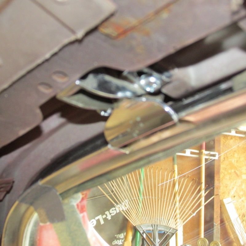

After rebuilding accumulators, headlights open perfect.
Name:  Vette Work 06 (800x800).jpg
Not so good in the closing, any Ideas ?

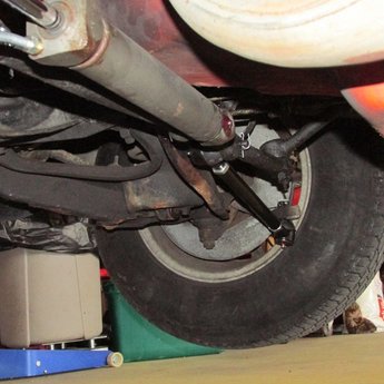

Here today to "Testify Brother"
Storm was having a nasty habit of pulling to the right. I had not
yet scheduled an alignment, so I looked though the Threads.
Low and Behold , Control Valve Adjustment !
10 Minutes , $0 , what a Great Place !!!!!!
While there , replaced the last of my free parts (that came with car) ,
the power steering hoses.
More updates soon.
Have a Great Day,
Bill

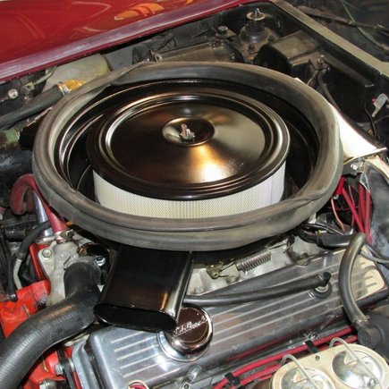

"New" air cleaner hook up' (thanks again redvetracr)
Name:  Vette 035 (800x800).jpg
and hole for PCV
Name:  Vette 033 (800x800).jpg
Complete
Name:  Vette 036 (800x800).jpg
Now just need to clean-up and repaint.

Found some time to clean and repaint air cleaner.

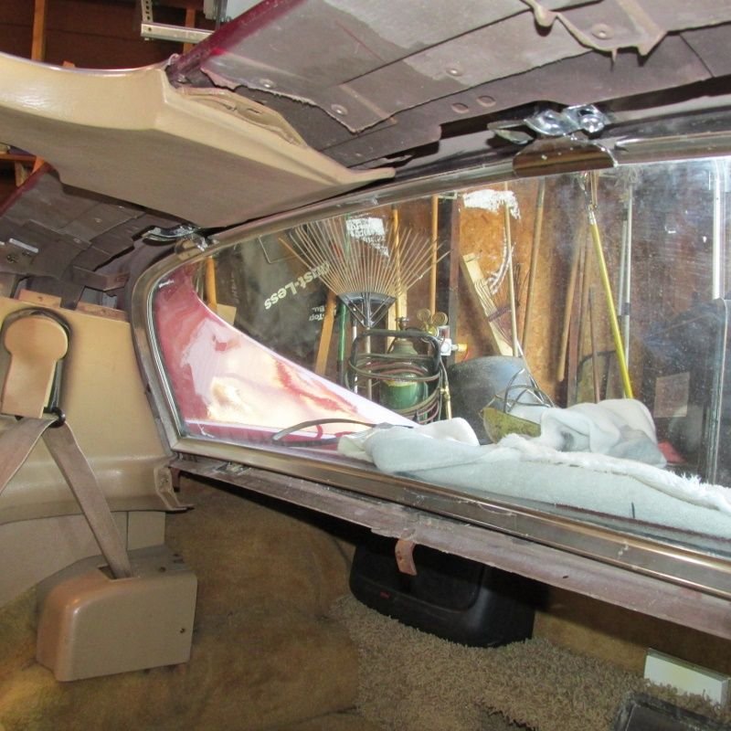

Trying to get another project done before the SNOW comes.
Back window was leaking anyways.
And I heard of these "removable" back windows.....
Lowbuck72 needed paint supplies.........
So, here I am, trying to help people out.........
And I did read that the installing the seal was messy. But I had no idea it was that BAD !
I still need to adjust the latches some, when I an find time.
Have a Great Day
Bill

Doing some good work there, Would you mind getting a little more in-depth with the removable rear window? I have all the parts to do mine but haven't started (still dealing with the dash Charlie Foxtrot), but hope to in the not too distant future. Thanks and keep up the good work

As far as installing, pretty straight forward. Only problem I had was finding the right size "u" nuts for the latches. (3 different hardware stores) If you have any problems or questions, let me know.
