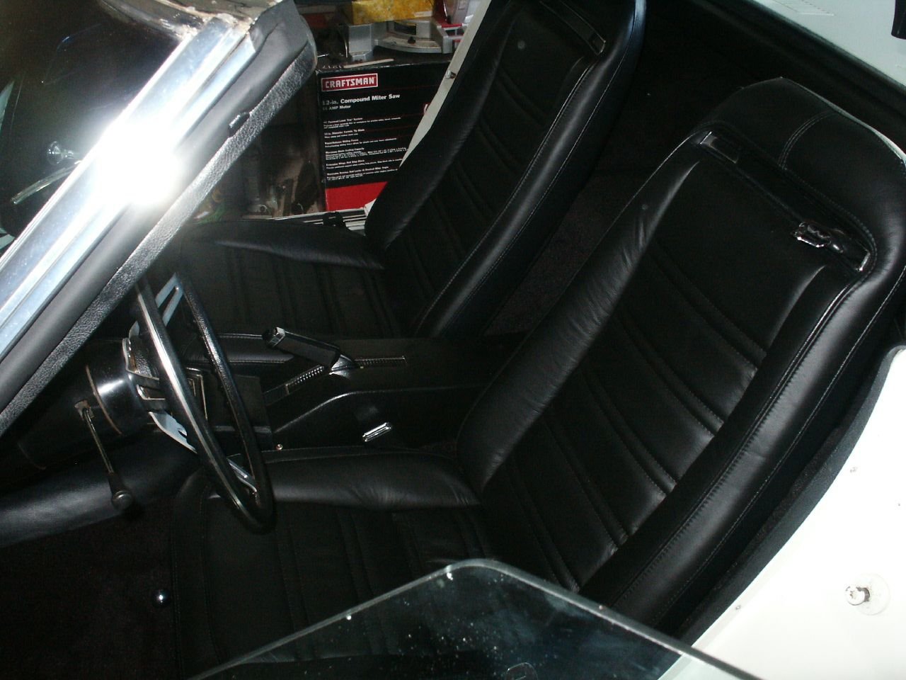

First restored the frames:
Then installed the foam and covers. Completed work:
Donnie

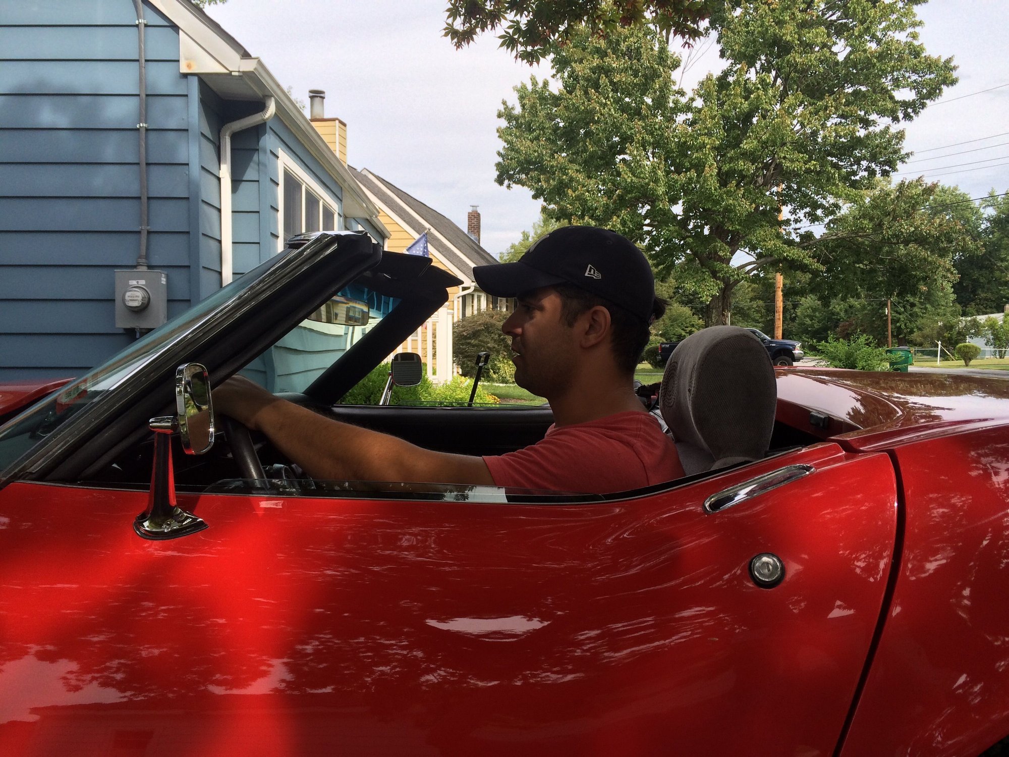

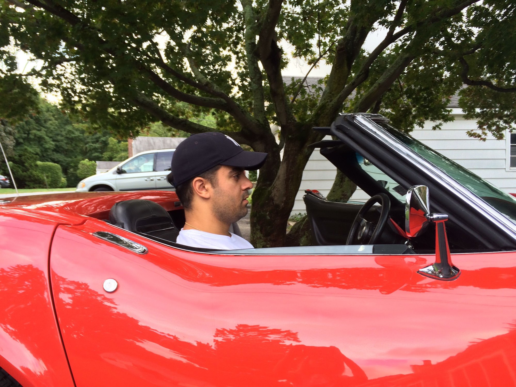

So here are a couple pics to show the height difference with the Fiero seats. It looks like I sit about 3 inches higher. Part of that is probably due to being able to adjust the seat back.

LOL, you look kinda short in the original seat now that I see the comparison.
Much more 'in charge' in the drivers seat.
But in a convertible, maybe originals look better.
Also I noticed on MrMikes web site that some people pulled off the headrest for convertibles. Maybe that would work for you.
Ken
