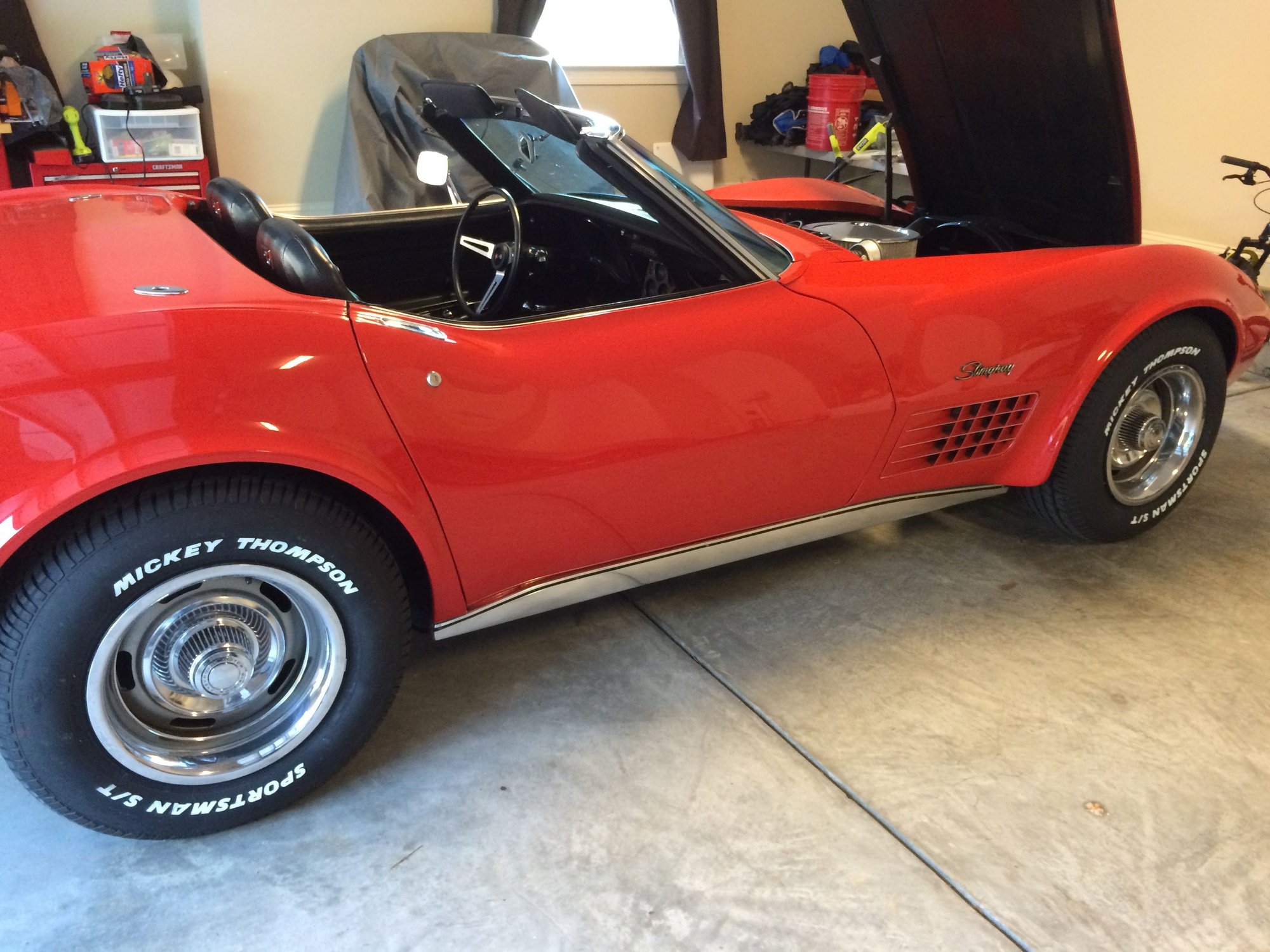

Just went through the same thing on my 70 convertible. Chose Mickey Thompson Sportsman S/T 225/70/15 with the RWL out (personal preference). The hardest part was having to order them online, then arrange for a shop to mount/balance them.

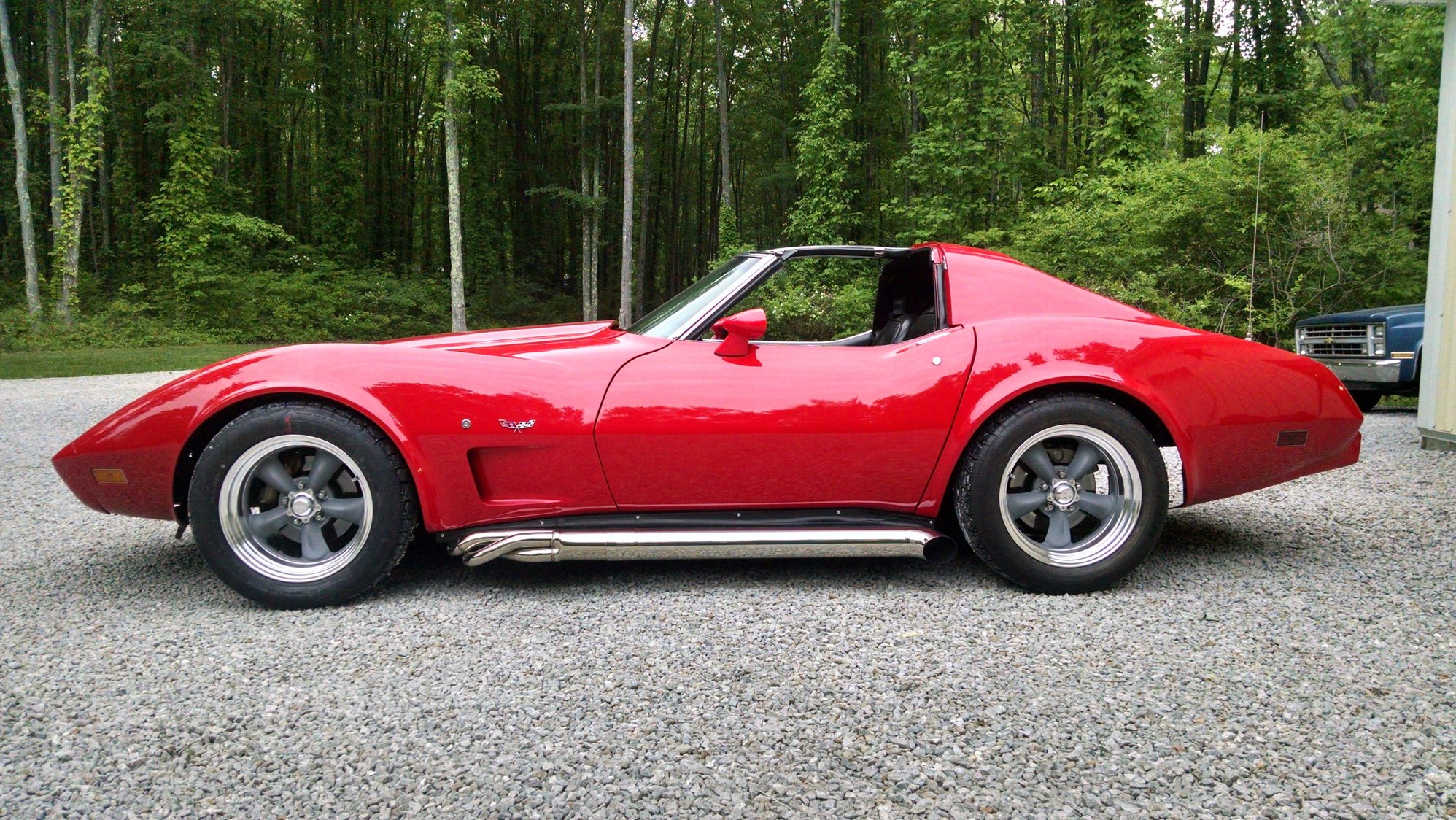

Originally Posted by MelWff
I gave up on the whole 15 inch issue. Went to 17 inch which permitted going to a "W" rated summer only tire. World of difference compared to the S/T rated tires even at legal speeds.
I installed 17" as well. A "world of difference" is an understatement. The handling improvement is amazing.
I used YearOne 17" rally's with Michelin 245/50/17.
To C3 Tires
Old Sep 4, 2015 | 12:53 PM
Mikado463's Avatar
Mikado463
Joined: Feb 2012
Posts: 5,676
Likes: 543
From: SE Pa
looks superb Barry ! ………
