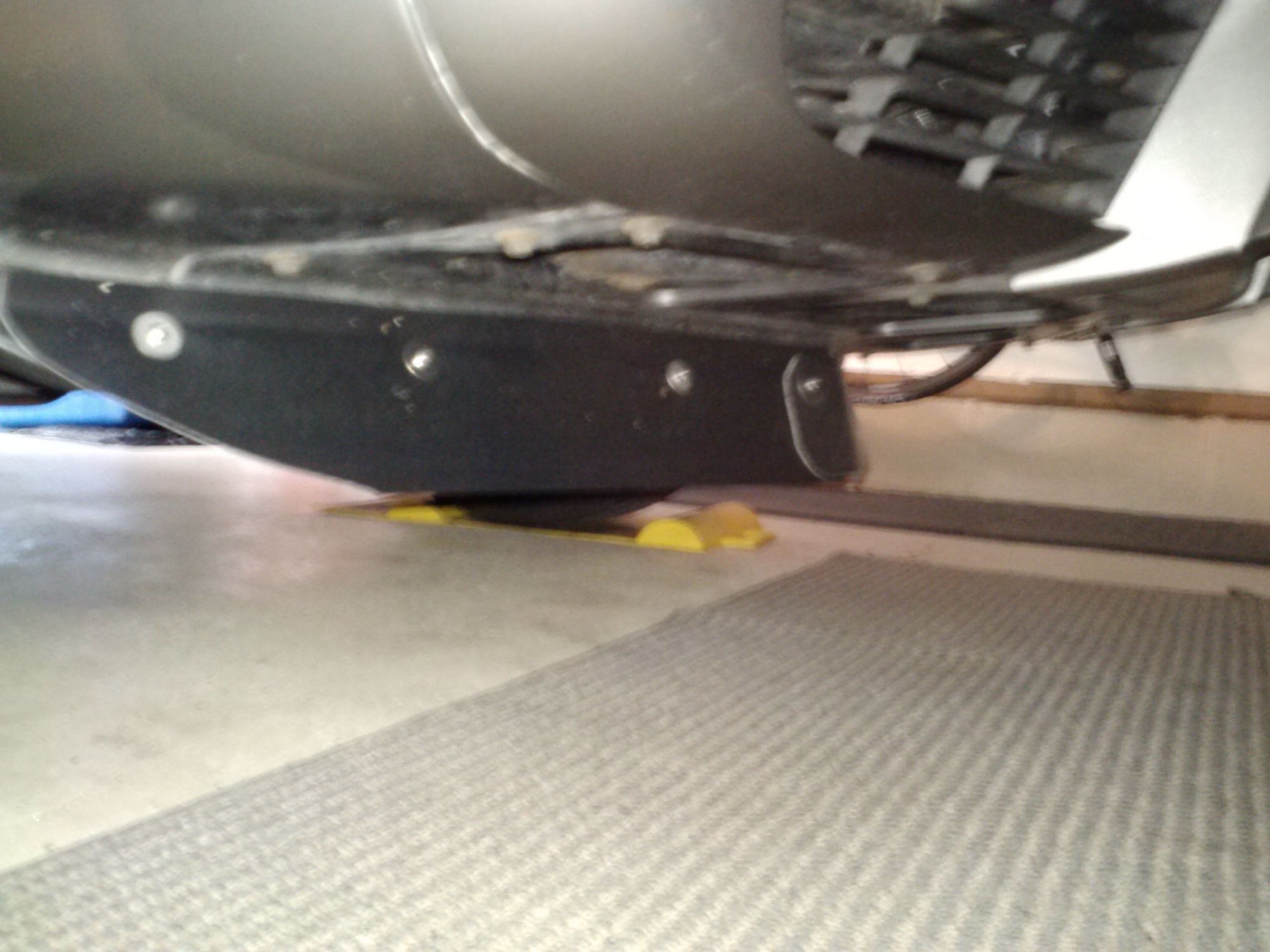

I made an air dam extension like the one pictured in this thread.
https://www.corvetteforum.com/forums...am-wanted.html
To spoiler and engine temp
