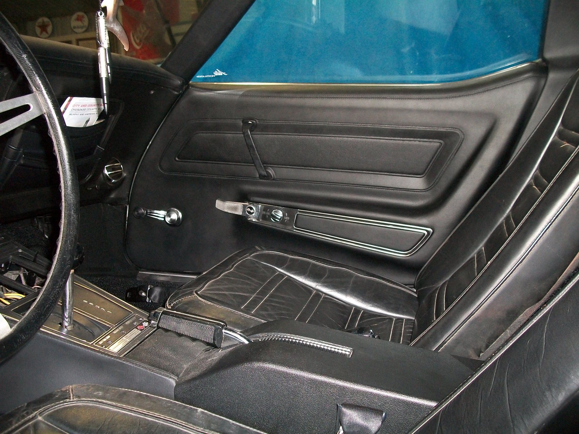

These were replacement panels (plain) and the weave is heat pressed in where the originals were

That's what I have those are the standard ones? Where did u find those or are they original?

His look just like mine, and mine are standard repros...

Those are standard style, replacements, Corvette America awhile back.
I think pretty much all are the same, check with Willcox, I'm sure he'll treat you right

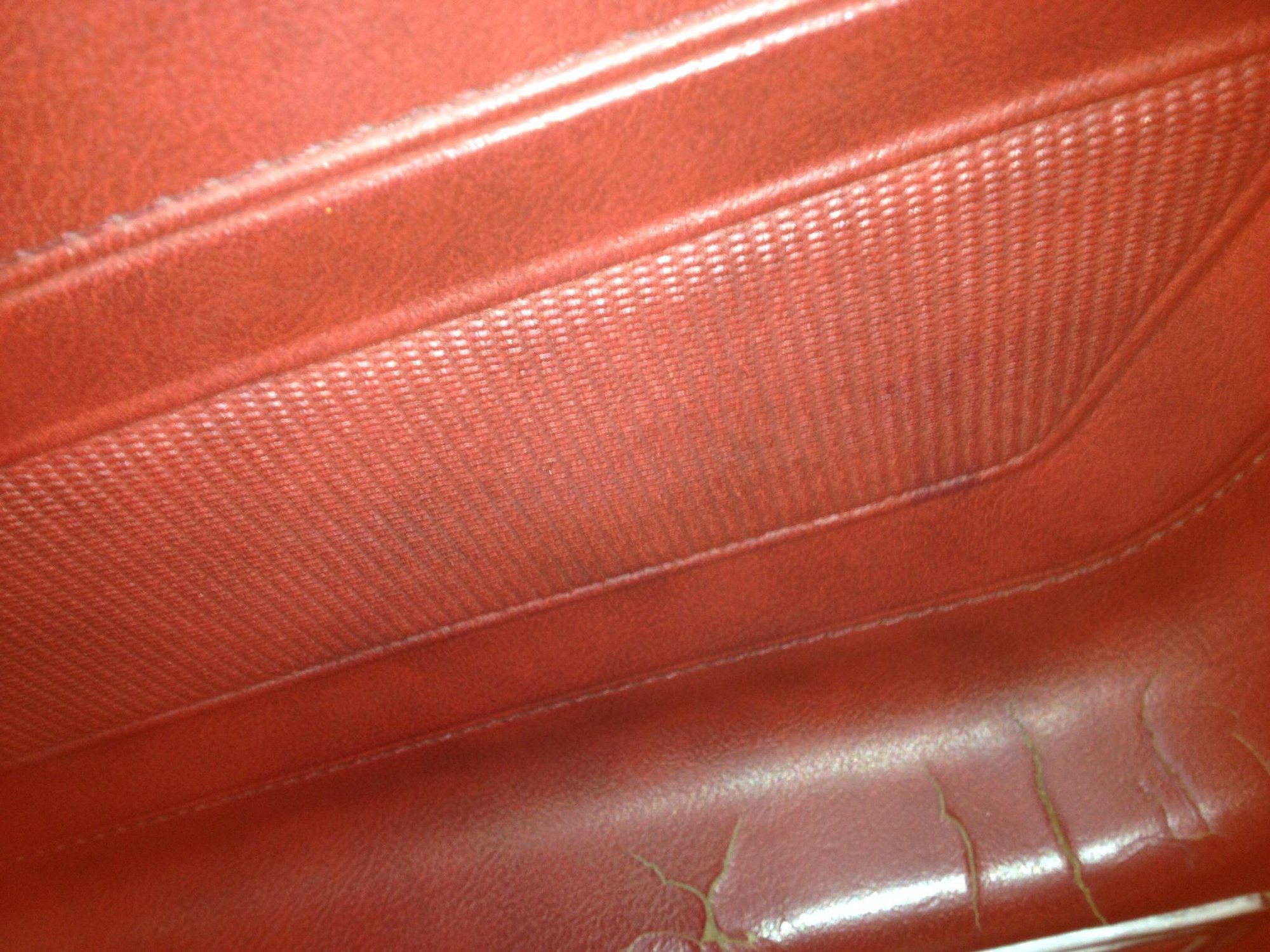

Like this

Mine were standard C.A. repros from Willcox, and they do have the texture like the one in your last picture.
I do see what you mean though..... after checking on the Willcox website. In the pictures of the door panels it is VERY difficult to see the texture.

While all of the current reproduction door panels I see have some degree of the 'comfort weave' detail in the vinyl, none of them are nearly as distinct as it is in the original door panel vinyl.

Standard door panels didn't use wood grain trim, only the deluxe panels used the wood.
When you had deluxe panels you also had a metal chrome plate (shown below with the wood on it) that attached over top of the "weave" area in your panel. All panels from 1970-1977 had the weave... the chrome plate for deluxe just covered it up. If you had deluxe panels and removed this metal plate from a deluxe door panel you'll find it's got the weave under it.
But.... Your car didn't use the wood trim...
