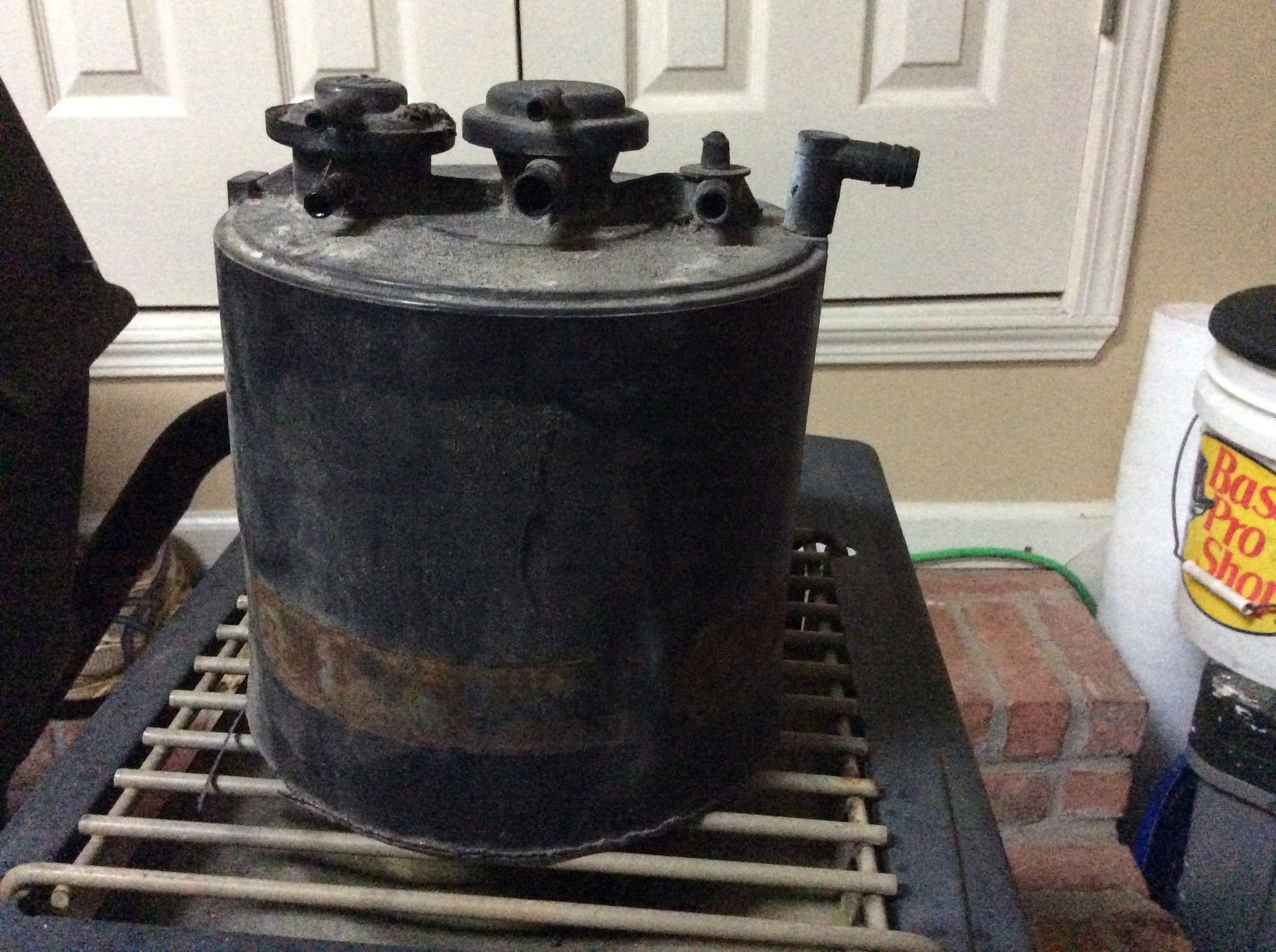

Do you have a pic of this charcoal Vapo Cannister? I have a very original 81 and am curious what this is.

It is located in the LH (driver side) fender behind the wheel. I had to access the retaining bracket through the fender vent and by removing the front wheel. I removed it with all the vacuum hoses attached which was good, cause they are really tight on the original Cannister. It is obvious the charcoal has broken down to a granular form, especially when comparing it to the new Cannister. Here's a pic of the original Cannister.
