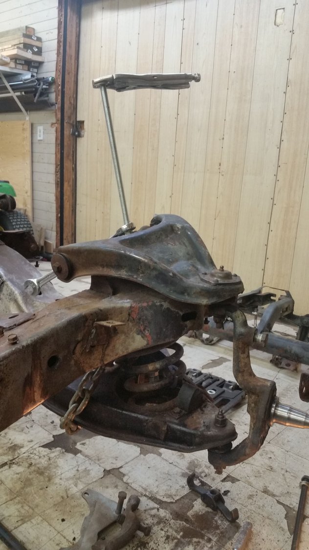

Hi I hear everybody say to use safety chains when removing coil I have never done this before where do I put the chain or what do I chain it to

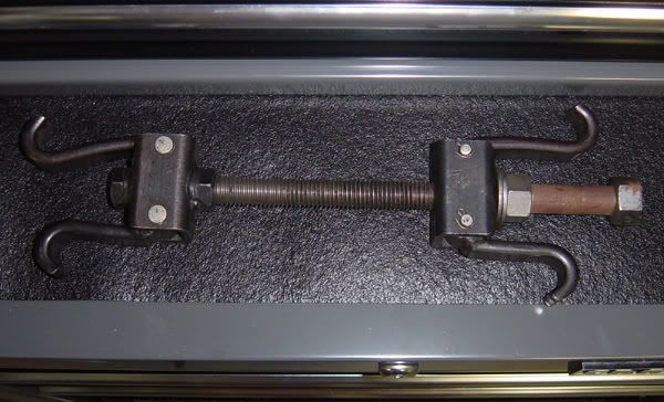

I have a proper spring compressing tool...
...but you should be able to rent one from your local parts store.

I use a smaller link chain than the one above......this is not the easiest method, but it works if you do not have the correct spring compressor.
I run the chain over the highest coil that it will fit over/feed the chain down the inside of the coil/run it under and out the lowest coil that it will fit under.......
then I do the same with a second chain 180 degrees across from the first chain.
Next I use a long threaded rod to compress the coil spring as much as possible........then I pull the first chain tight and secure the links with a bolt and nut.......
then I do the same to the second chain......
next I release the threaded rod/the coil spring is held compressed by the two chains....and remove the compressed coil spring.
Sometimes it is necessary to remove one of the ball joints that hold the spindle in place so that the coil spring will have room to be pulled out of the a-arms.

Hi Andy,
The chain should loop through/around one coil of the spring and then around the frame.
It needs to be tight enough to control the spring if something goes wrong, but loose enough that the suspension can be completely disassembled with the chain/spring still in place.
It's really just a safety precaution, but worth the couple of minutes it takes to set up. If it gets loose you don't want the spring to hit you if it flies up, or get you on the bounce if it shoots down to the floor and comes back at you.

Thanks alot Allan I am using your idea and I compressed spring up with long ready rod until a arm loose then split upper ball joint then ran nut up the rod and spring fell right out seemed to work great spring and a arm are on shop floor thanks everyone for the replys
