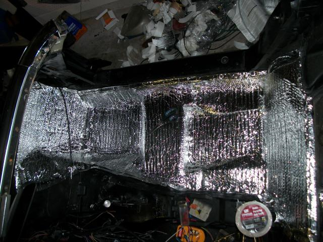

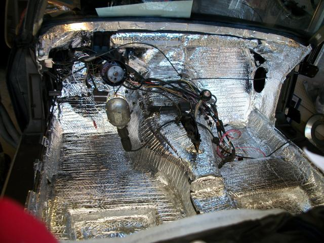

Rookie answer here......The thick factory insulation in my '68 was beginning to crumble. I wasn't concerned about originality---I wanted to reduce the heat coming through the firewall.
I removed all the original black "blanket" and covered the entire interior with foil-lined insulation/sound deadener.
The brand that you buy/the amount you pay is up to you---just know that updating/upgrading the insulation is well worth the effort in comfort.
I installed the material in sections and I used quality heavy-duty Aluminum Duct Tape to join every seam...........
