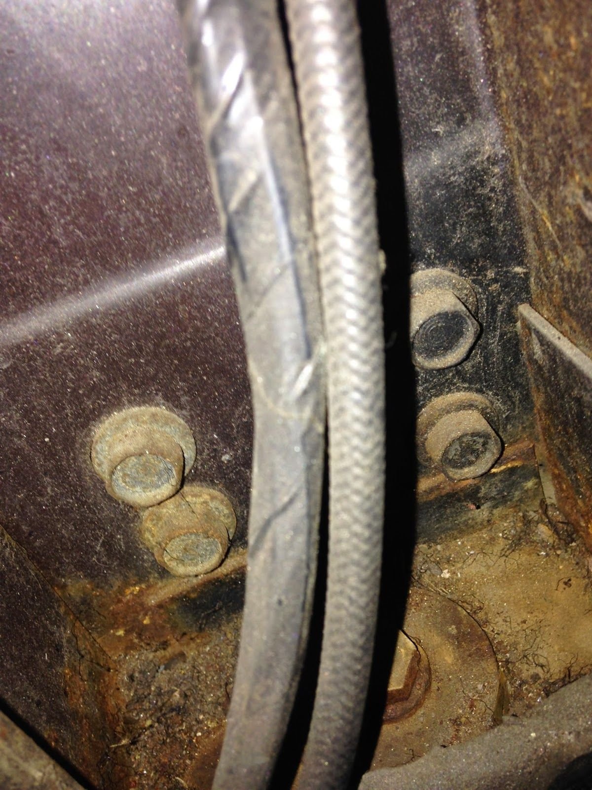

Another birdcage for your opinions. I will roll these up into an overall post once I get done. So far have evals on 2.
This one is from a 69 I am looking at. What are your thoughts? I feel like this one is decent and with a little clean up and treatment could be ok. Frame is in great condition and no other signs of rust damage around the windshield.
Old Oct 20, 2015 | 10:45 PM
Sunstroked's Avatar
Sunstroked
Joined: Jun 2006
Posts: 2,071
Likes: 147
From: S Nevada
The pic is a little dark but I can see where you may have a patch repair to do in that #2 mount area. Even my CA-AZ car had a little surface rust in that area. Clean up was simply a little bead blasting. The good thing is you are aware of a potential issue, it looks like it could be fixed easily enough.

Better shots of the driver and passenger side mounts. I don't mind something that needs a little clean up, but really want to avoid spending a ton on rebuilding. Thanks for the input guys.

I've seen worse though the rust looks a bit flakey. Is the metal solid around the mount? If the flakes are coming from the windshield frame there may be some issues up higher. If you place a piece of clean paper in that area, slam the door, do you get more rust flakes falling down?
Have you checked the lower windshield frame, just behind the hood surround? There's a wad of caulking the factory puts in that area which dries up and pulls away from the metal creating a pocket for dirt and moisture. If the birdcage has holes in that area, pulling the front clip is often the best way to make a long lasting fix. Project gets bigger.
