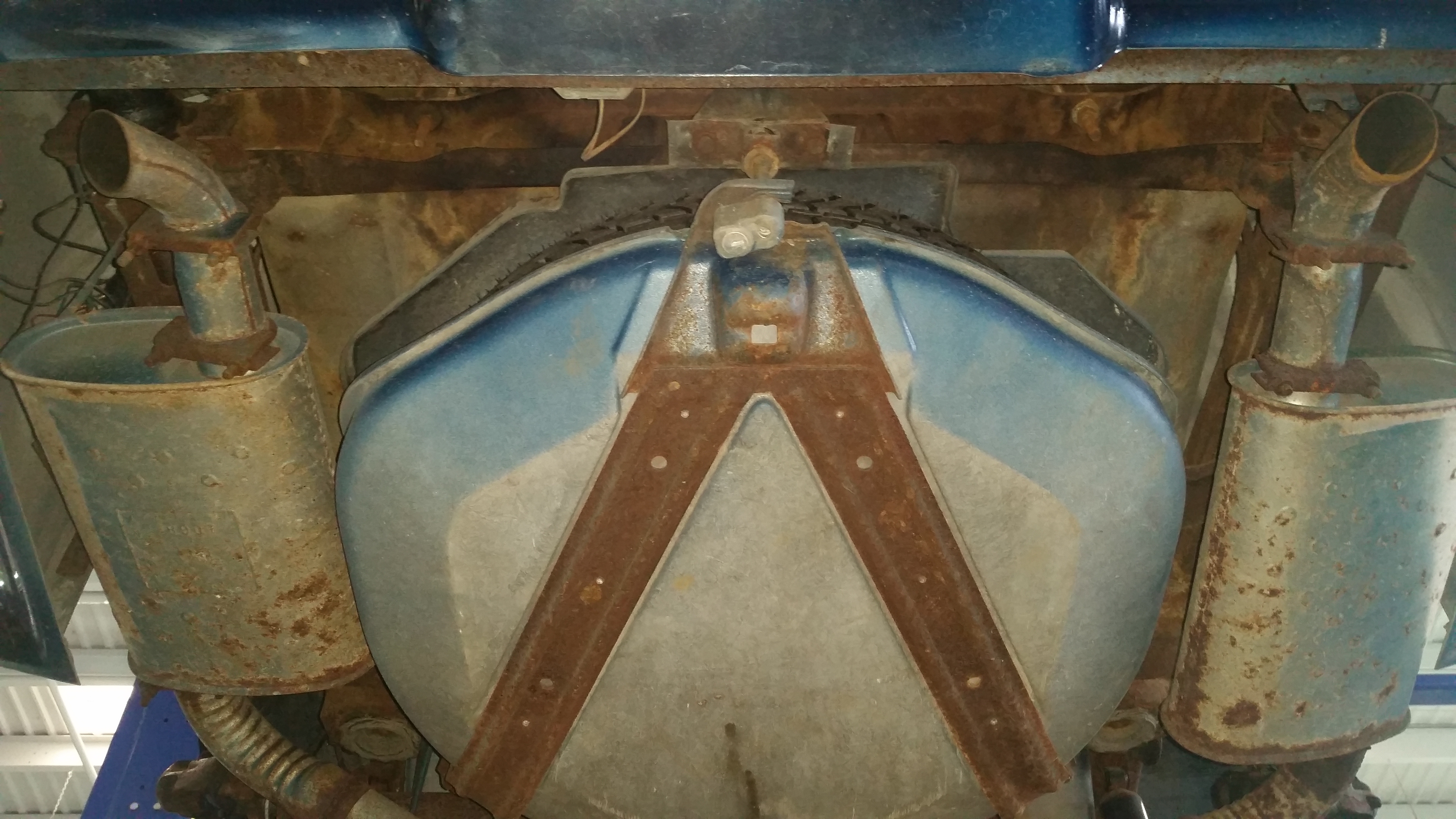

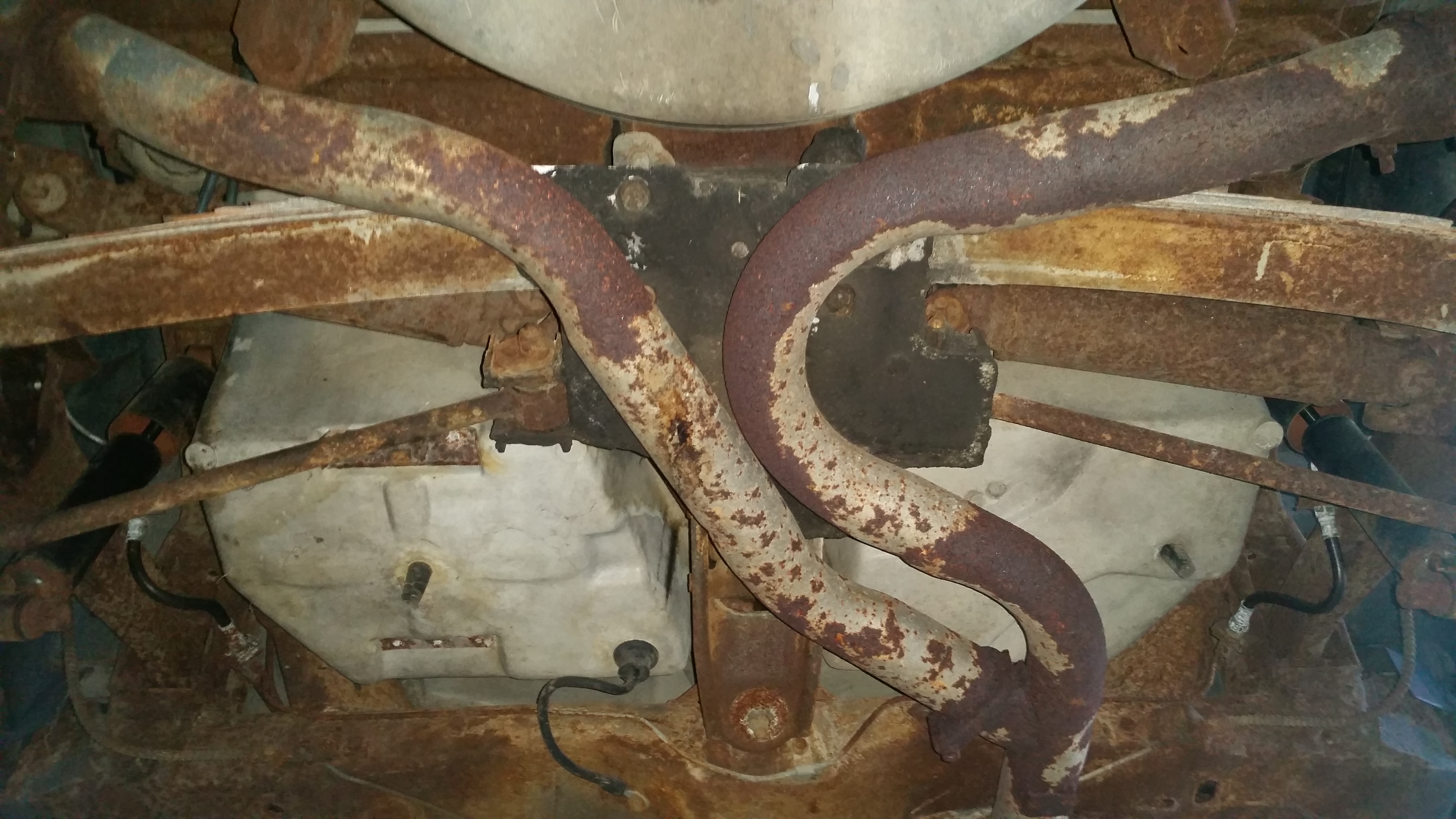

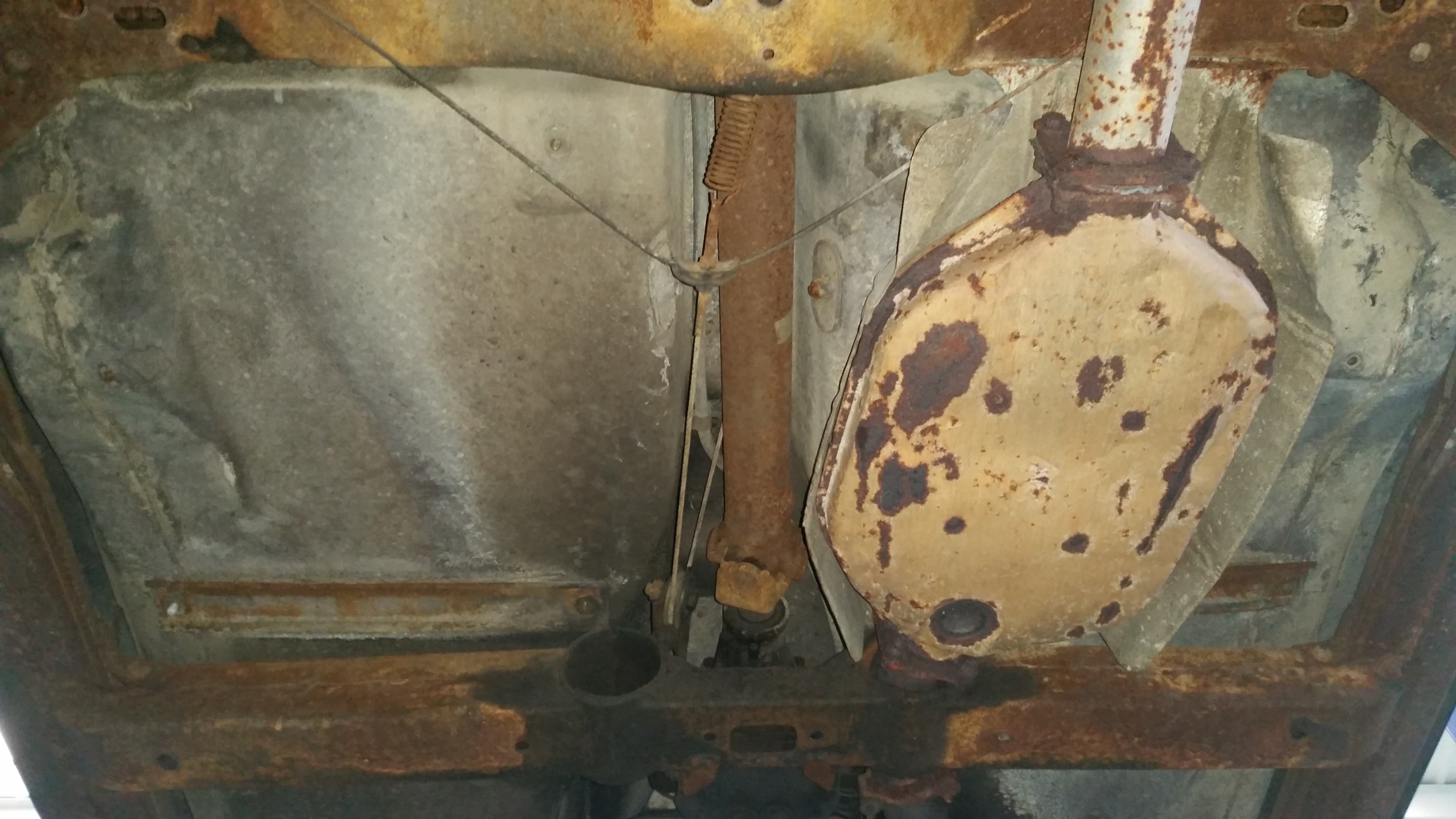

Hello all,
My dad purchased a 1978 C3 in the hopes of doing some 'moderate' wrench turning with me to get her up to speed. The car needed some things that only a shop could do, but the remaining items we felt we could do: (heater core, cap/rotor, interior, engine freshening).
Just to document everything, I had someone take pictures of the underside- very surprised by what I saw. Come to find out that there's a TON of rust on the frame, control arms, and just about everything (see attached pictures).
Given the extent of the rust, is it even worth trying to save this car? What would be involved with something like that?

You need to inspect it a lot closer it may be just surface rust. Next question would be how far are you willing to go, to clean it up right it will need the body removed and all the rubber replaced and anything else that needs repaired.
Could get very expensive.

Hi d,
That really looks like pretty typical rust for a car that's 37 years old.
You should determine the integrity of the certain parts of the frame that are vulnerable to debilitating rust and also look for signs of rust around the windshield frame and hinge pillars on the birdcage.
What you do about the rust visible in the pictures depends on how much work you want to do on the car.
Again, a frame with surface rust and rusty running gear isn't unusual. Many, many, restorations start out looking like your pictures.

The pics you posted show fairly normal surface rust - not pretty, but nothing really structurally weak or unsafe. That doesn't mean it is not bad, you just have to look in the right places. Like Alan & redvetracr said, look at the frame - especially where it kicks up in front of the rear wheels. If that is OK, then the other common problem is in the bird cage (body cab frame). Check out the sticky at the top of the page "ten rules". If you keep on working on this car, one of the first things I would do, would be to change the catalytic converter for a modern version - or remove it if allowed in your area. That old style bead cat is extremely restrictive, and the scrap value for it's platinum will help offset the cost.

I don't see anything in the pictures that makes me think the car is unsafe to drive.
I also DON'T see anything that indicates you shouldn't continue on the course you've described.

As others have said, it looks pretty typical of an old Corvette. The real problem areas for rust, can't be seen in your pictures, so a little further investigation should to be done just to be sure. Looking at the condition of the floors, a common spot for rust on a 76-82, I'd think chances are good, that the car is pretty solid.
Check the ends of the frame at the kick ups, under the rear door jam. Also check the frame at the body mounts, especially around the number 4 mounts, behind the rear tires. A few other places to check are the windshield pillars, where they meet the cowl, the rocker area under the sill plates, and the door hinge pillars, where they meet the rockers. These are all typical Corvette rust areas.

In your post #15, the first two pictures appear to be body mount #1. The cushions are shot, not surprising after 37 years, but the frame and mount area look solid.
The third and forth pics are the #4 mounts. The box on the body, containing the cage nut, is shot. This is pretty common, and not terribly difficult to replace. They're only riveted to the body, and easy enough to replace, for someone with some automotive skills. More importantly, the frame portion of the #4 mounts, look to be in good shape.
I don't see anything of concern in post #16. The brake hoses and trailing arm brake lines, look to be fairly new. Even the rear spring cushions, look to be in good condition, for their age. The rear crossmember cushions are showing some age, but I've seen much worse.
The only thing that might need a closer look, is the condition of the trailing arms. The arms get rusty inside and get weak. In doing an old Corvette over, you really should have the rear wheel bearing assemblies rebuilt, at which time the rebuilder will refinish or replace the arms.
In post #17, I can see that the brake hoses, front sway bar links, radiator hoses, power steering hoses and slave cylinder have all been recently replaced. Obviously, the pan has been dropped and the pan gasket replaced too.
The black spot circled in red, just looks like a clump of grease on the crossmember to me? Even the rear end pinion bushing, looks to be in good shape. Again, the floors look very good, not something you would expect to see in a car that would otherwise have series rust issues.
Pictures lie, and there's no way of knowing how solid the frame is, just from looking at pictures. If you or your mechanic, aren't comfortable checking the frame, than you should get someone more familiar with Corvettes to inspect it. There are plenty of knowledgeable Corvette people around the Country, many on this Forum. Some will look at it for free, as a favor or friend, while others may charge a fee. Either way, if your still not comfortable with what your looking at, then reach out to someone who can inspect it properly for you.
