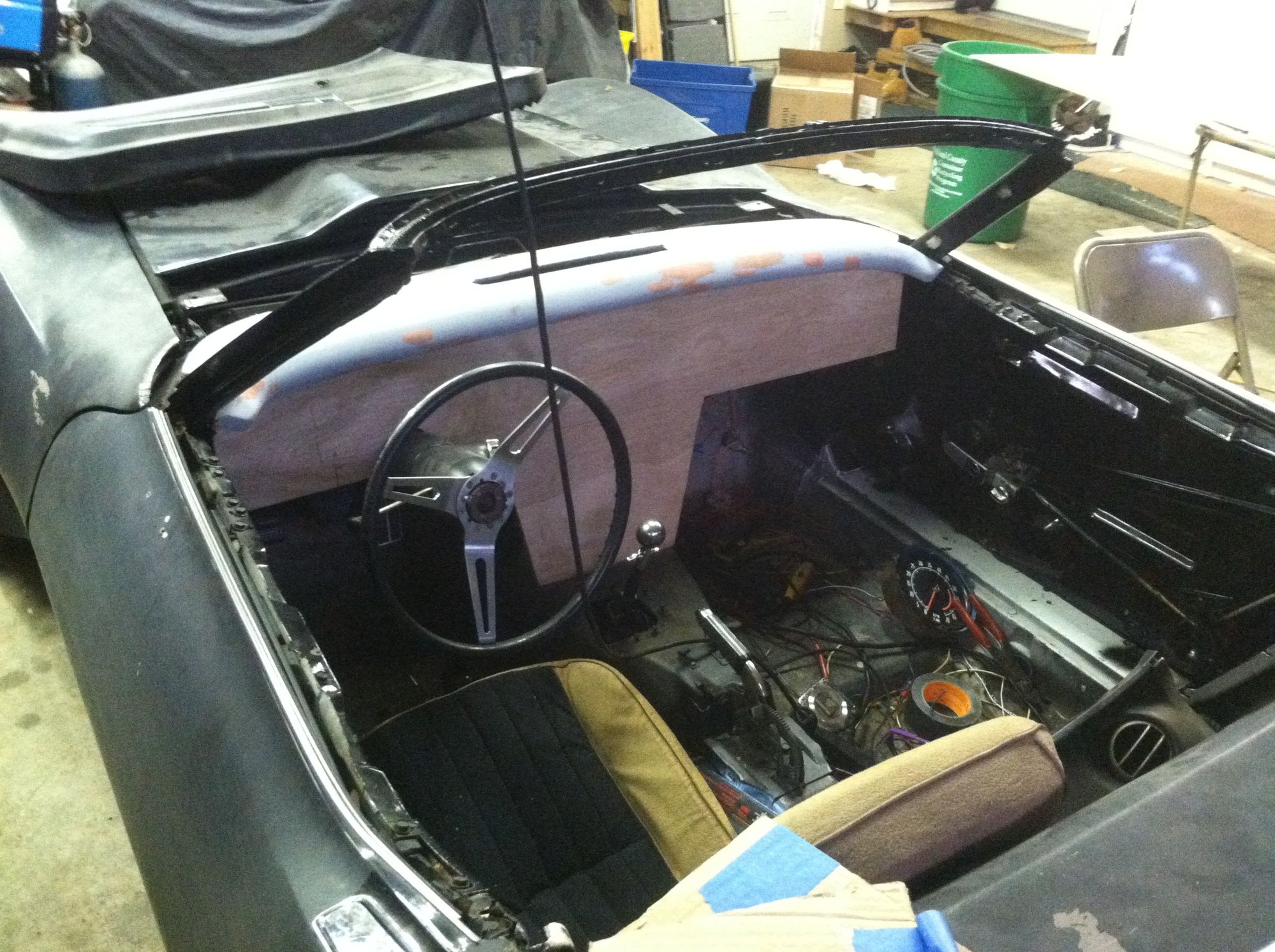

I bought a thin 1/8 plywood like board and jig-sawed i rough shape of what it was going to be

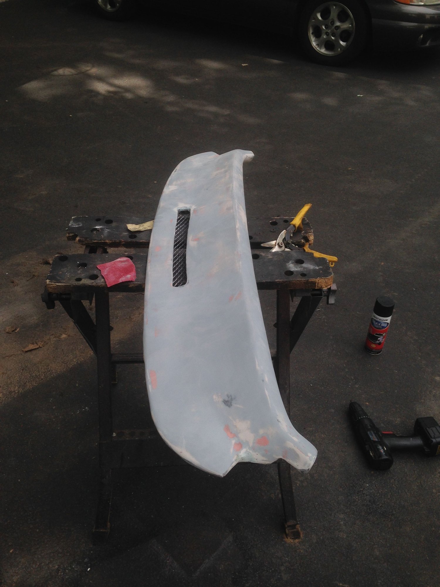

As far as the dash pad went i accidentally ran it over after it fell behind the car and i backed it out
So i restructure it and fiber glassed the whole thing and sculpted it back to the right shape.

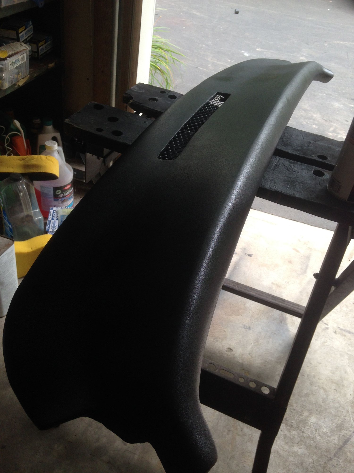

I used a fine textured bed liner to give it a nice texture and look.
I grinded off the underside until it was flat and fiberglassed 90 degree metal brackets and left a channel so i could slip the 1/8 wood into and it would tuck in nicely under

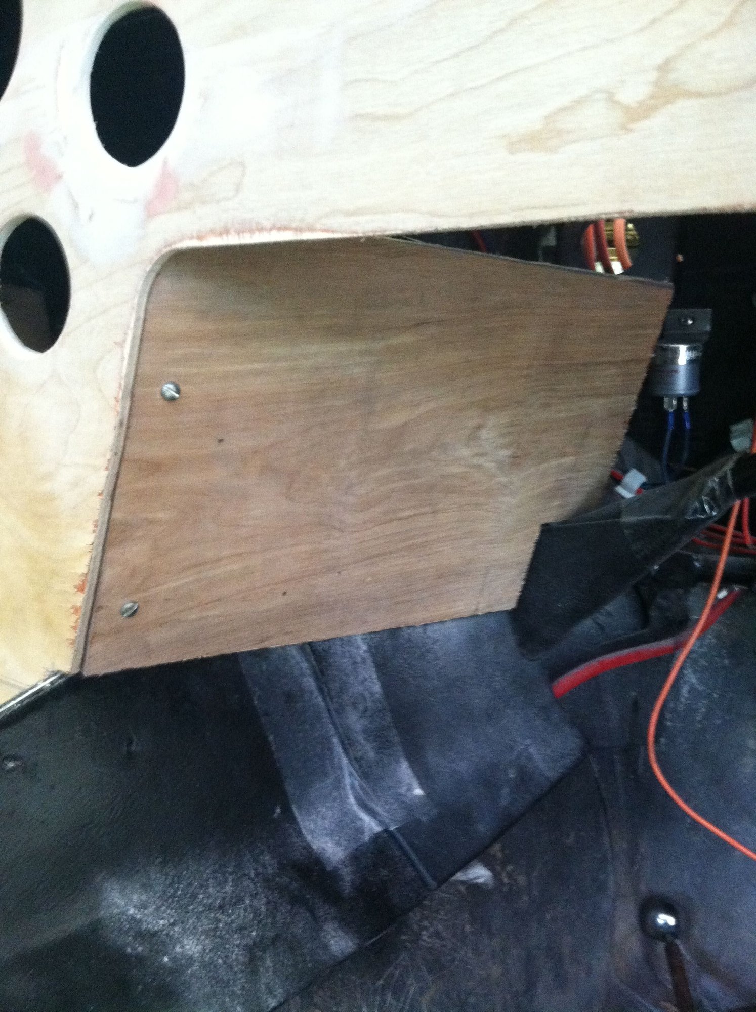

I made these side pieces to finish off the middle and give it a clean look

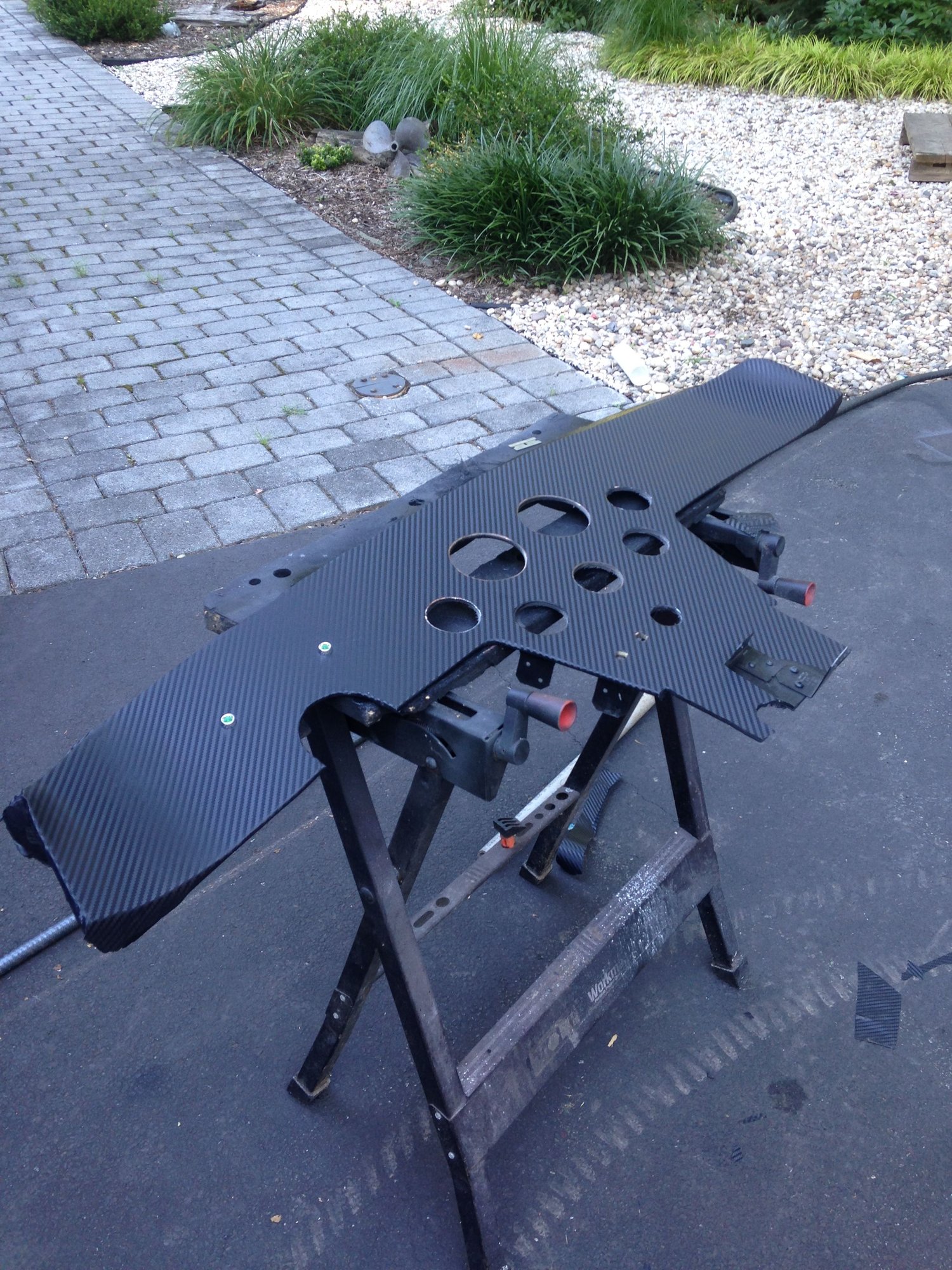

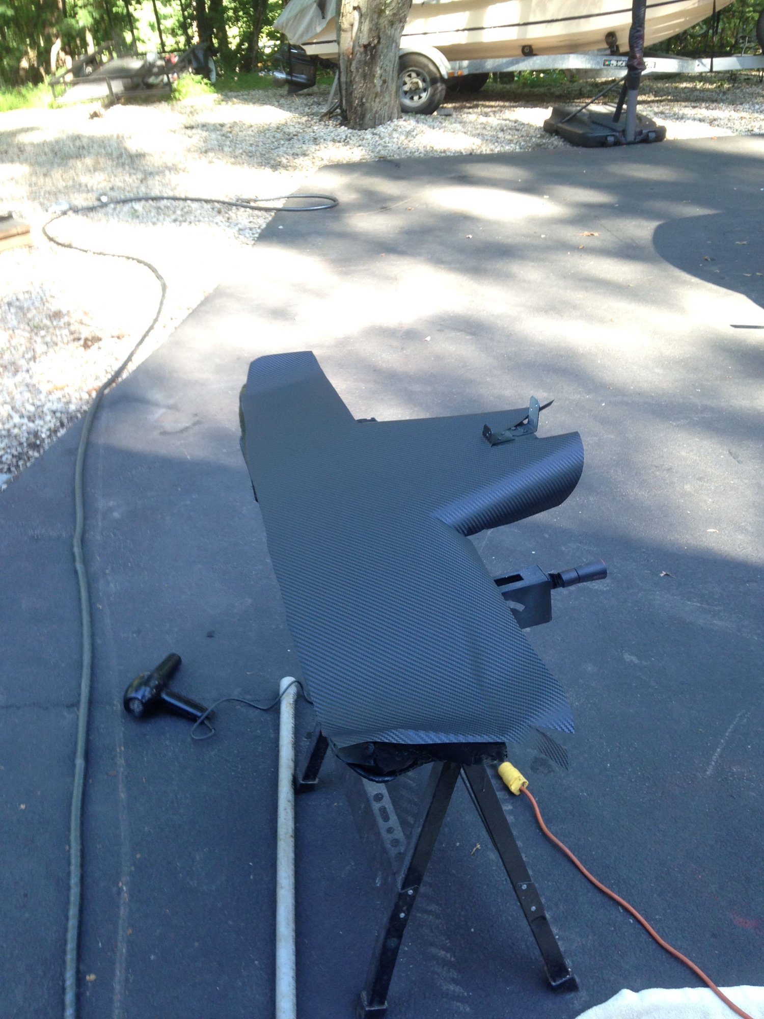

After tons of sanding and filling i vinyl wrapped the dash with carbon fiber.

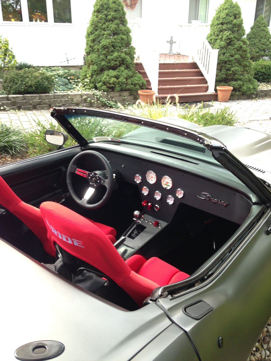

Thanks Everyone! heres two more shots of it 100% done
