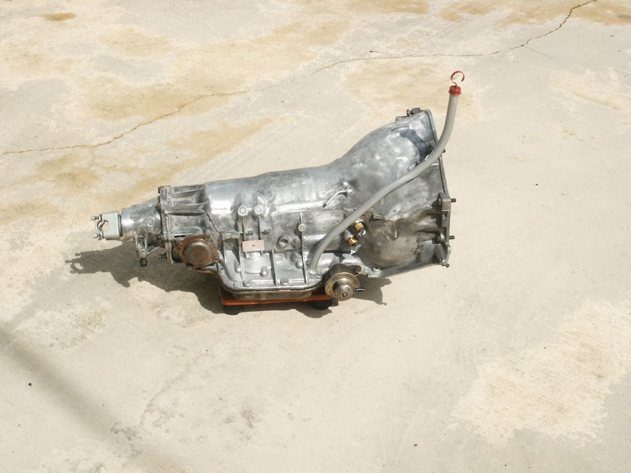

That is a TH400 from a 73 model. The vacuum modulator is on the
side on a TH400.
On the rear facing back on a Th350.
http://www.400raptor.com/TH350-2.jpg
That and the pan shape tells you for sure.
Here is the TH400 from my 73, you can see the modulator on
the side.
Donnie
