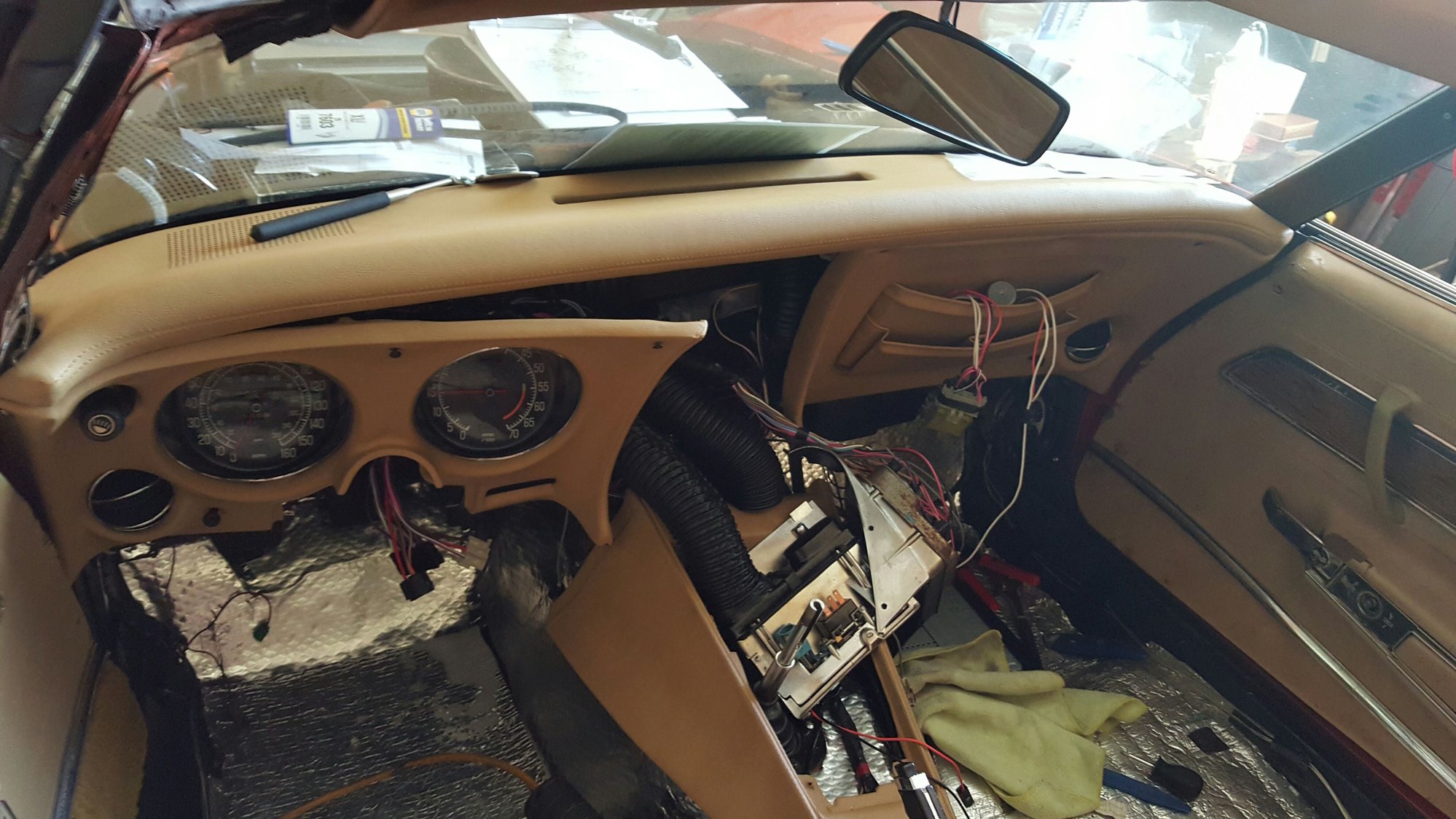

This is what the dash looked like before I attempted to install the center gauge cluster. You really can't see it in the picture but the two ends of the lower dash pads stick out a good 1/4 inch where as the rest is fully under the upper dash pad like it's suppose to be and as I've said prior the left and right pads seem to be wider than the originals since getting the center gauge cluster in has caused me to break the bezel (my fault for getting frustrated over the **** fitment)...

It actually looks like that space at the top, narrows down!

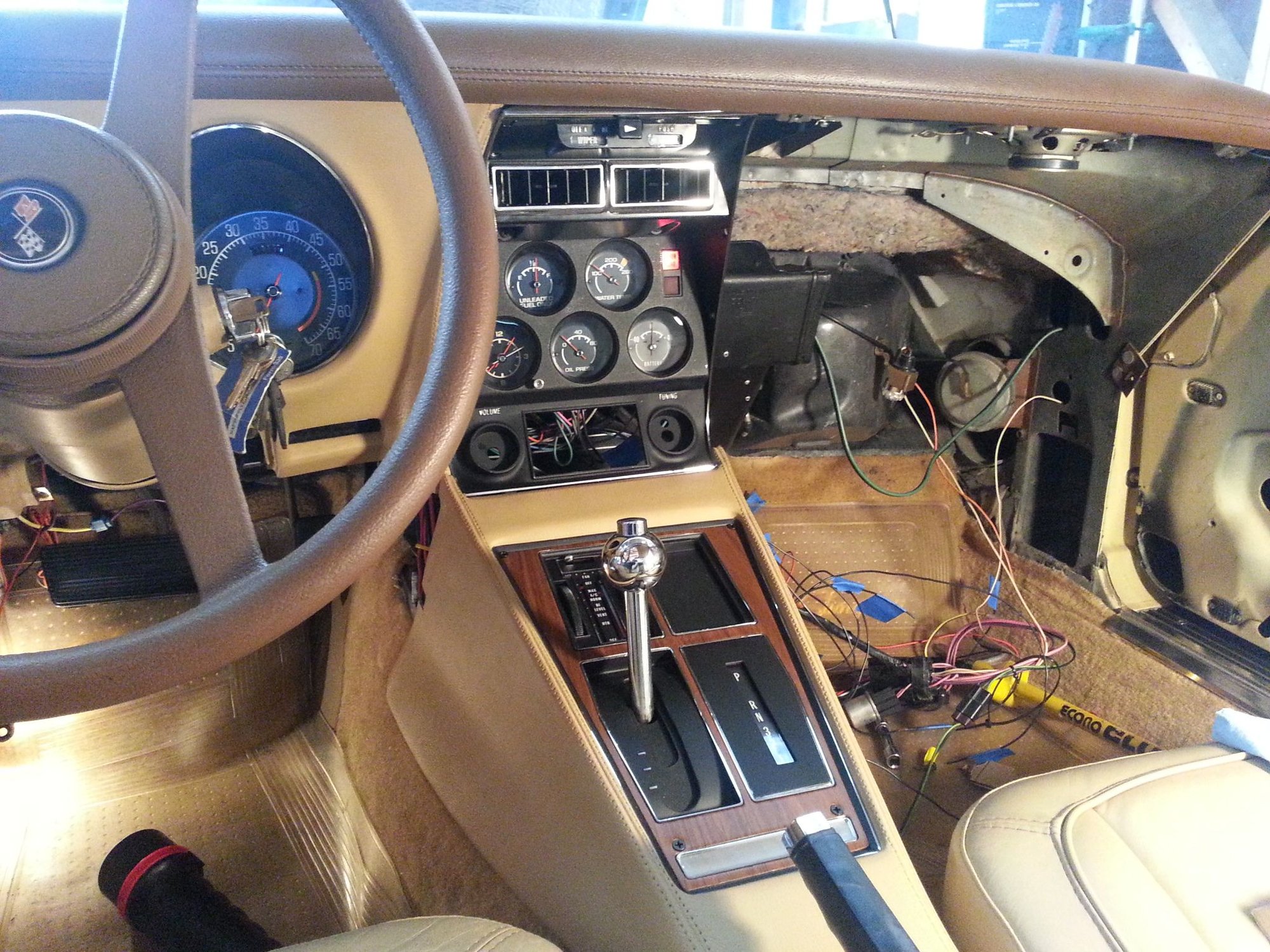

Ha, you are not the only one...
Notice the cockeyed top of the gage cluster...
At least when i broke the dash it was the old one...
