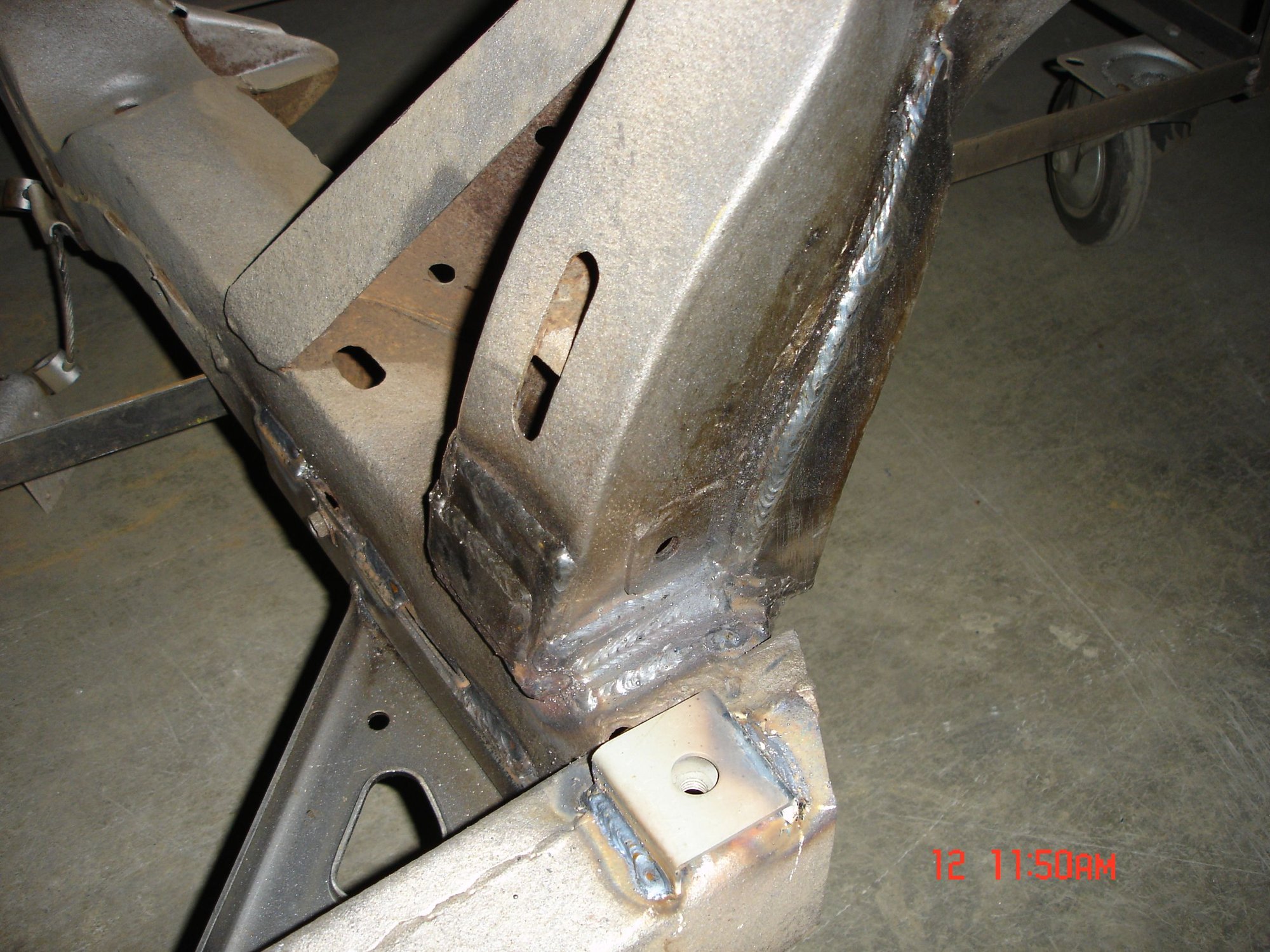

Hi Wes, here is a picture of the rear section of a 69 frame.
the angled gussets and the upkick pieces came from Zip.
Robert
Thanks Through the help of great forum members like yourself I found that the 68 frame has an extra length and hole just in front of the place where the front sway bar mounts and no brace where you showed in the rear picture . Since Zipp makes the exact pieces to repair my rusted places I will attempt to repair my original frame since it came with the 68 L 88 I JUST GOT .Wish I could weld like you but my Dad was a wood guy and not many wood pieces on a Corvette .
