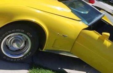

A manual on/off switch for a turbo? Secure exhaust cutout actuator?
Seriously though, I can't figure out why there would be a lock on the front fender of this car.

That is to activate and de activate the alarm system, if it is still hooked up.

It's not a lock, it's an electrical switch that's turned on and off with the key and is, as said earlier, for the alarm. Did you get an owner's manual with the car? If not, they are available very reasonably from all the vendors. There are other switches and vacuum components that it would be good to know should you need them.

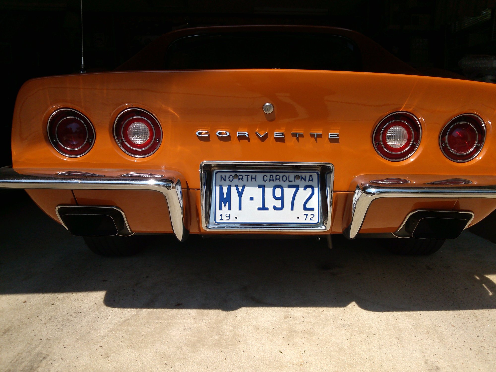

73 and earlier it is on the center of the rear panel between the tail lights. When they went with the rubber rear bumper in 74 they moved the key to the drivers front fender.

In case you see one, here's where it's located on the bumper cars:
