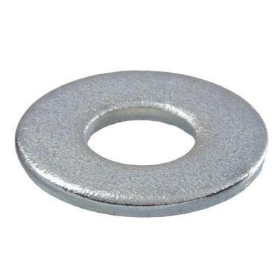

is this a headlight washer?

No, that's a tail light washer.
This is a headlight washer.
Regards,
Alan
