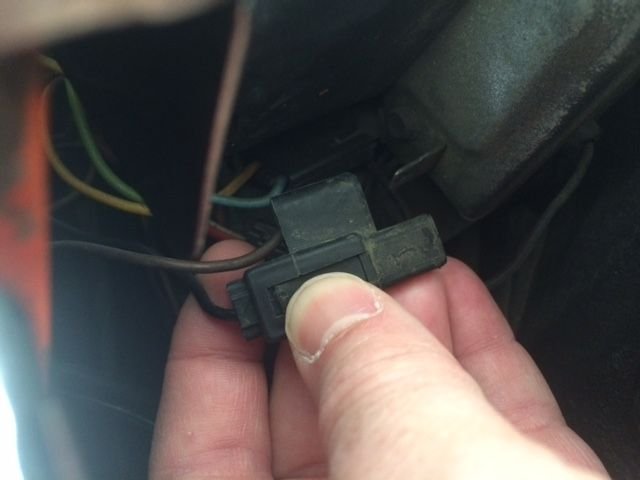

What's this plug for? I assume it plugs into the nearby single spade next to it?

Cant see it clear in the pic. How many wires and what colors? What year C3?

1972. It's a brown and a black wire. Here's another photo.

Hi mss,
It's the ground wire for the hood's alarm switch and w/s washer.
It connects to the spade terminal on the upper right corner of the wiper motor.

Thanks that explain it. Since my alarm is disconnected and I've never tried to use my washer, I guess I don't really need it connected.
