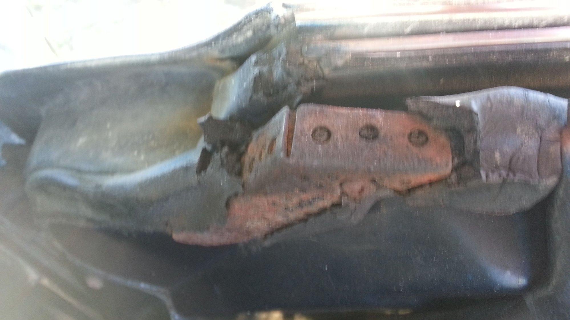

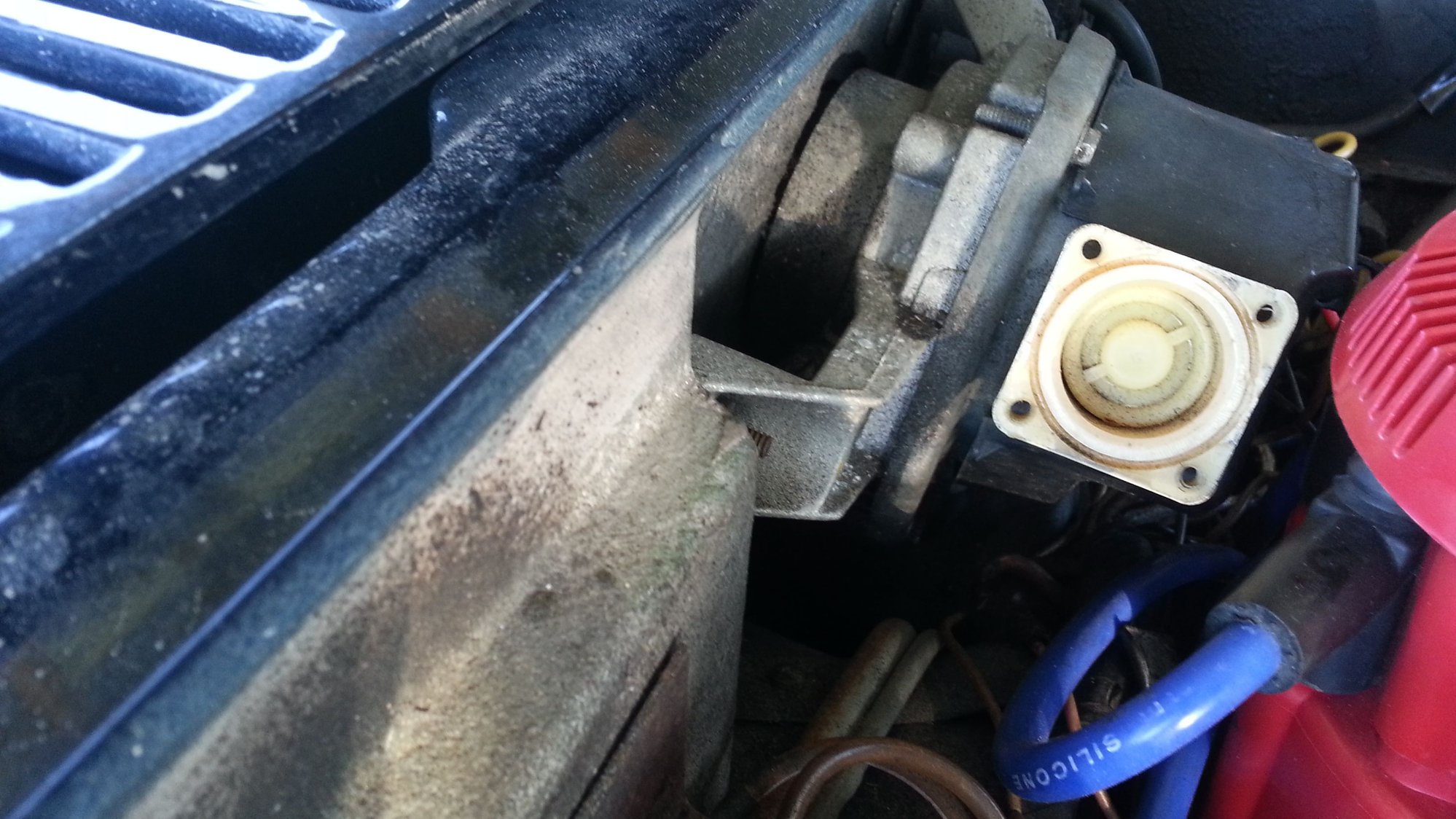

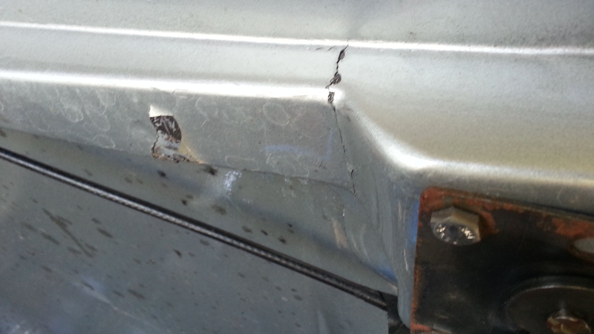

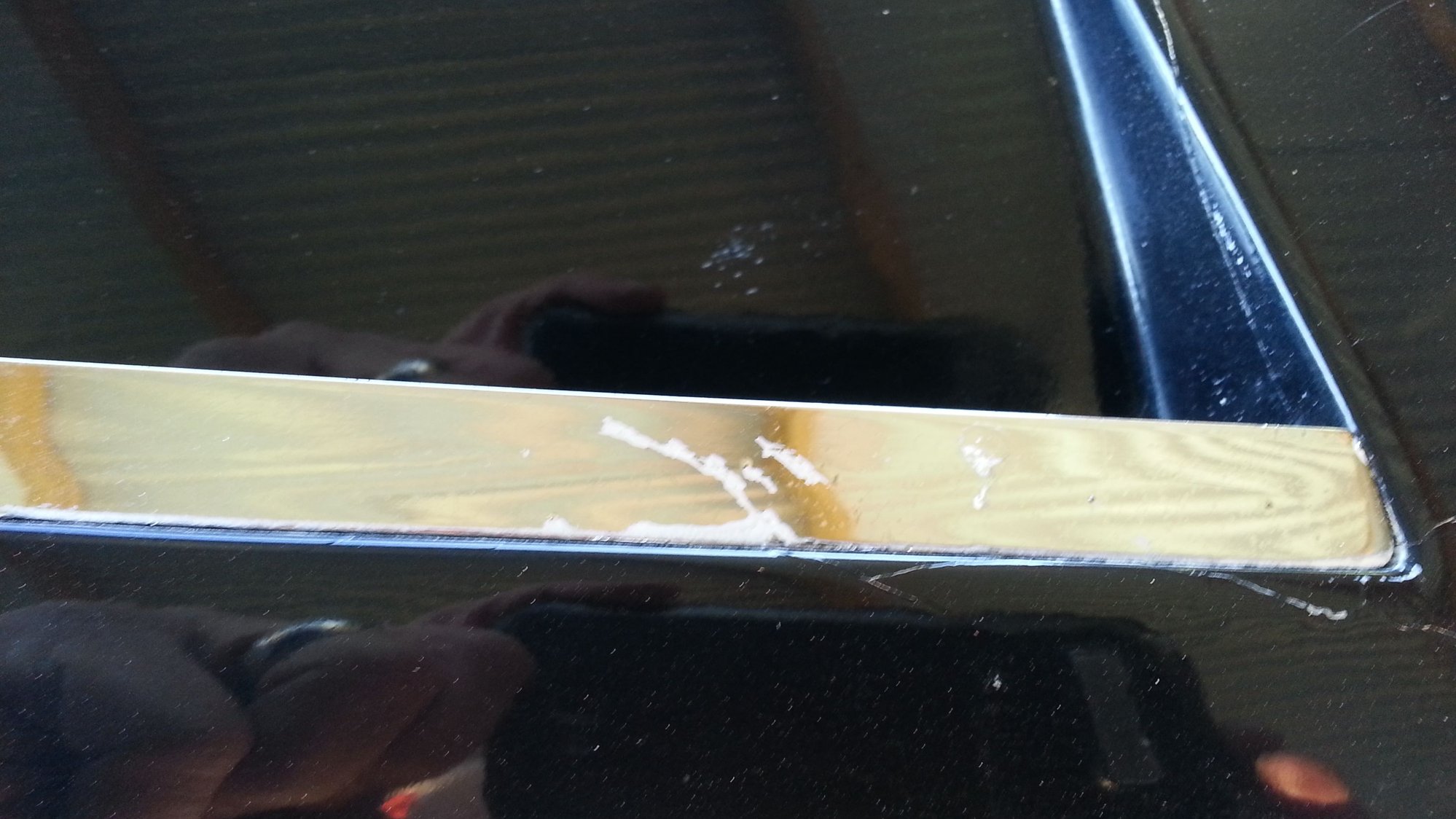

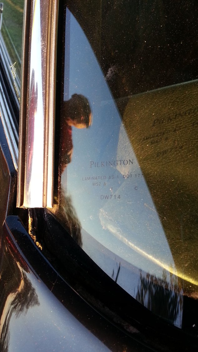

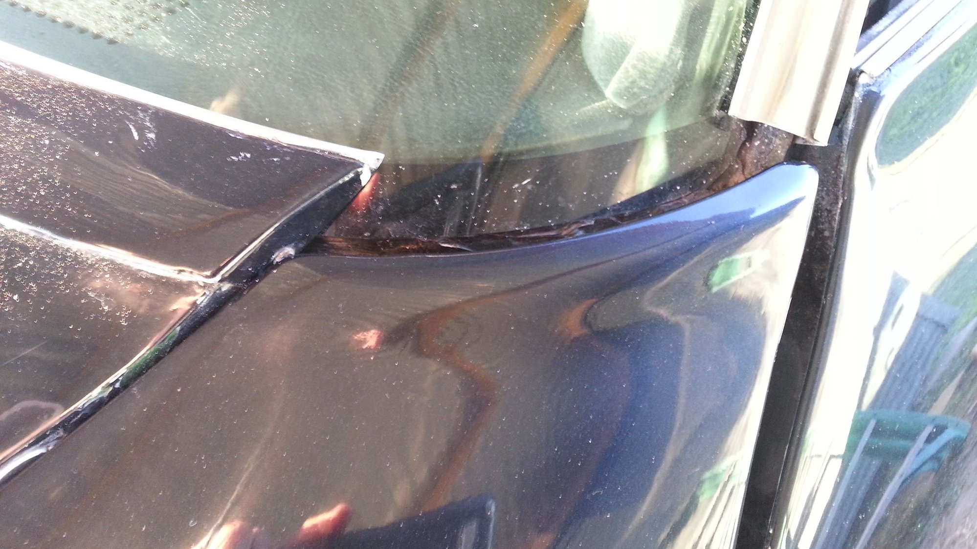

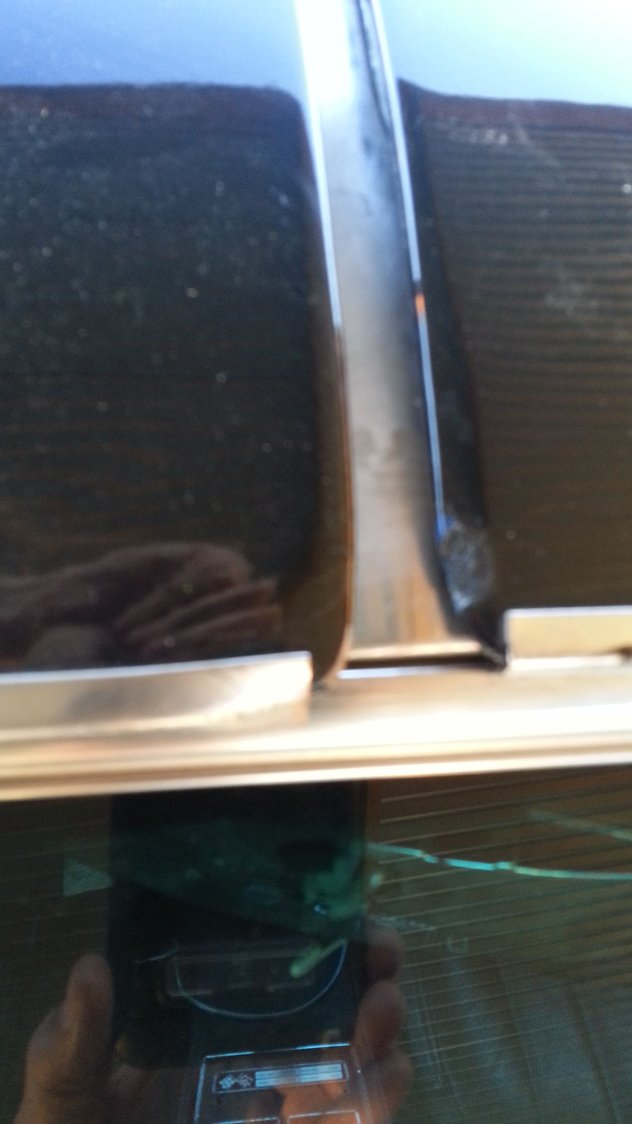

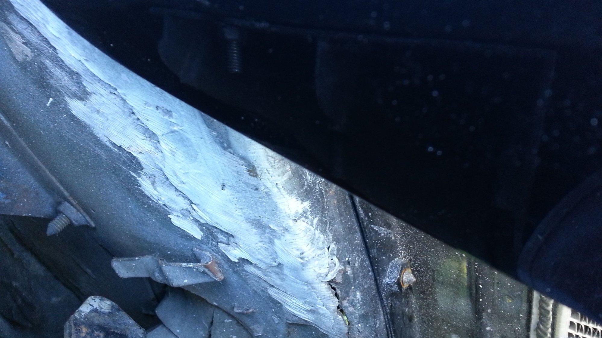

OK. I went and looked it over. I drove it a bit as well. It drove OK. I was on an old country road and it was pleasantly smooth. There was some play in the steering but not too bad. I'm really not sure how tight it should be. I'm coming for a C6 Z06 so it isn't anywhere near the same. The power wasn't instant but I felt the torque come on a few seconds. Supposed to have new brakes but they pulled really bad to the left. I just researched the car and it is NOT an original 454. It was a base 350. It was originally green. The engine is from either a 75 or 78 truck. It has been rebuilt with a 280 comp cam, 10:1 compression, .30 over. Torker aluminum intake and Holley 750 CFM carb. Supposed to be a M22 tranny. The frame looked good. I slid up under it. I couldn't get a lot of pictures. I couldn't remove the drivers side kick panel. The other side came off fairly easy. Just some surface rust. The owner allowed me to take anything apart I wanted to. He was curious like me. He just got the car in a trade. He has a 67 Chevelle that he traded for this car and some ca$h. After driving it once he felt it was too much for him. Now for the bad:

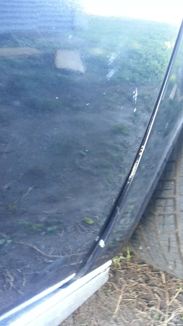

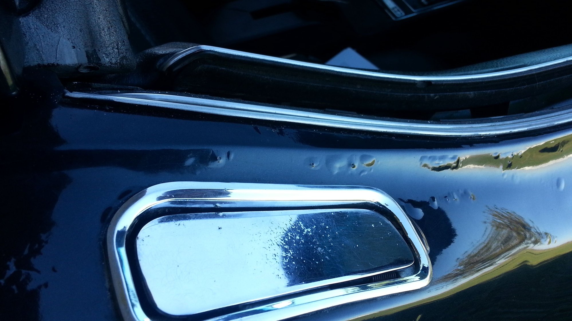

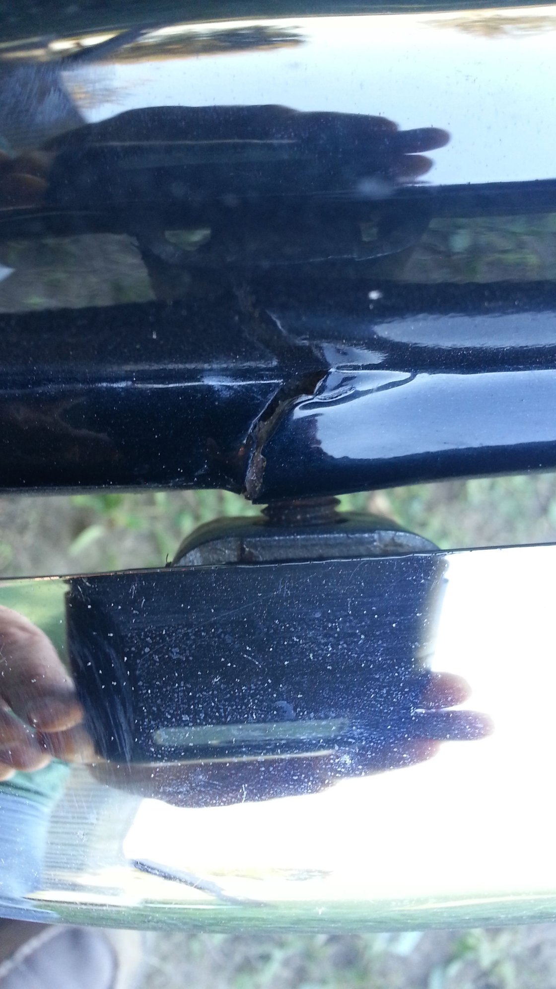

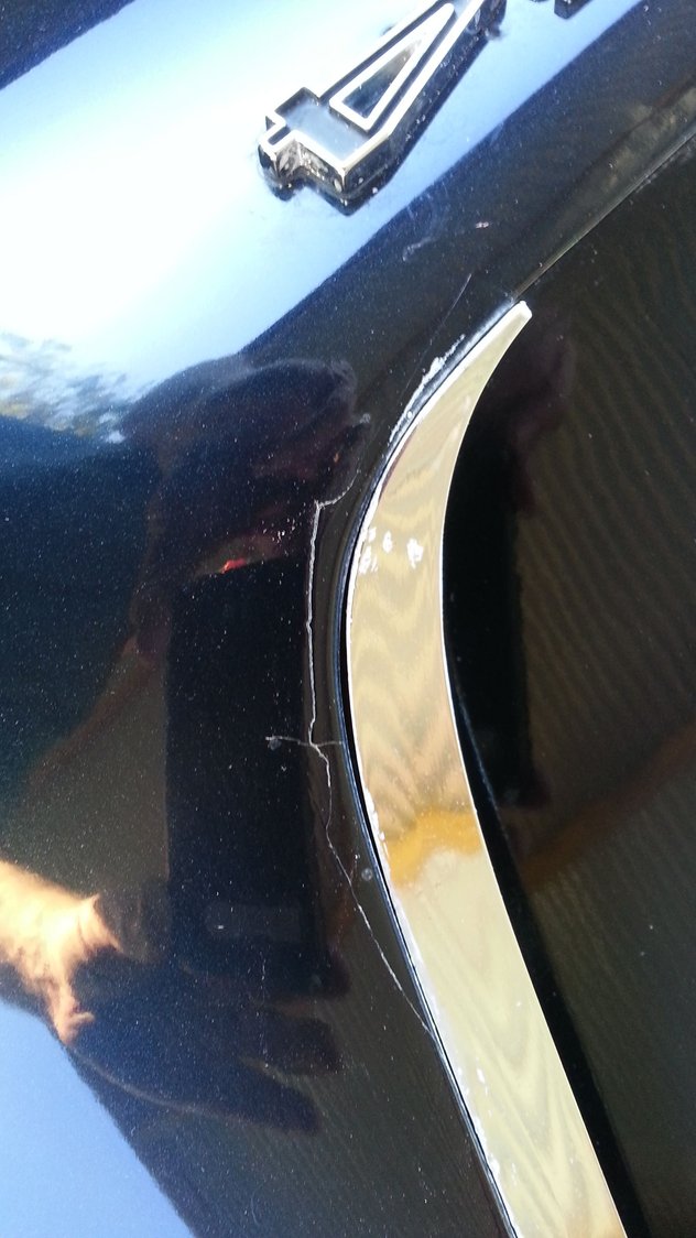

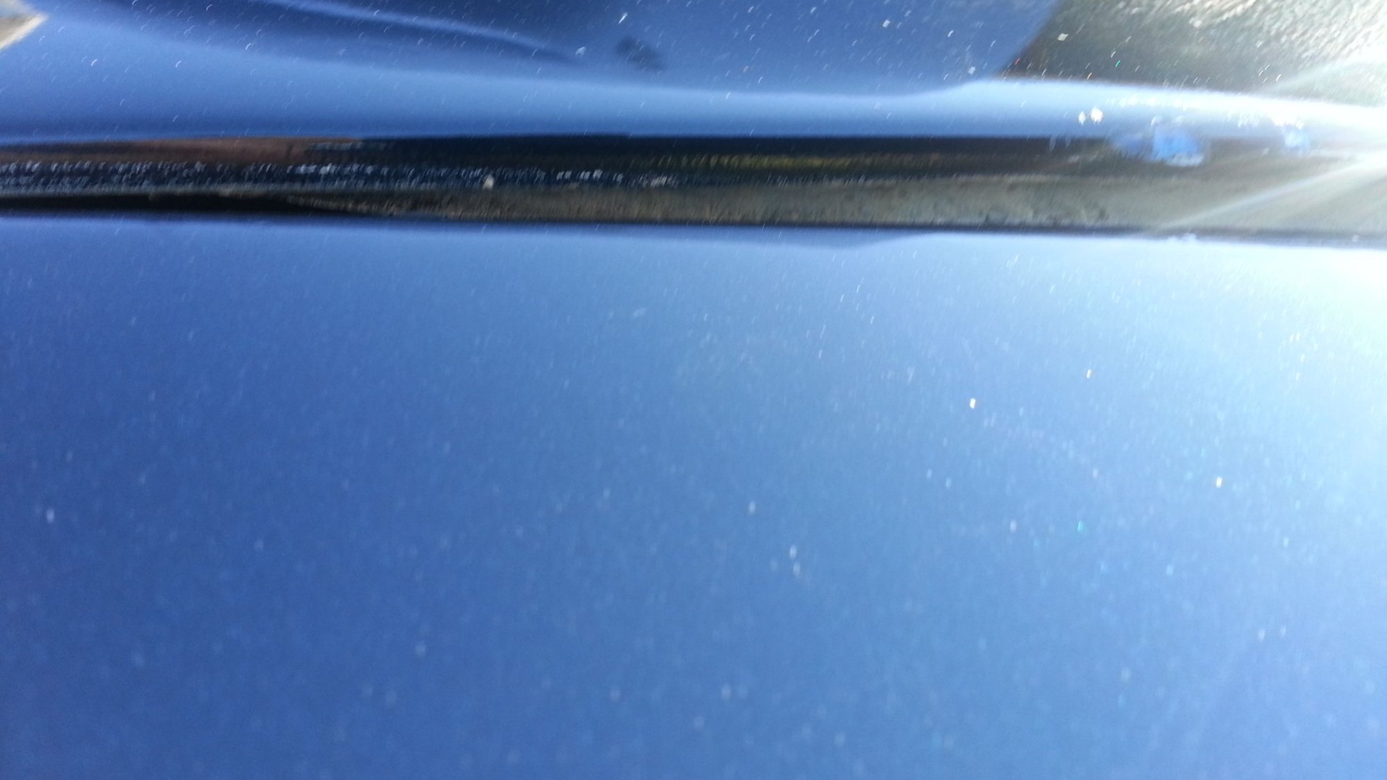

The paint SUX. It is bubbled all over and there are several runs. Definitely an amateur job. I didn't see too many cracks. I photoed all I could find. The door fit was not too good. Gaps were large in placed and very small in others. The rocker panels had the wrong screws and they were only so-so. The head light alignment wasn't great and the fiberglass on the front clip right above the lights looked like it was separating. The door handles were pitted pretty bad. It looks like some work was done to the inner fender right in front of the right wheel.

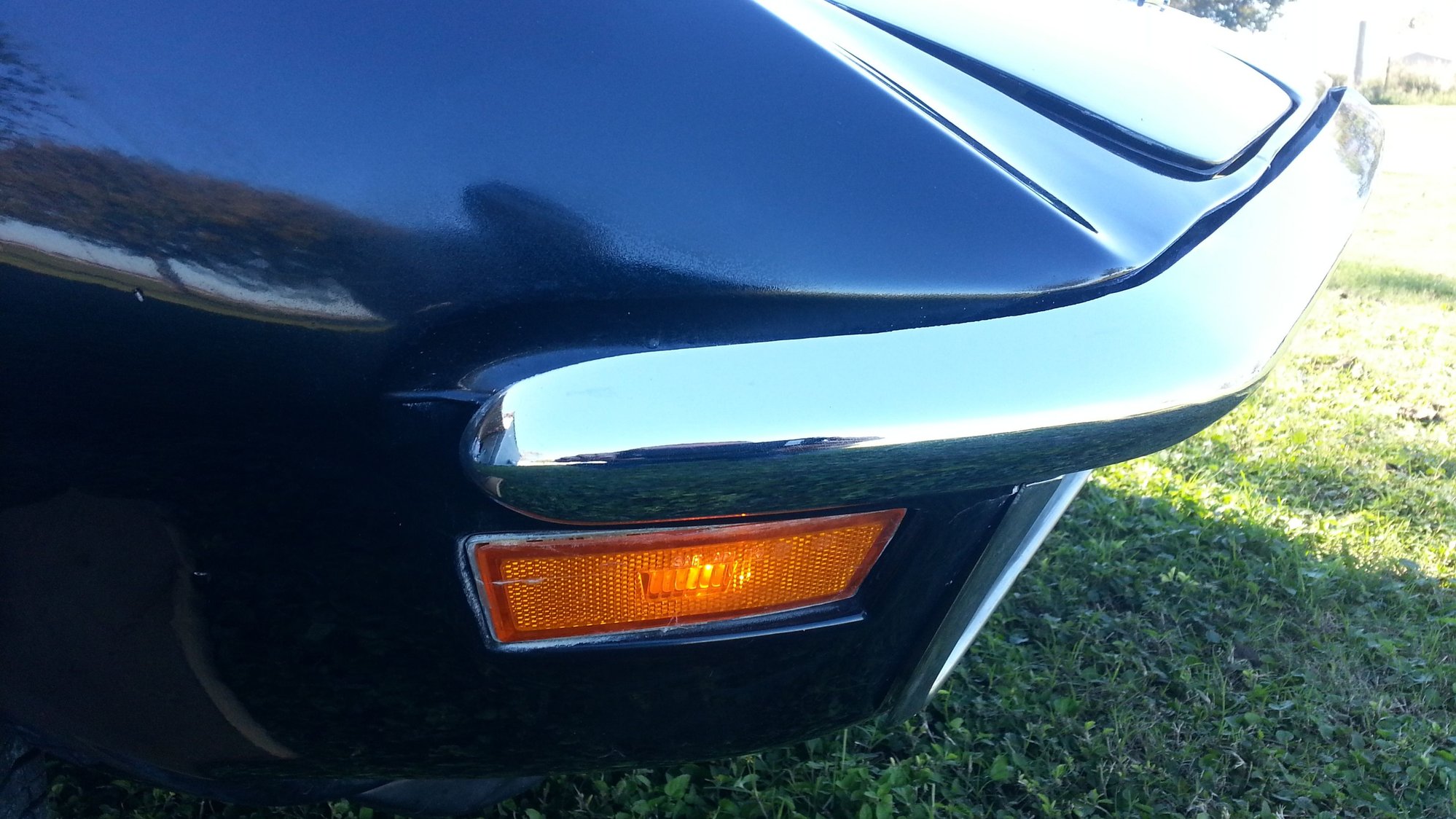

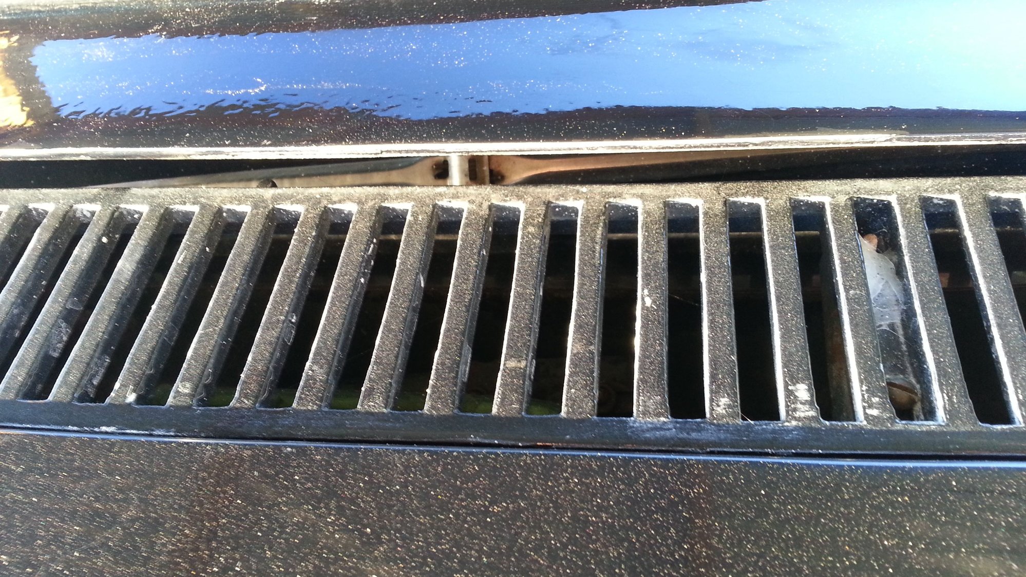

The hood alignment is not too good. The grill behind right front wheel only held on with 1 screw plus the one on the bottom. There is a chip in the body below it.

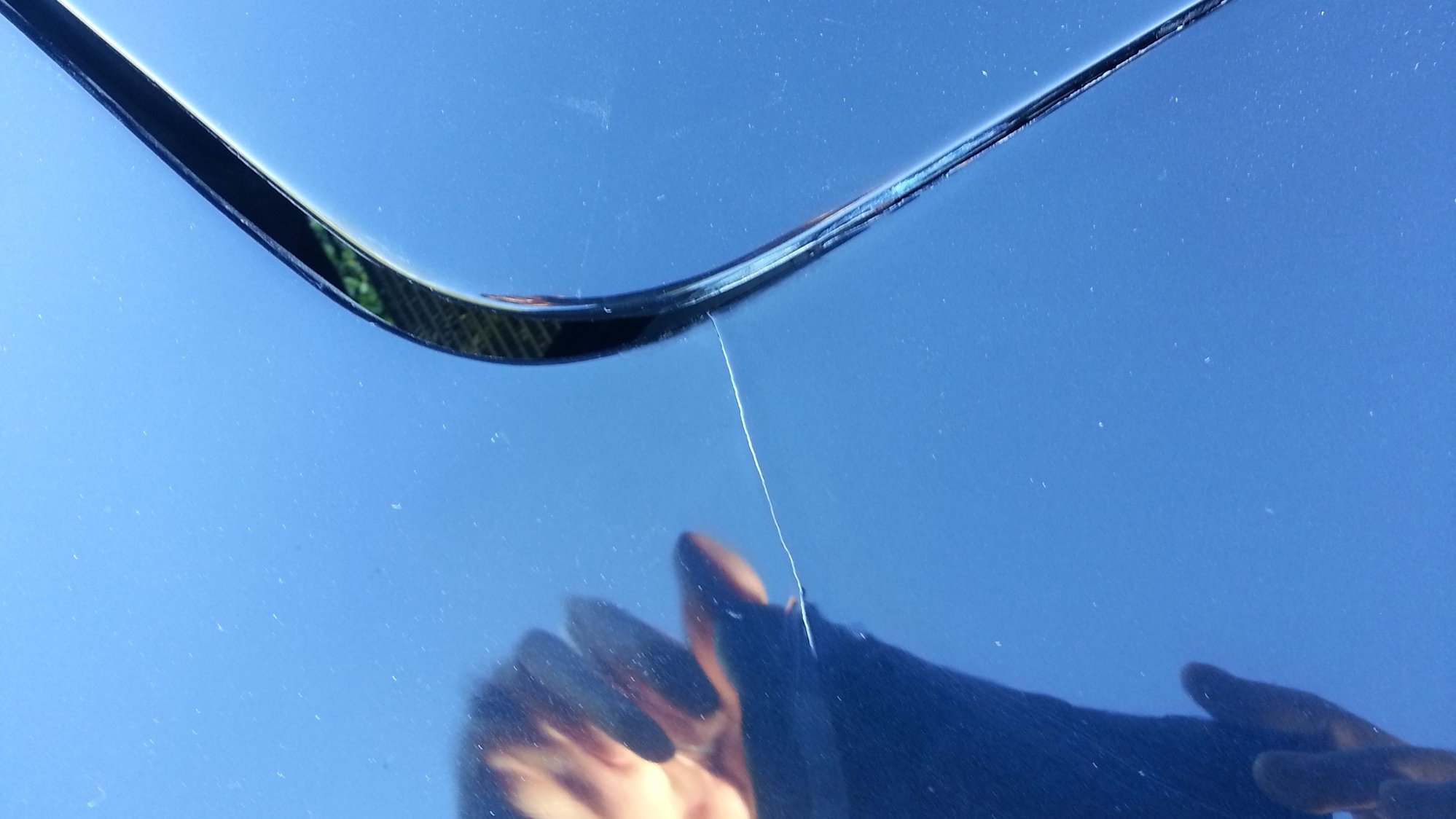

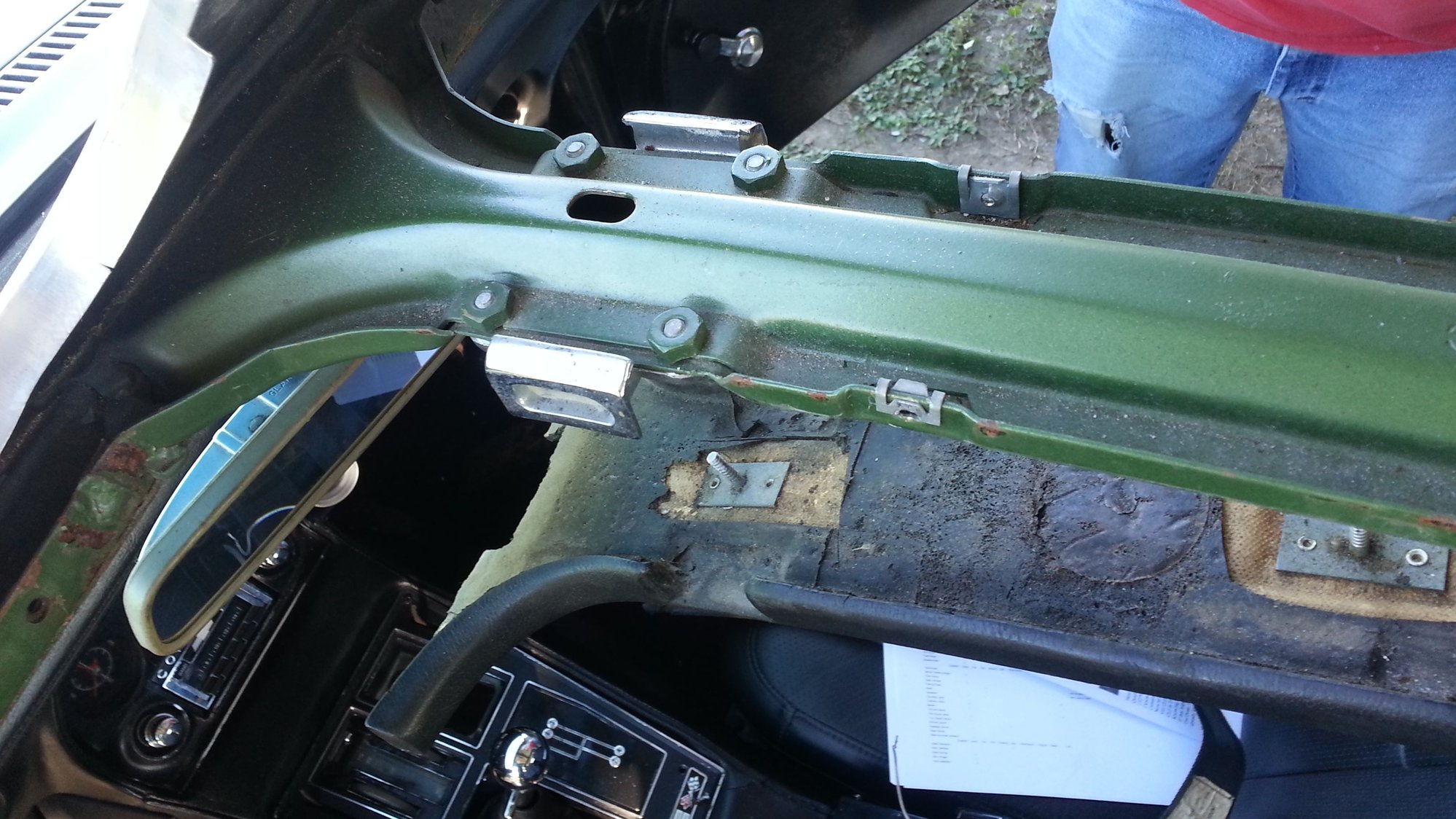

The hood has some cracks on the underside and a spider web crack in the center where the bolt in the breather kept poking it. There is a quarter inch hole on the underside. The passenger windshield pillar has had it. But there wasn't a lot of rust on the frame itself??

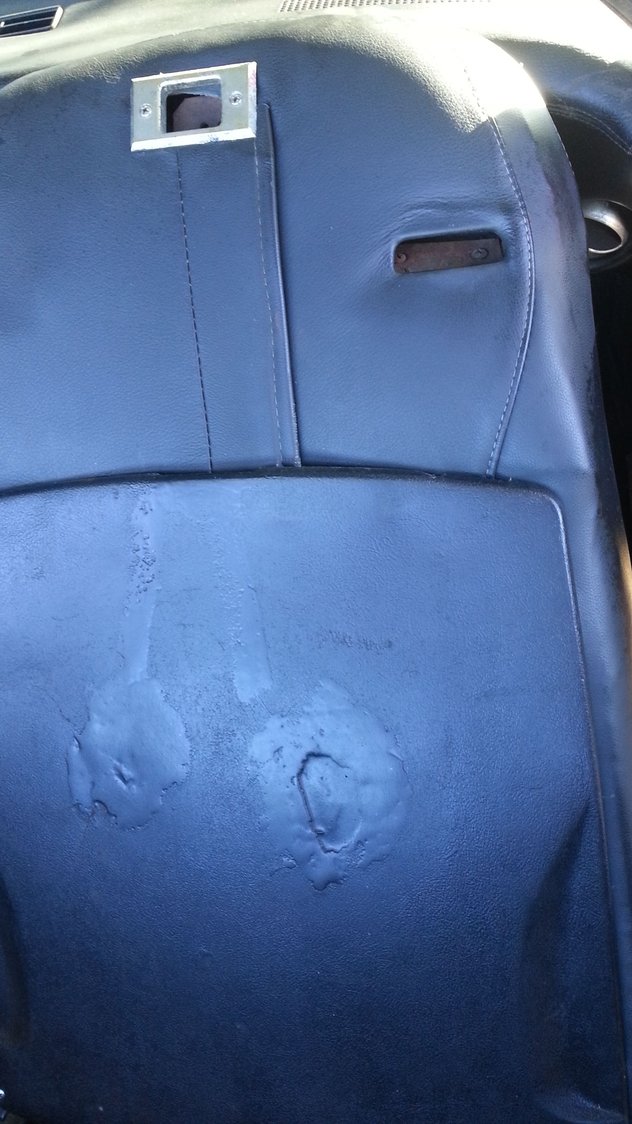

Both consoles were trash. The shifter plate has onlt 2 screws holding it in. The seats were Ok. The backs weren't. The T-tops were so so. The corner of one looks like it might have been dropped. The stainless trim was bent slightly. The fender trim pieces right below the a pillars are missing.

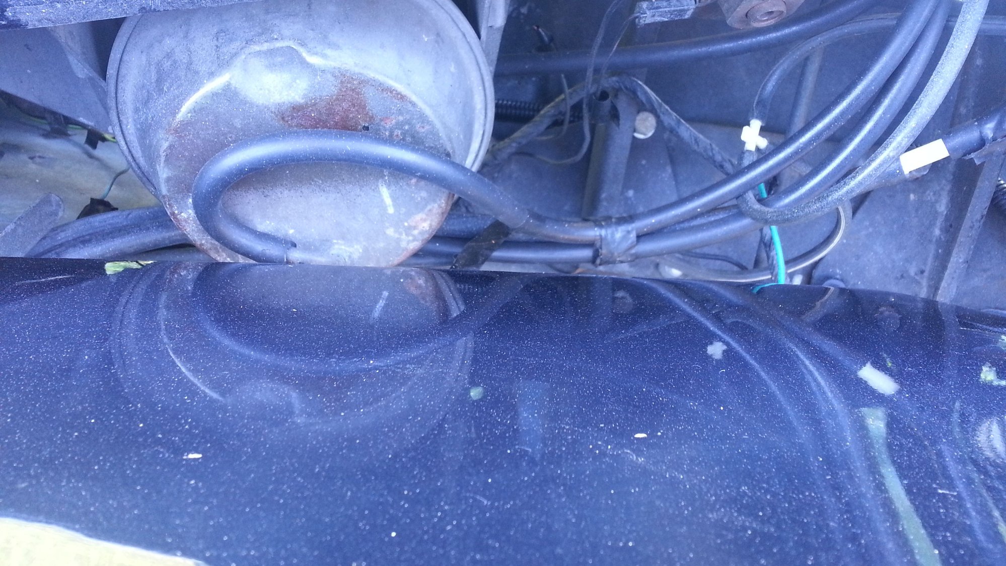

The fuel lines will have to be replaced. They are mixed rubber and metal. They go through the right rear wheel well.

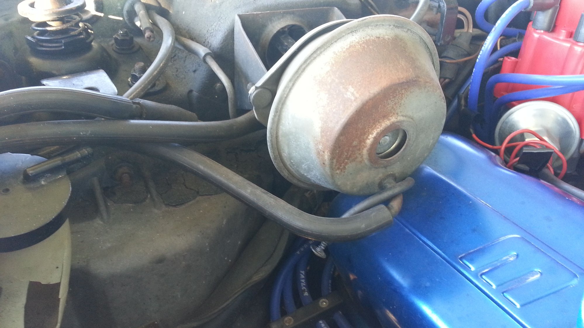

Vacuum does not work at all. Lights do not raise, wiper door does not open. The wipers do not work at all. The switch feels broken. The speedo doesn't work. Obviously the tach doesn't. The water temp and clock don't. The trim around the rear cargo (battery) box needs replacing. The dash is good, no cracks and wasn't too hard. I pressed down on it pretty hard with my thumb and it didn't seem brittle.
The rear suspension needs some attention. Bushings etc. are cracking. The front was re-done and looks OK.
Here goes all of the pictures I took. Actually I took more but my phone was flaking out and didn't take some.
I told him I had another BB car to look at near Dallas and that the asking price of it was $15000. I even printed out the ad and showed him. I told him that I can't do over that and that I wasn't even offering that now, just that I would NOT pay more. He seemed OK with that. I told him I'd have to do some research and think about it before I made an offer or if I would make an offer..
