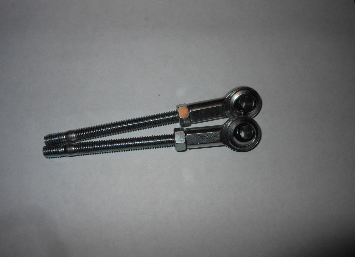

FWIW- As I posted before- you have to hack up the headlight assembly bracket compromising it structure- versus elongated a 1/2 drill hole.
Copycateyes-
Our idea-
And you have to take apart the clevis pin- by removing the springs versus just screw in the 5/16-18 into the factory clevis-
5/16-18 ends - same size as OEM Clevis
No disassembly required... screws right in the clevis....

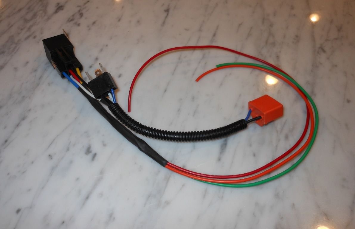

Outboard box and electrical tape?
Shrink tubing and plastic covering-one universal-easy to find and replace Bosch type relay-
His-
Ours-

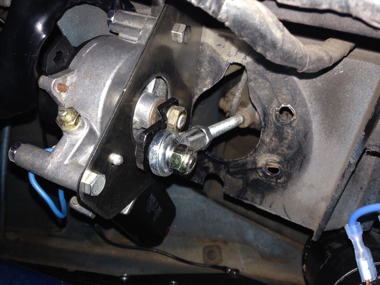

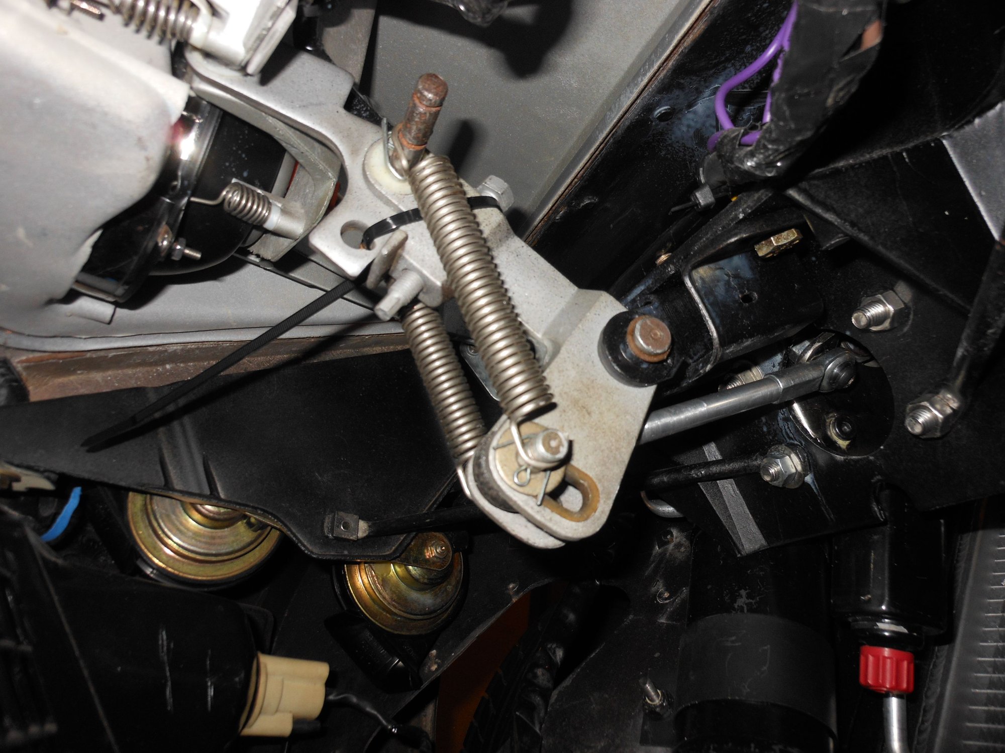

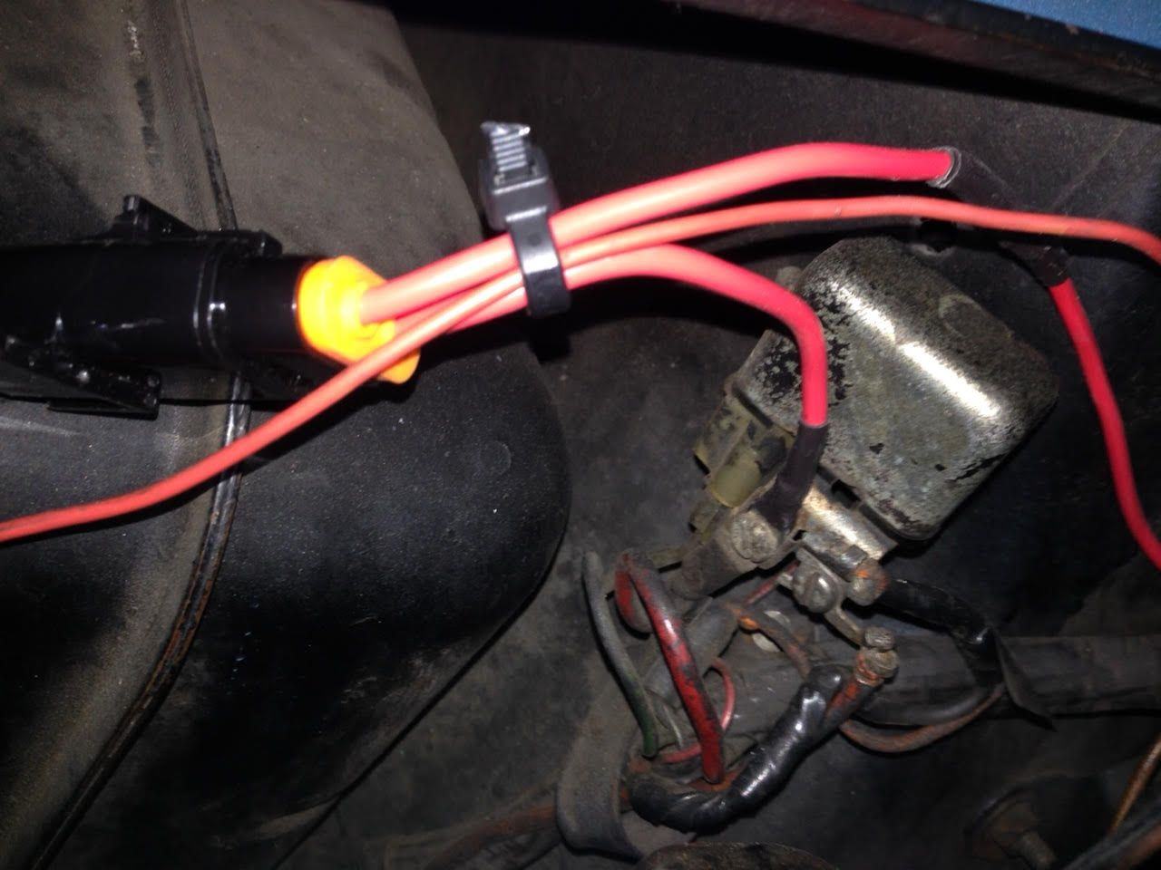

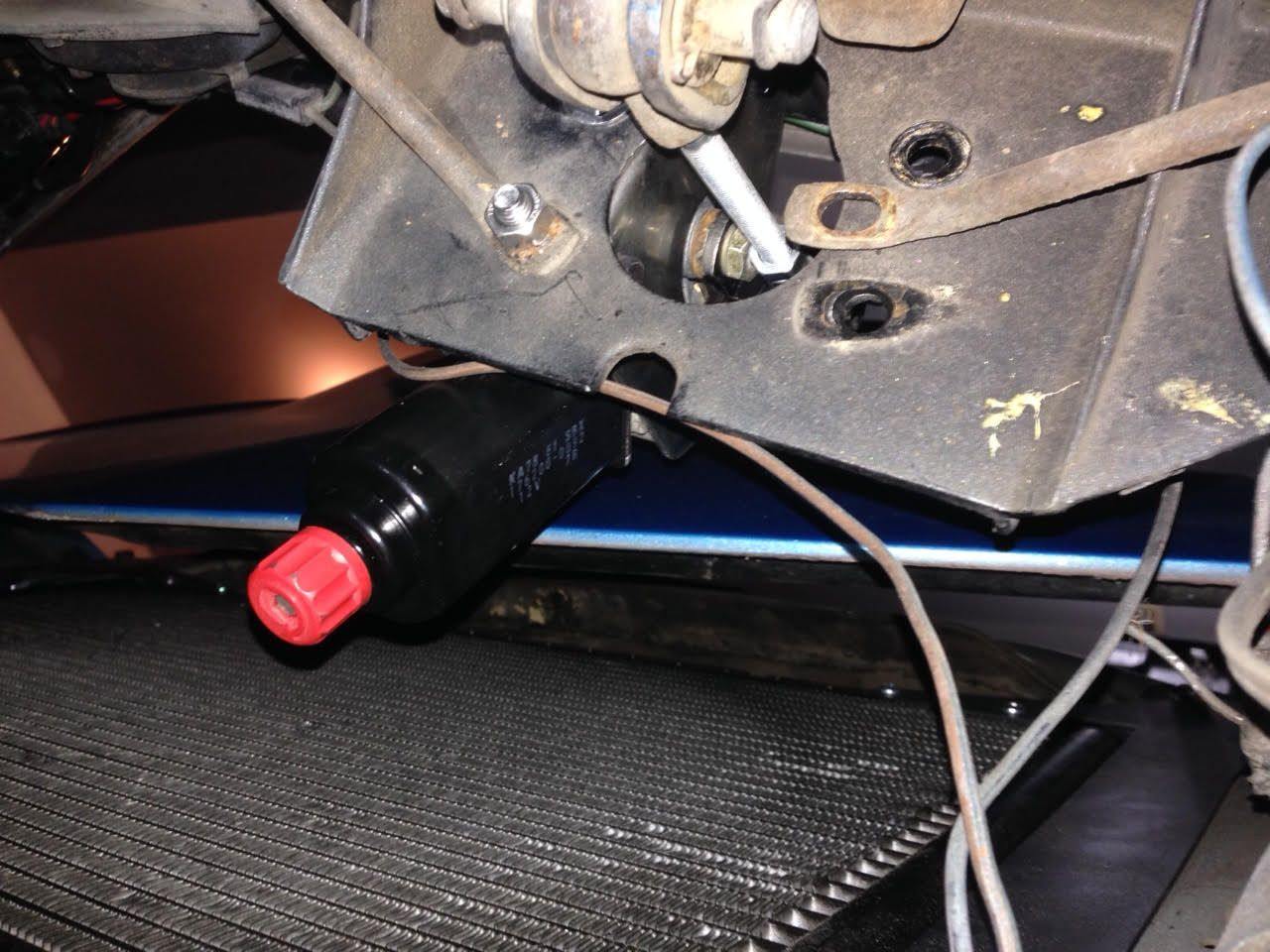

This thread inspired me to try out Richards setup in leiu of a more expensive off-the shelf kit and I couldn't be happier. I had a lazy headlight and am getting ready for an engine swap so the timing couldn't have been better. Thankfully I was able to get everything pre-wired from Richard which made the install a snap. Overall time involved was less than 5 hours, which included removing the hood and removing/plugging the old vac lines. If I did it again I am sure I could get it done in less than 4 hours.
The only issue I ran into was that one of my clevis was bent a little which required the slot to be filed out a little more...keep in mind this was not an issue with the kit, but specific to my car. I will also be keeping the support struts and you can see in one of the pics where it is hanging loose. Just added a bolt and the bracket keeps all its rigidity.
For those of you that want to get rid of your vacuum headlights this is the way to go. The headlights are fast, set up is easy, and the final product is clean.
Mounted motors to inside so there was more space from the radiator
Backside with support bracket hanging...honestly think you could just remove, but I liked the idea of more support
Power from horn relay with fuse. Will secure the fuse once I remove the vacuum canister (post engine swap)
Driver side with bent clevis. You can see enlarged space. I did a crappy job and this will teach you to use a punch before you drill so the bit doesn't walk
