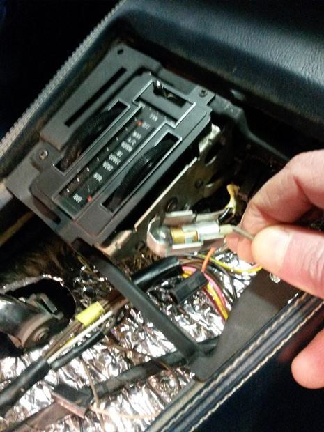

Hello,
After interior overall dismantling and complete coverage with Dynamat and reflectix, I'm mounting back everything and I can't find where this little light fits ????
Any idee ?
Thanks!

Hi p,
That's the light socket for the cigarette lighter.
It clips to the side of the element's housing.
Regards,
Alan

Great ! thank you Alan, that is crystal clear :-)
