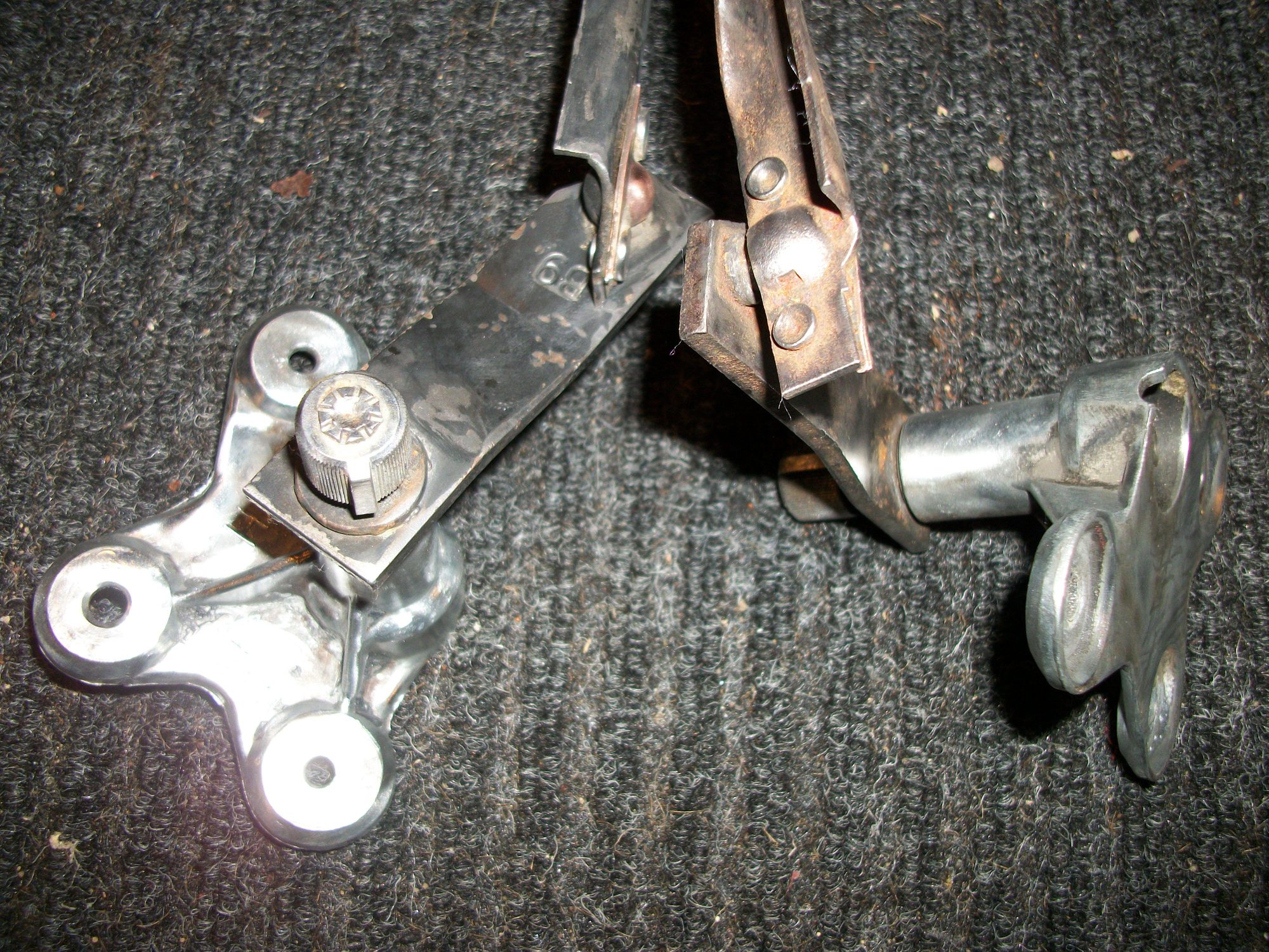

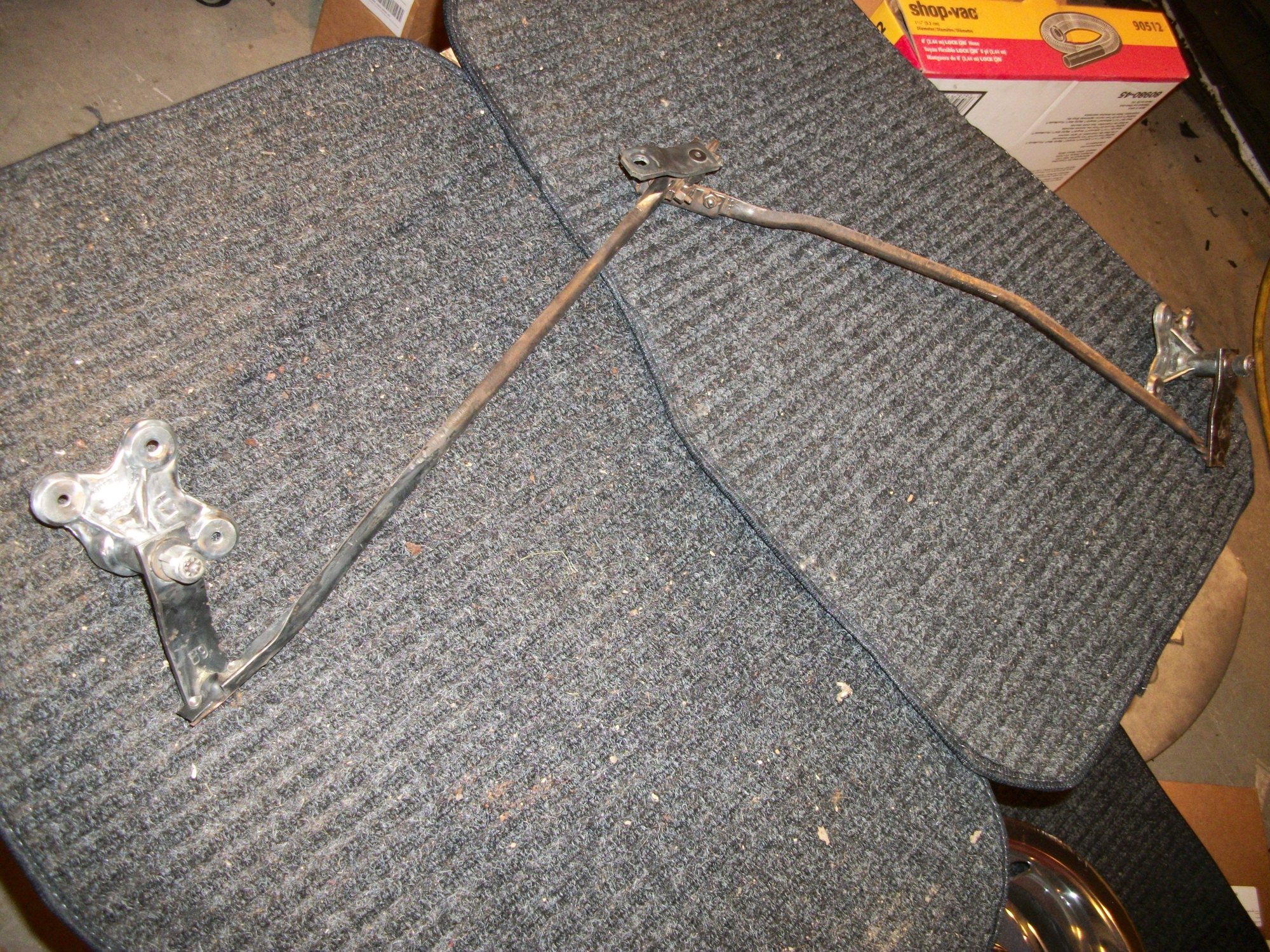

these are out of a 79

Doesn't look like much changed from 71 to 79
