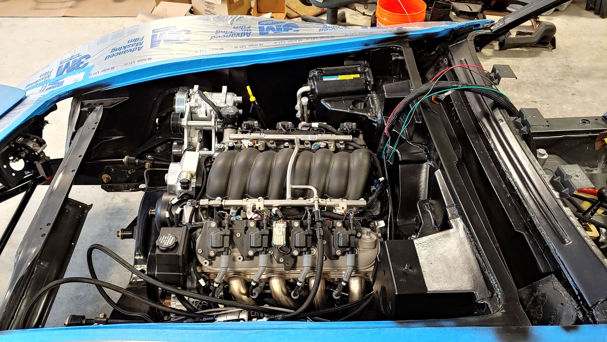

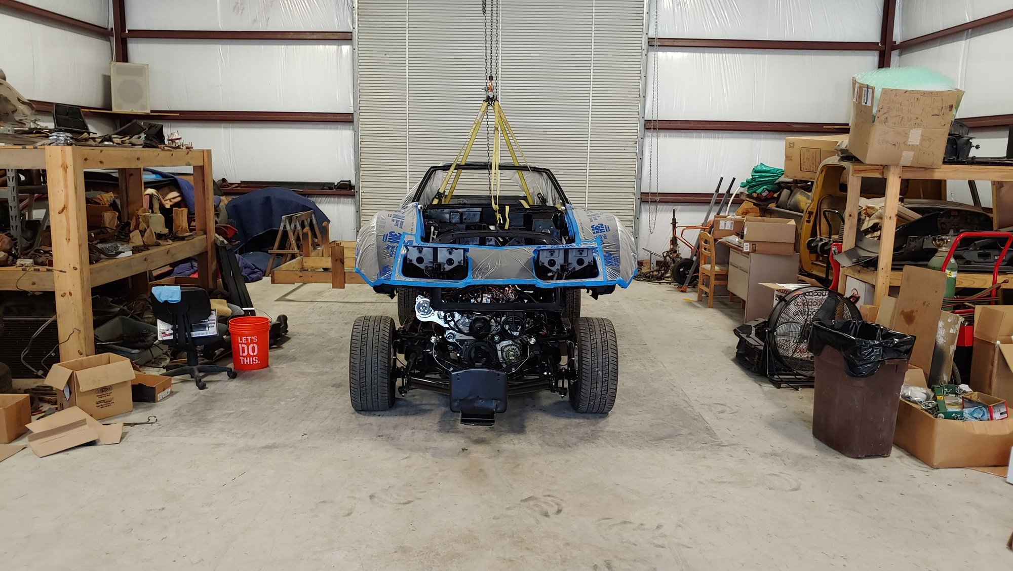

Engine runs, with good oil pressure, so the body went on this weekend!
Man that LS looks at home in these cars!

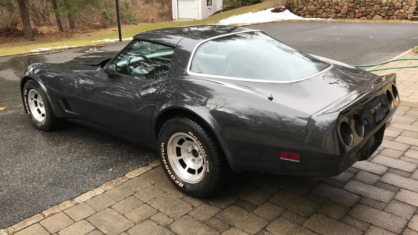

I'm lucky I have another C3 to play with so I had to think about taking another on.... but how could you pass up a low mile rust free 4spd car (at least in the Northeast) with boxes of NOS parts for super cheap?
BTW.... I love the color you chose and here is my 81 so you can see why I'm biased.

The '81 looks great, what color is it?
It the original factory color for 1981 - "Charcoal Metallic" with Silver/Gray interior .

By the way, the body is coming back off again. It will be easier to do my exhaust and install the positive battery cable with it out of there. I've been hacking up my radiator to make it fit better the last few days. Nice to have a TIG machine...

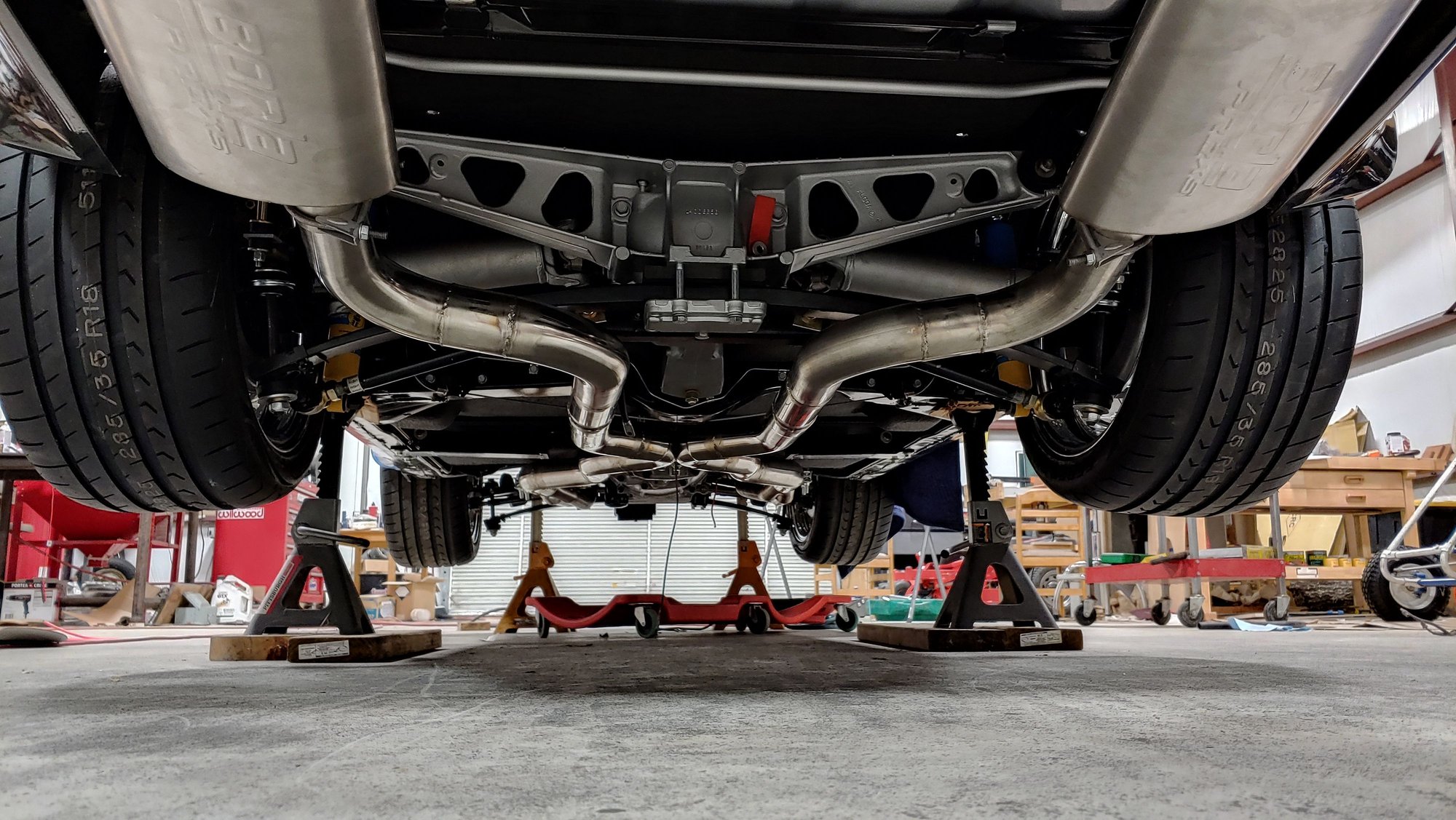

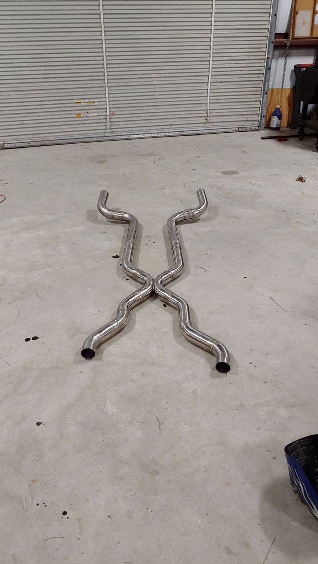

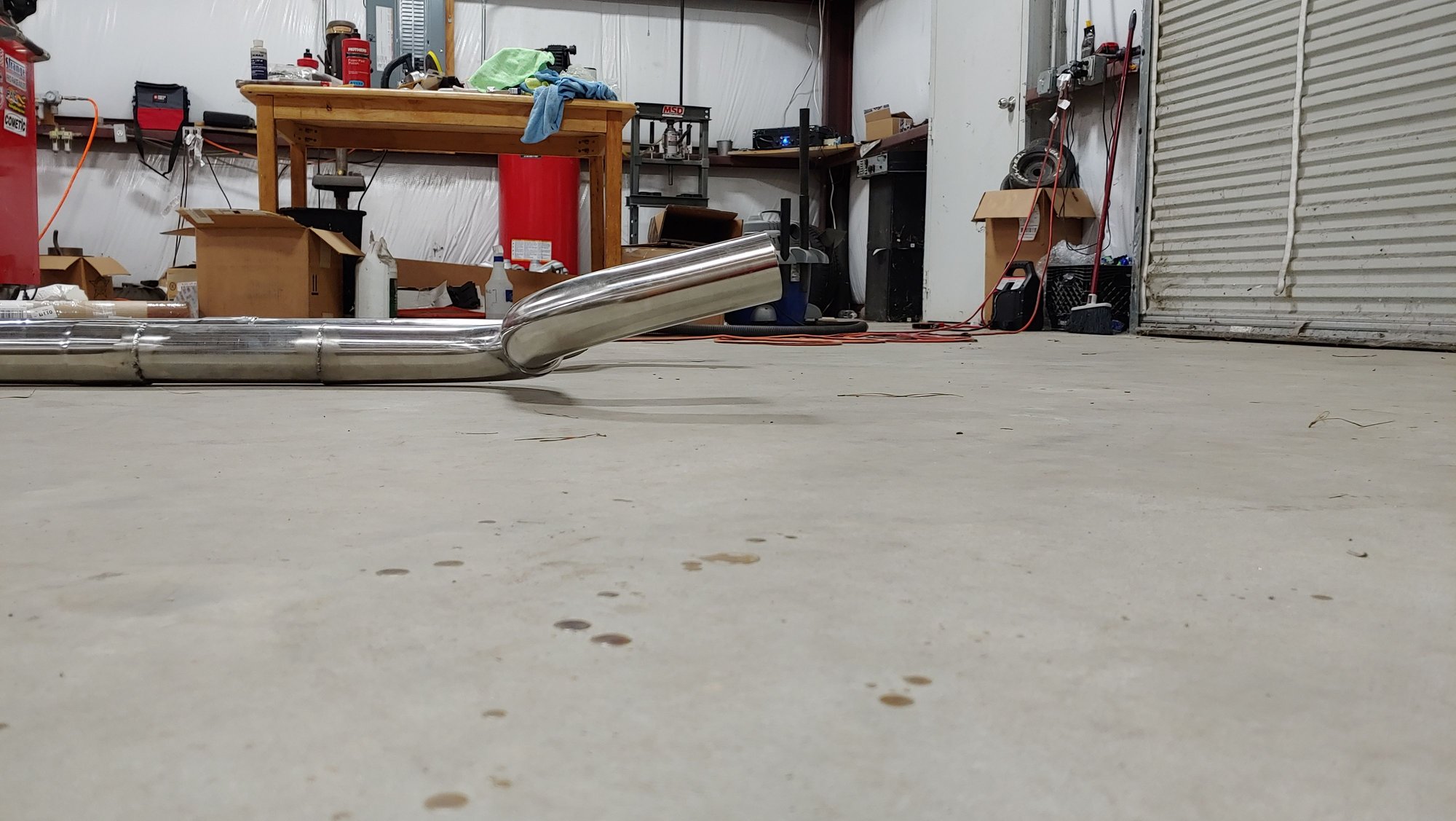

Well the body is back on for good, radiator and fans are mounted, and I just finished up the exhaust last night. Now on to wiring, then interior.
Exhaust is all 3" stainless, fully welded back to the mufflers. I tucked it up as tight as I felt I could, but we'll see what my ground clearance is like I guess when I get it back on the ground. I've got a little over 1 finger's width between the top of the exhaust and the bottom of the car (floorboards, and rear end).

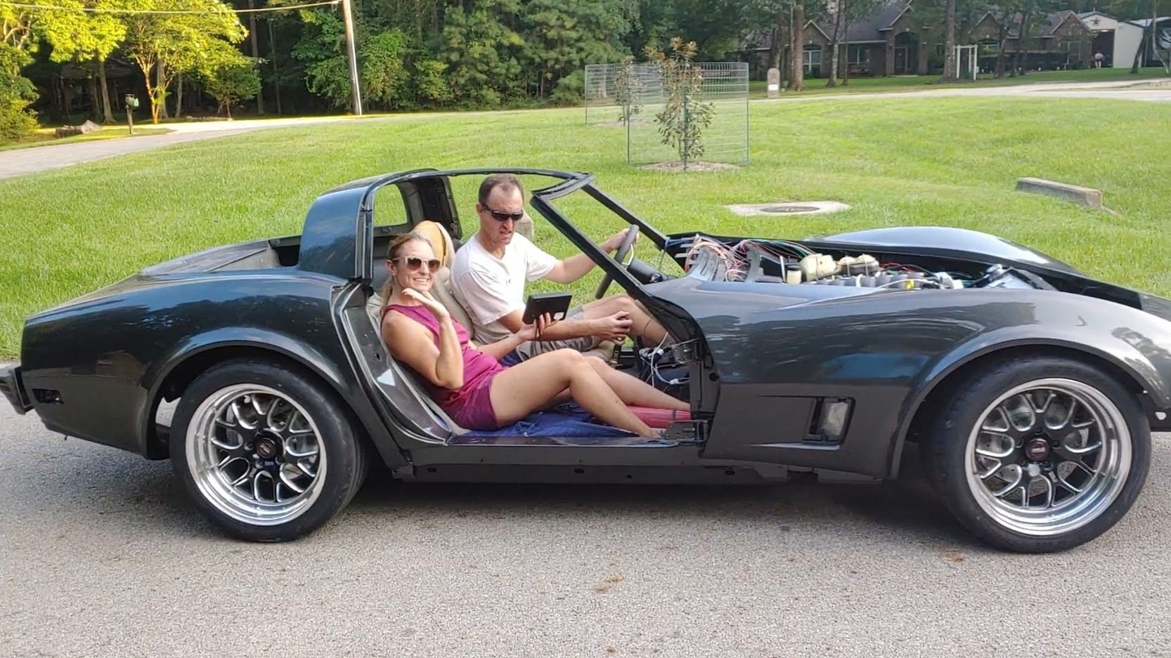

Well the car runs and drives. Been making progress on wiring. Now is the slow and tedious part of the build, but its getting there.
I have since fixed the fuel pressure issue with Holley's hydramat. The tune is very rough, but the car definitely scoots.
Here are a couple of pictures as well...

Lol, that's hilarious, you driving a car with major pieces missing like its some kind of Flintstone mobile.
That's going to be real nice with the more powerful and better running motor.
Yea, you know... Gotta do a shakedown run before I get too far complete just in case the body needs to come back off or I've got motor/tranny/rear end issues. Luckily that is not the case!
Having driven it though both motivates me to get it finished, and makes the tediousness of all of the wiring even more unbearable.
