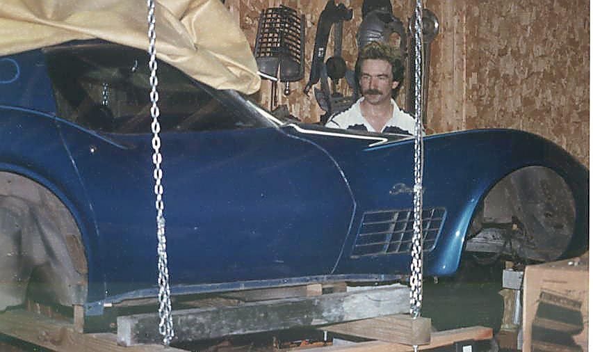

That's more or less how I did mine, lifted the body with a floor jack, 4 x 4's across the bottom, fastened with threaded rods thru the #2 and #3 mount holes. I suspended my body from the rafters over the frame with enough height to comfortably work on the underside.

FWIW: Here are a few photos of how I handled suspending the body over the frame, hung from the rafters. Allowed work underneath as well as storage of the chassis below. The body was lifted off the frame using a floor jack and blocks. I added blocks between the frame and rocker channel to raise the body in increments until I had enough space to fit the 4 x 4's. Once I reached the height I wanted I hung the 4 x 4's from the rafters with chains. If I didn't have rafters available, I could have built some simple platforms for each end of the 4 x 4's to support. A number of ways this could be done.
