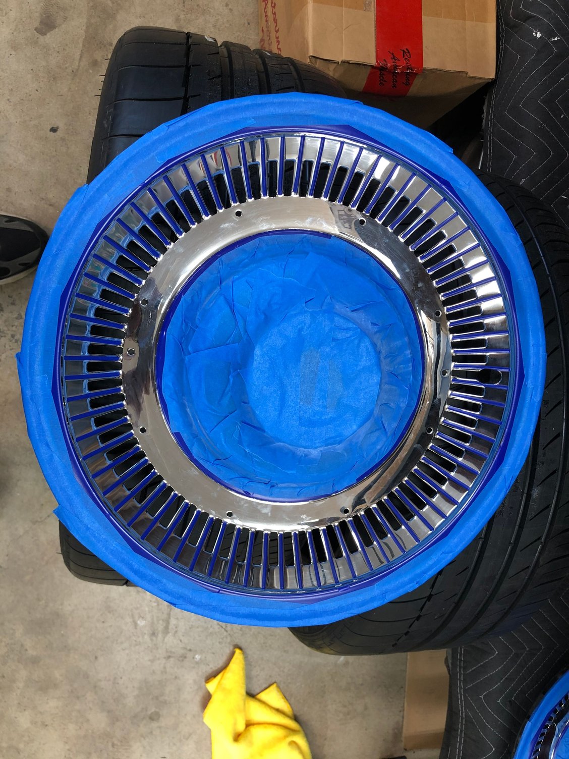

Then began to tape them

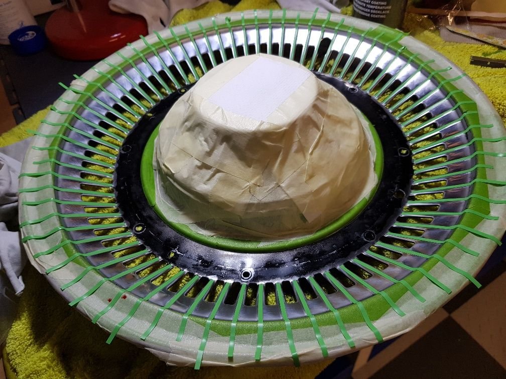

How did you cut the green tape and removed it after spraying ? Because the chrome fins are not touching the outer ring

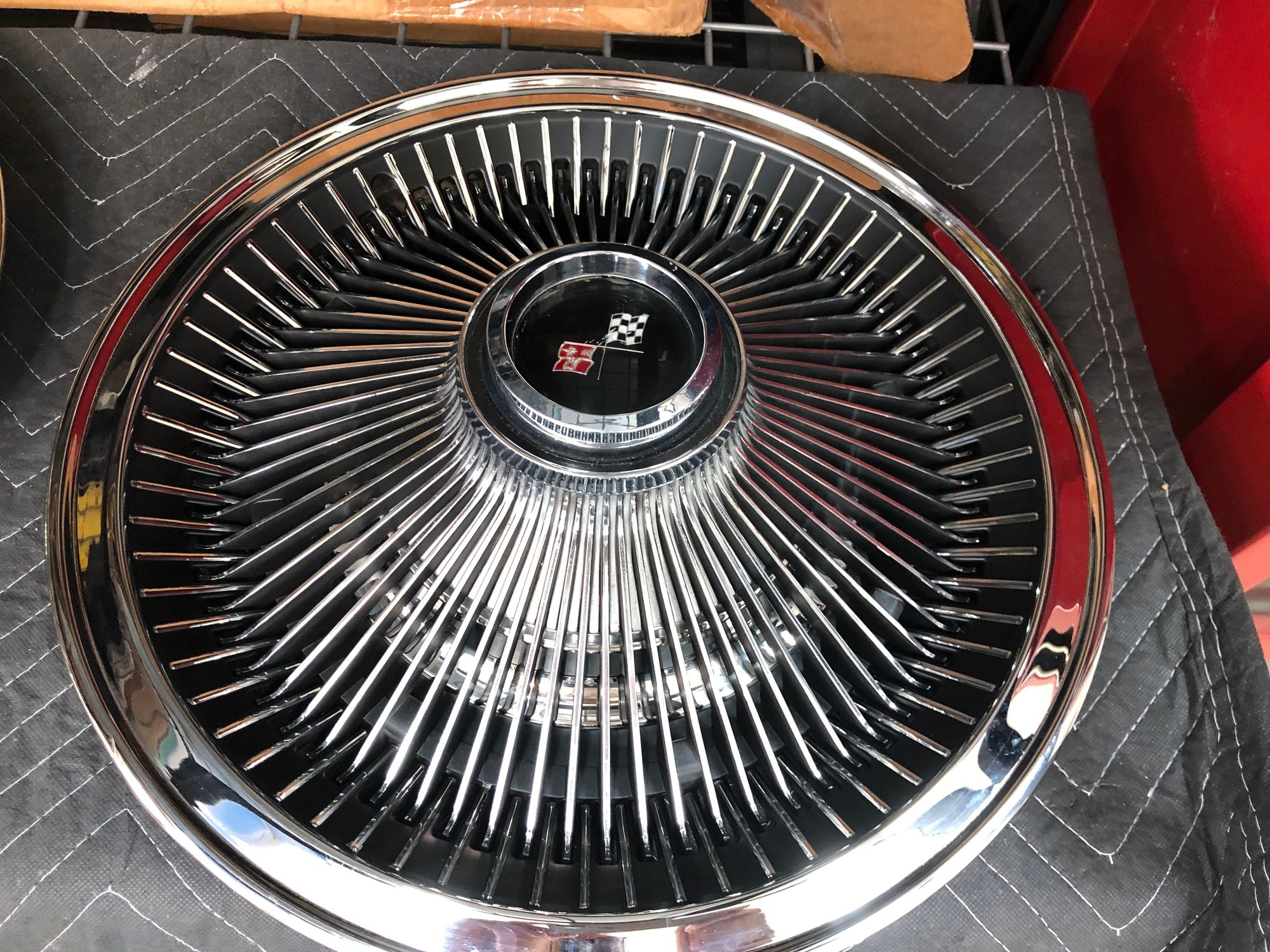

Here’s a look at my P02s, that I restored. First I had them professionally polished, then I masked and painted. I used a leather tool to cut the end of the tape for the fins. I rounded both ends of the tape, a lot of time put into masking.

Found a tool in a Art-Shop that works
Not perfect but ok for me
Beautiful

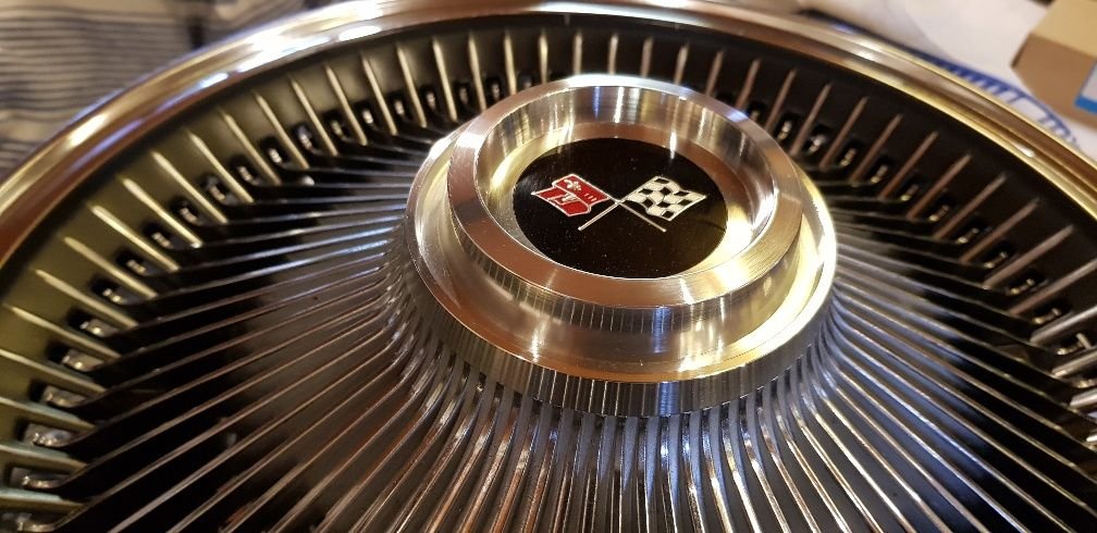

All looking great. I never got anywhere trying to find out info on a set I bought and are now on the red LT-1 which have different centres. There's no GM part number on them so I decided they were home made out of blocks of aluminium and likely a one off set?
