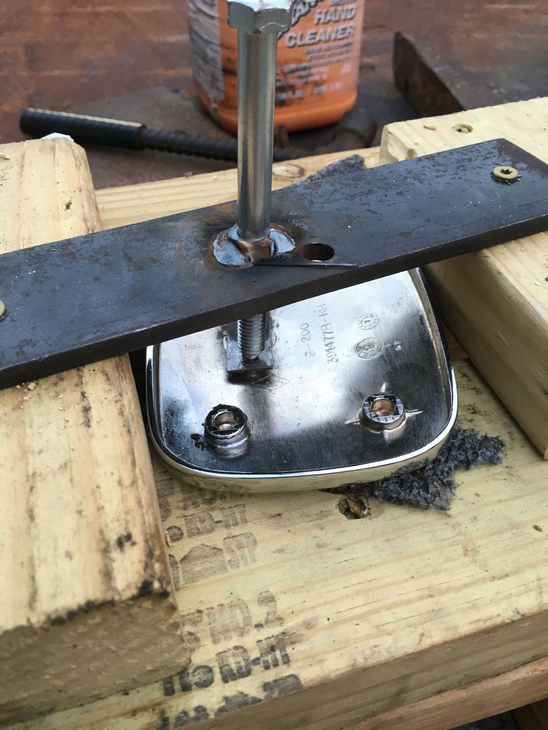

I made a little frame out of 2x4 used a plate and a bolt and pushed the plate that goes over the ball down so I could make a shim to stick under rivet and jb welded as others have done. The guy at the local glass shop glued it for me don't know what he used. I used Black RTV on another car and glass fell out about 6 years later.

Here a picture so you'll get the idea. This pic is when I was trying to just shroom the rivet but I couldn't get it tight enough.

The 'usual' method of tightening up the mirror head is to make some "U" shaped metal shims and shove them under the [loose] hot-upset heads. That should tighten them up for some time. {Nothing is permanent.}
