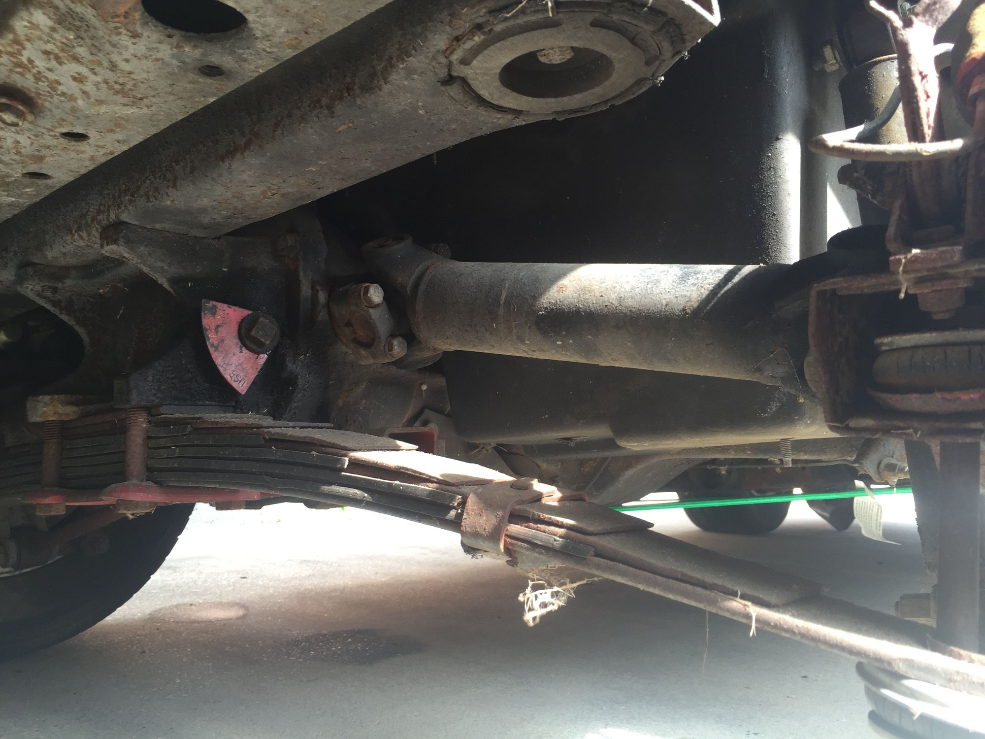

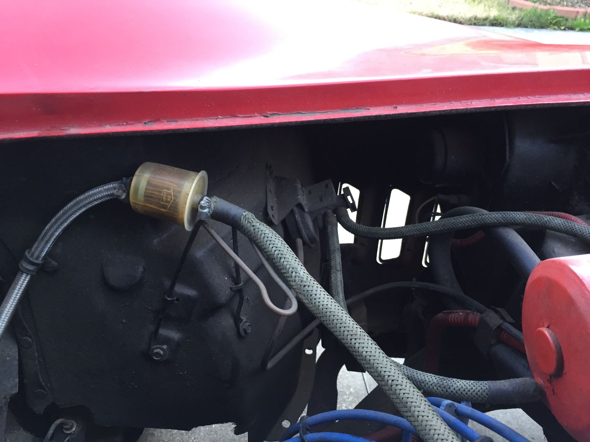

Anyone have a pic of their inner fender where the expansion tank would have been? He sent me a pic with no expansion tank and I see 4 dimples in a rectangle maybe 4 inches x 3 inches, hard to tell with no reference. Is that the right place?
Also car has 7 leaf spring

7 leaf and u joint caps
Where expansion tank is not
Just a couple of photos he sent is this correct for no expansion tank
Old Feb 5, 2016 | 12:57 AM
  #37
20mercury's Avatar
20mercury
Joined: May 2008
Posts: 3,753
Likes: 721
From: Lafayette Louisiana
Default That is it.
That is it. I had the same dimples in the same place on my 68 454 NOM. In my case, since I wanted to install Vintage Air, I bought a 69+ DeWitts big block radiator which required an expansion tank so I had to drill out the dimples to mount the expansion tank. Kinda of hated to drill the dimples, but hey the 69+BB radiator is bigger than the one I could have fitted if I stayed all 68. More radiator is good in Louisiana.
Good luck with the purchase. I am thinking unless you see body work around the hood surround and fenders and so the inner fender might have been replaced (but who really knows), the odds go up that this one could have been a big block. IMHO, check completed ebay and Mechum for pricing on 68's with NOM SB's. Again, just my 2 cents, I personally would not pay any premium for "used to be a BB car", you are buying what it is right now and want to pay a fair market price (or less as a buyer,) Again good luck with the hunt, Jan/Feb is a buyer's market for great deals.

The leaf spring is not original. Originals didnt have bands around the leafs

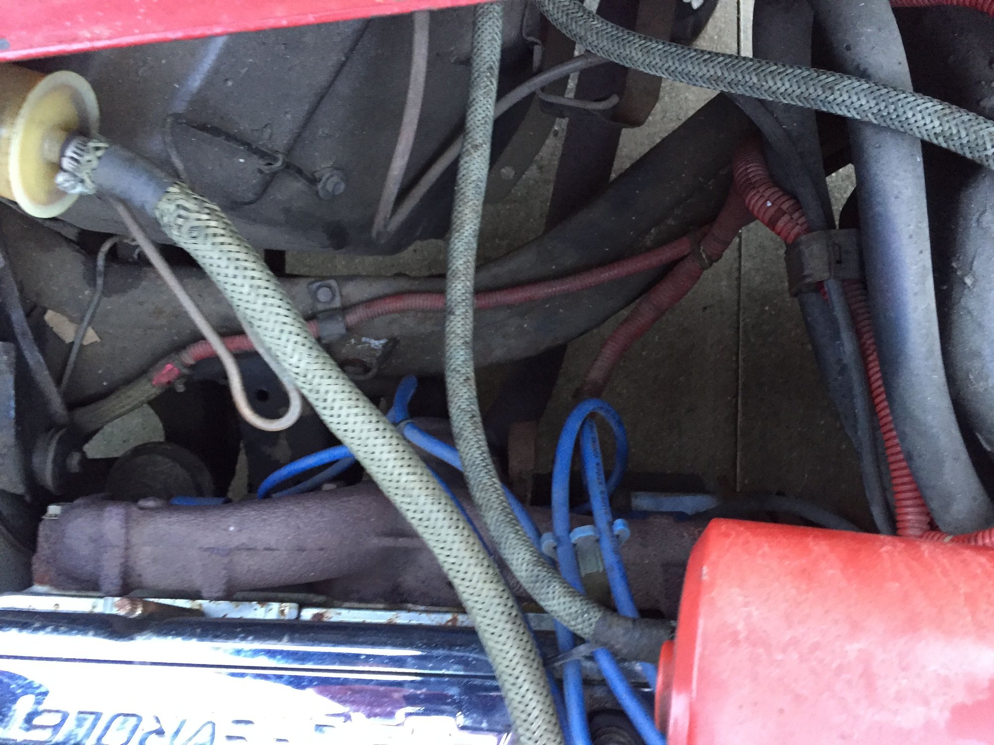

Is that the fuel line attached to the frame below?? If so I don't see a return.
