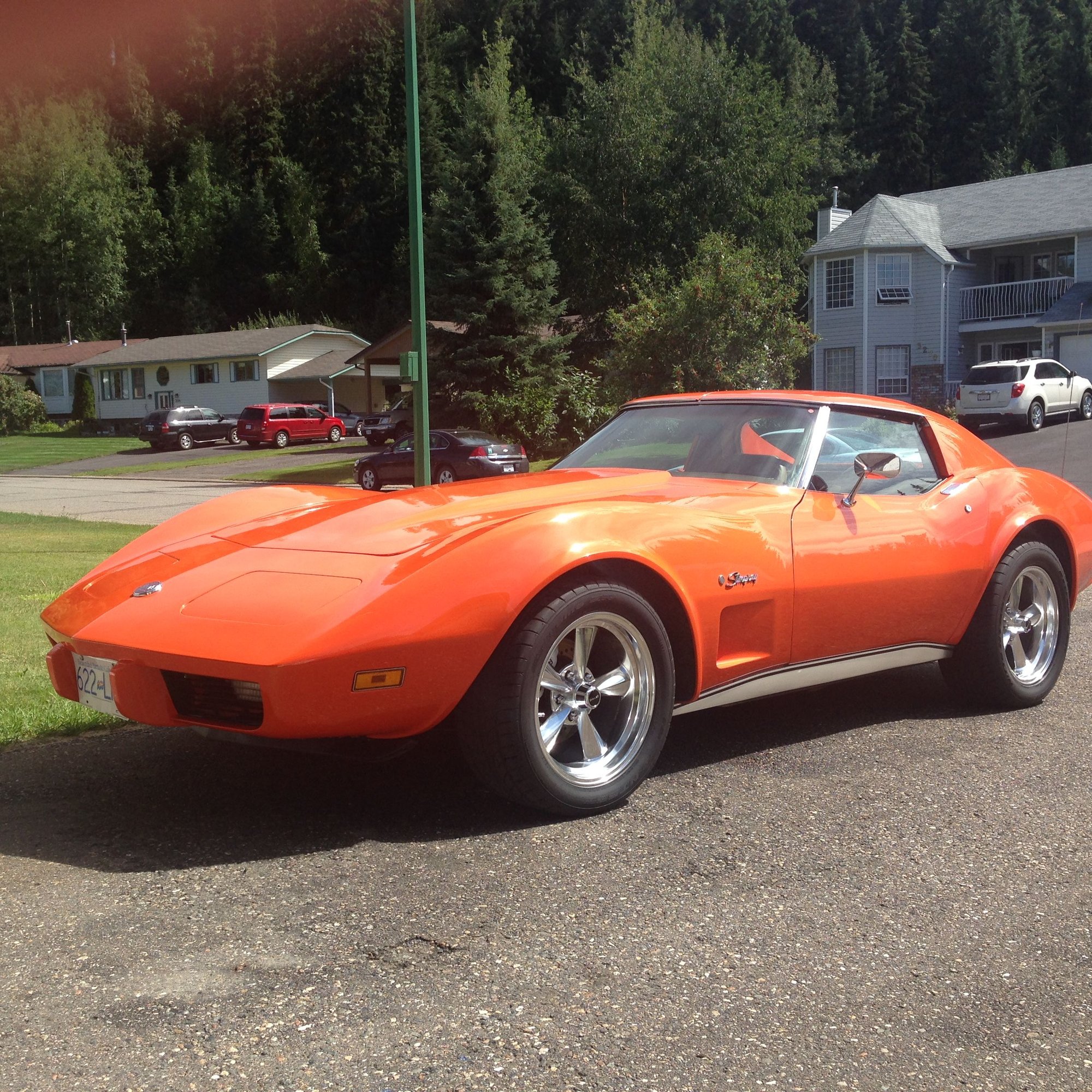

I bought my rims two years ago price was right for me . Mine are 17 by 8 with 4.5 backspace . Tires are Nitto 255/50/17 rear 255/45/17 front . All fit good no rubbing
