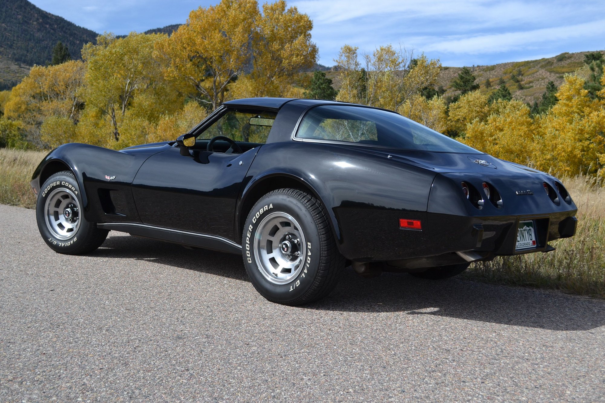

Cooper Cobra is what I got. Can't beat the price at Discount Tire. I paid about $90.00 per tire. Good tread warranty too.
