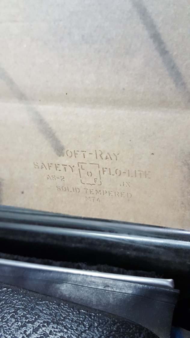

Hoping to understand what the date codes I have
on my glass mean. See photos....rear and side both seem to be the same with AS2 JX but the windshield is different.

JX = May 1968
Your windshield has been replaced. TL = August 1974 or August 1987. The codes repeated themselves every 13 years.

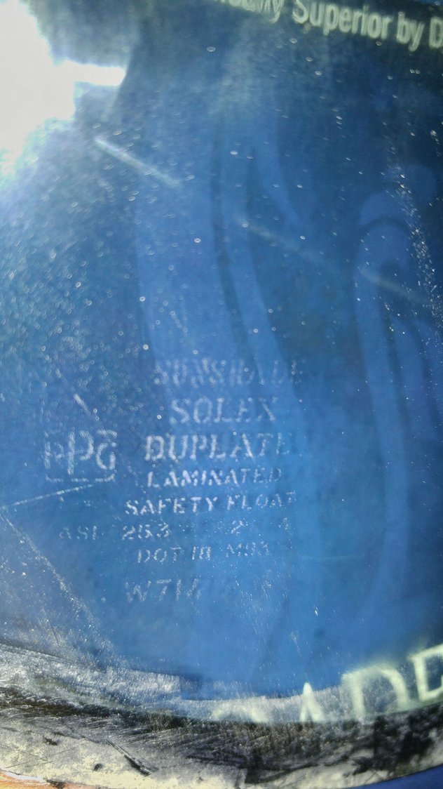

How about this one?

Rodney
Your glass is a replacement. LOF was the original equipment manufacturer for C3 glass.
Hard to make out an obvious date code on your picture. PPG typically listed a plant code number followed by the date code in the month/year format.

Originally Posted by JC68
Rodney
John
Thank you John. That is what i was figuring it was.
I'm going to say that the windshield is from August 87.
Originally Posted by Staylor63
In 1974, the logo above was still being used by LOF, in fact, it was still being used in the early 80's.
I'm pretty sure this logo is from 1987.
As JC68 said, the letter code for the year, repeated every 13 years. I'm not really familiar with the LOF logo on your windshield, but I do know that LOF was still using the logo in your first picture as late as 1982. By 2000 (13 years after 87), LOF had switched from the shield shaped logo, to a solid square, with the LOF letters reversed out in the solid background.
