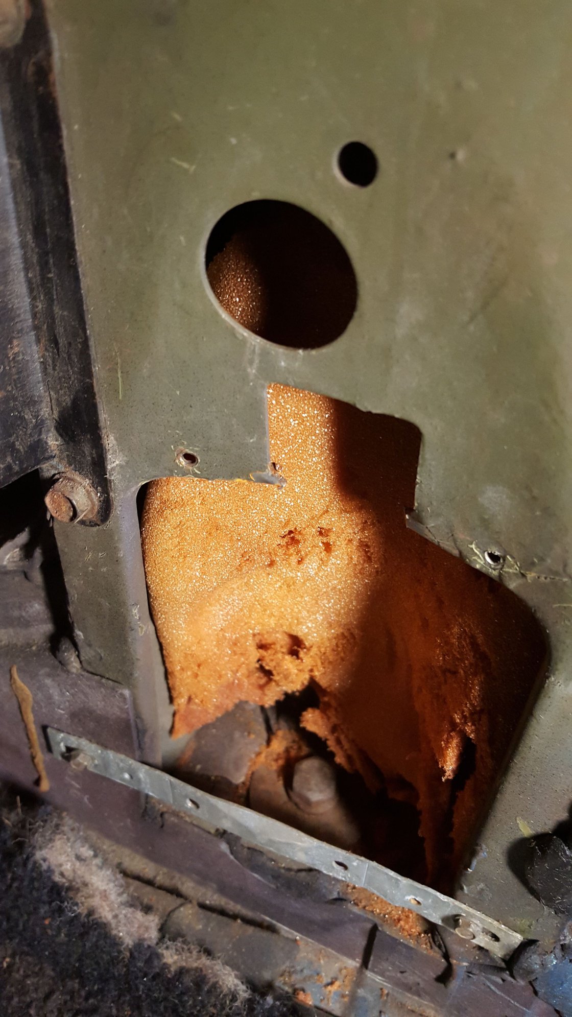

Just wanted to find out what others did, I am replacing my kickpanel speakers although the foam behind them is somewhere between OK and powdered. Just wanted to see if people put new foam back in, or would something like Reflectix give off a better sound?

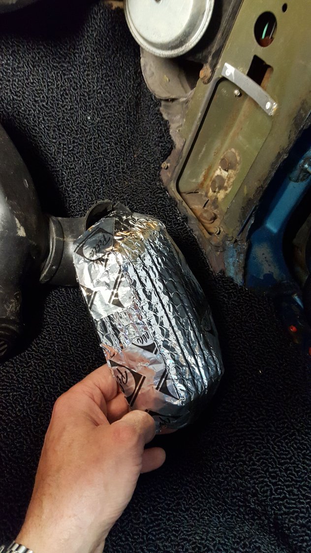

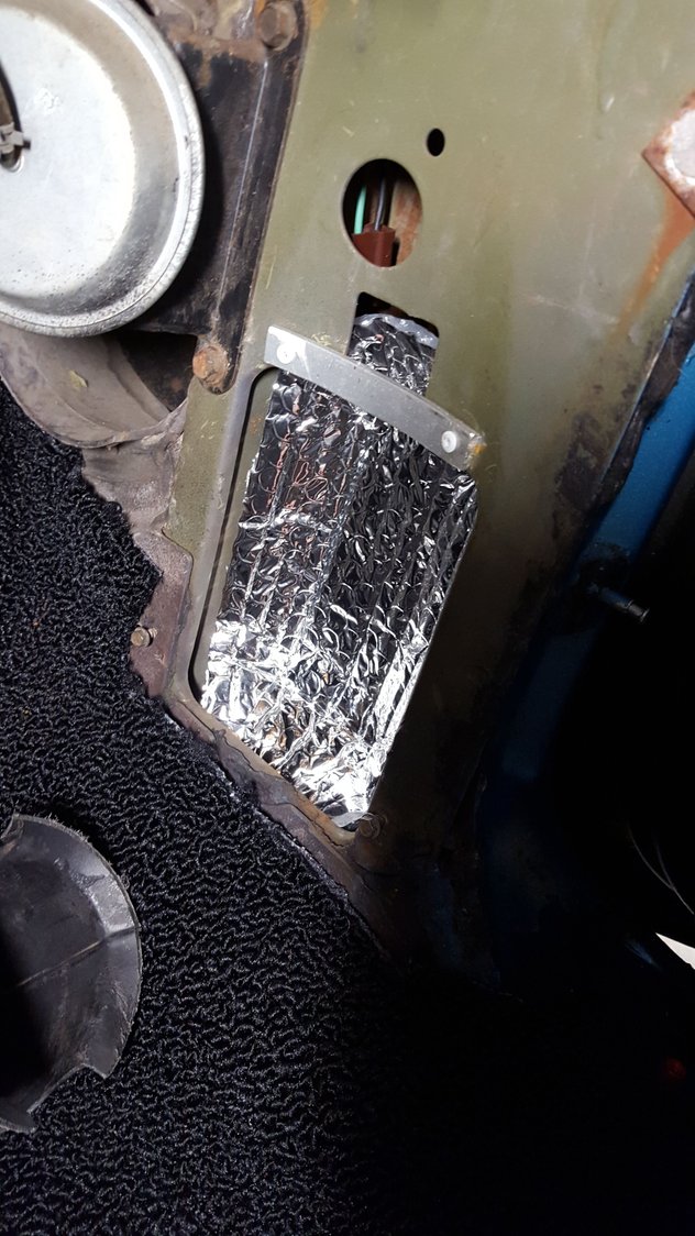

Since I had some Reflectix left over, I just made some little trays of of that along with some Pella window seal tape.
We will see how that works.

I'm glad to see the foam gone only serves to trap and collect moisture.
You have some great looking body mounts I would avoid foam as you have.
