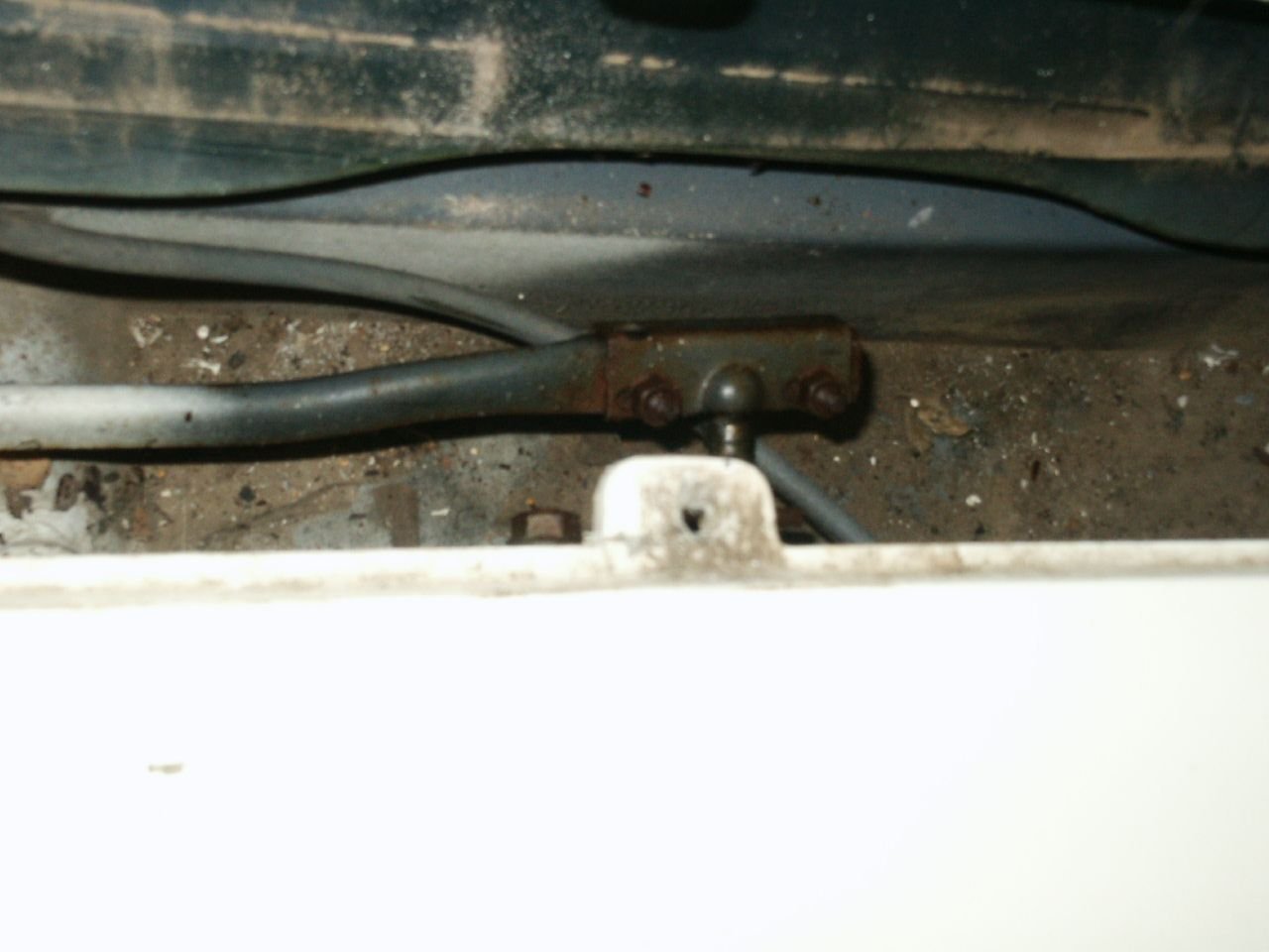

what size wiper blades should be on my 81 ?? I think mine are too long (16")? they are hitting each other when they swipe..help again guys
Well I checked on ebay and it looks like 16"are standard,, so i have a new question is there any adjustment on the wiper assembly ,, it seems like my passenger side is out of whack , i took it off and ran it with just the drivers blade on and it runs out smoothly .. any ideas ??

16" are the correct length blades for all 68-82's. About the only adjustment I know, is to take both arms off, and play around positioning them on the transmissions, until they don't hit.

There is an adjustment at the wiper motor. You loosen the two nuts
and you can adjust each arm to different positions. I can't tell you
which way to adjust, not seeing how they are hitting, but you can
try different positions.
This is the adjustment I am referring to:
Donnie

Donnie is correct, but only ajust a very little at a time. a small movement makes a big difference on the wiper movement

thank you for your help .. i will work on that..

DonnieP73 is right. I forgot there was some adjustment in the connector on the wiper transmission.
