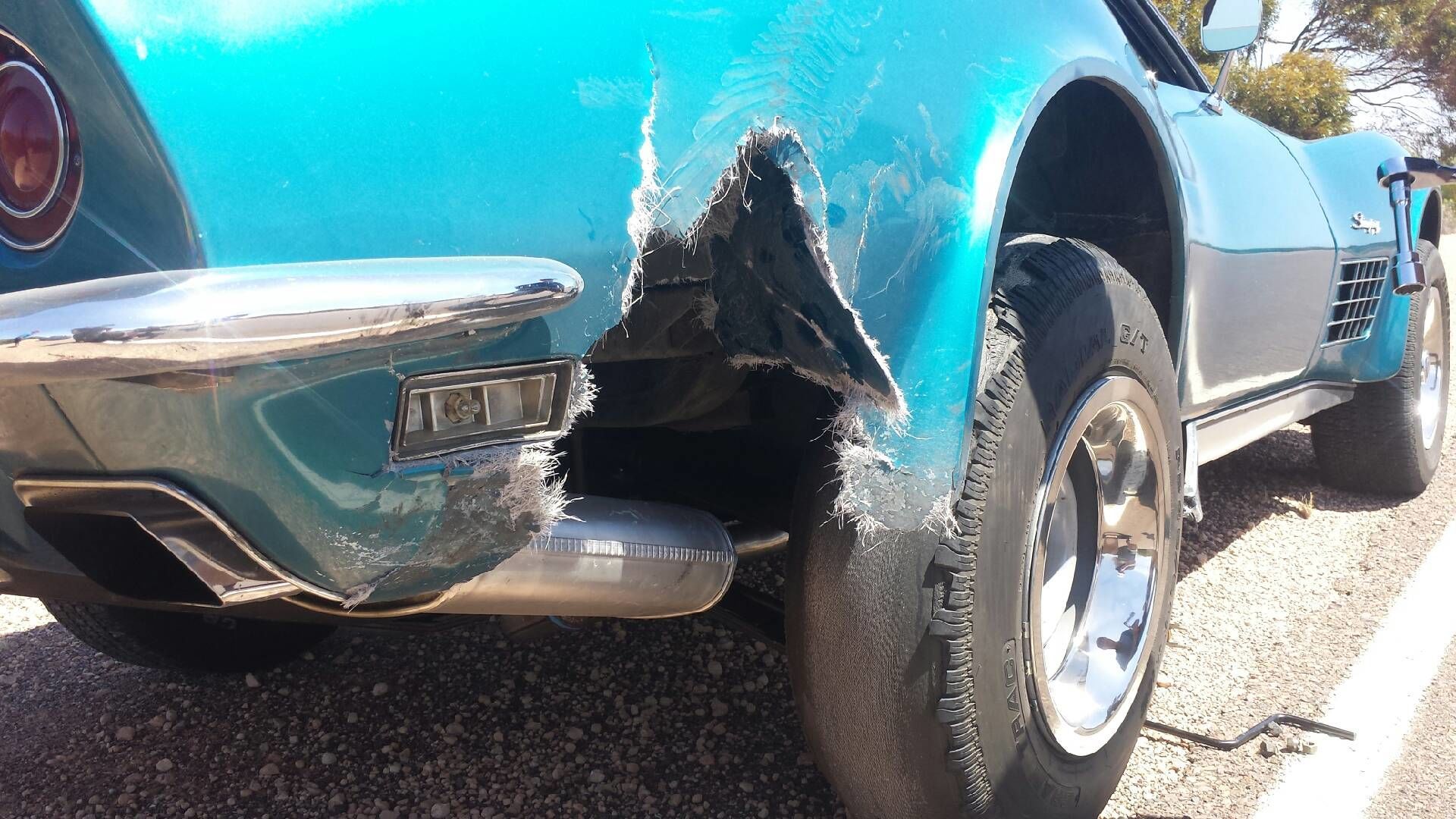

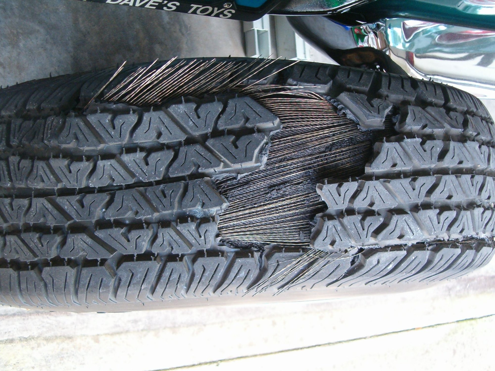

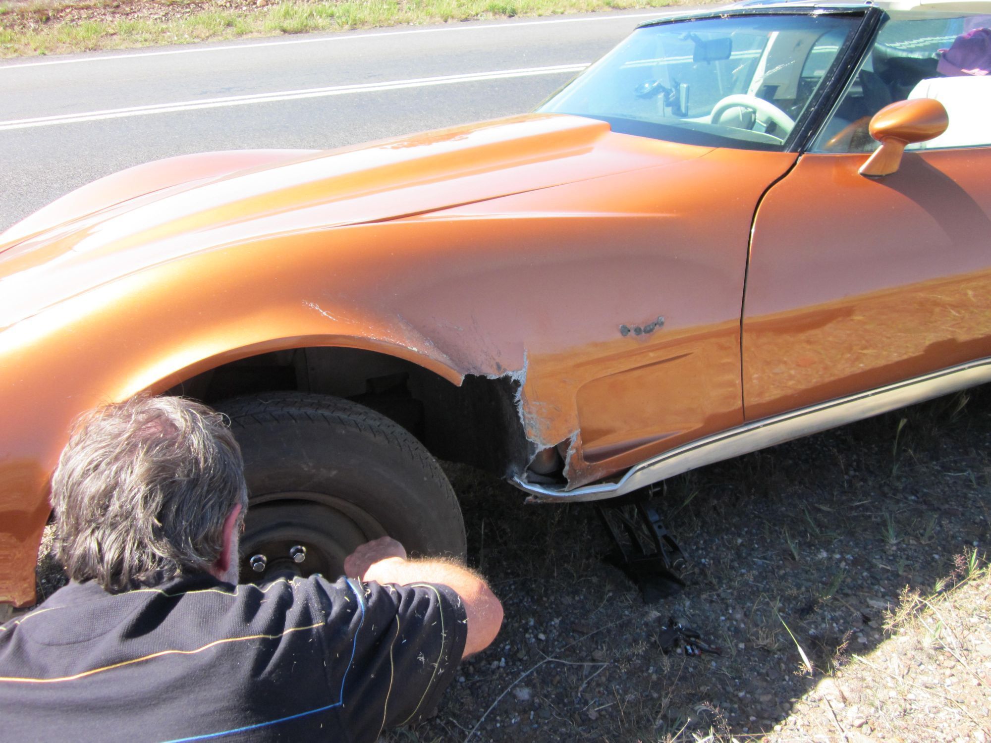

Heres what can happen
Those are from this post
https://www.corvetteforum.com/forums...for-tires.html
