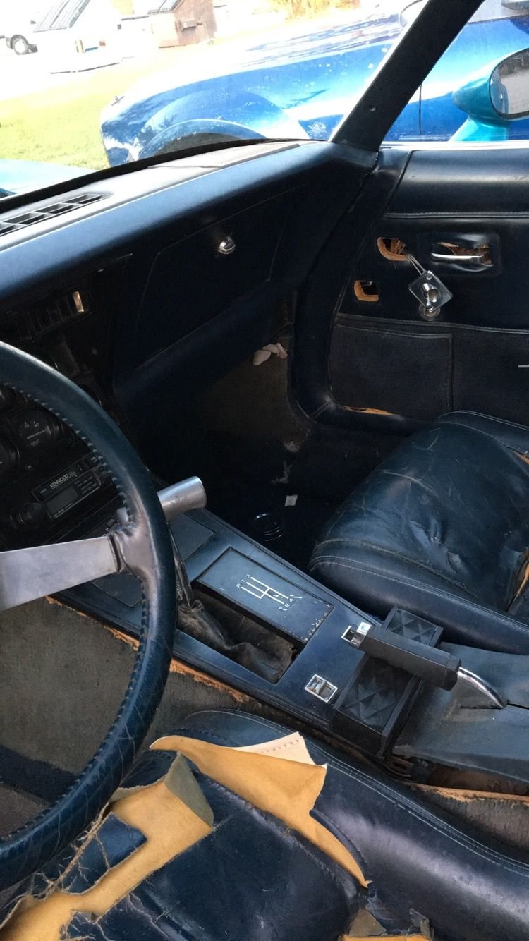

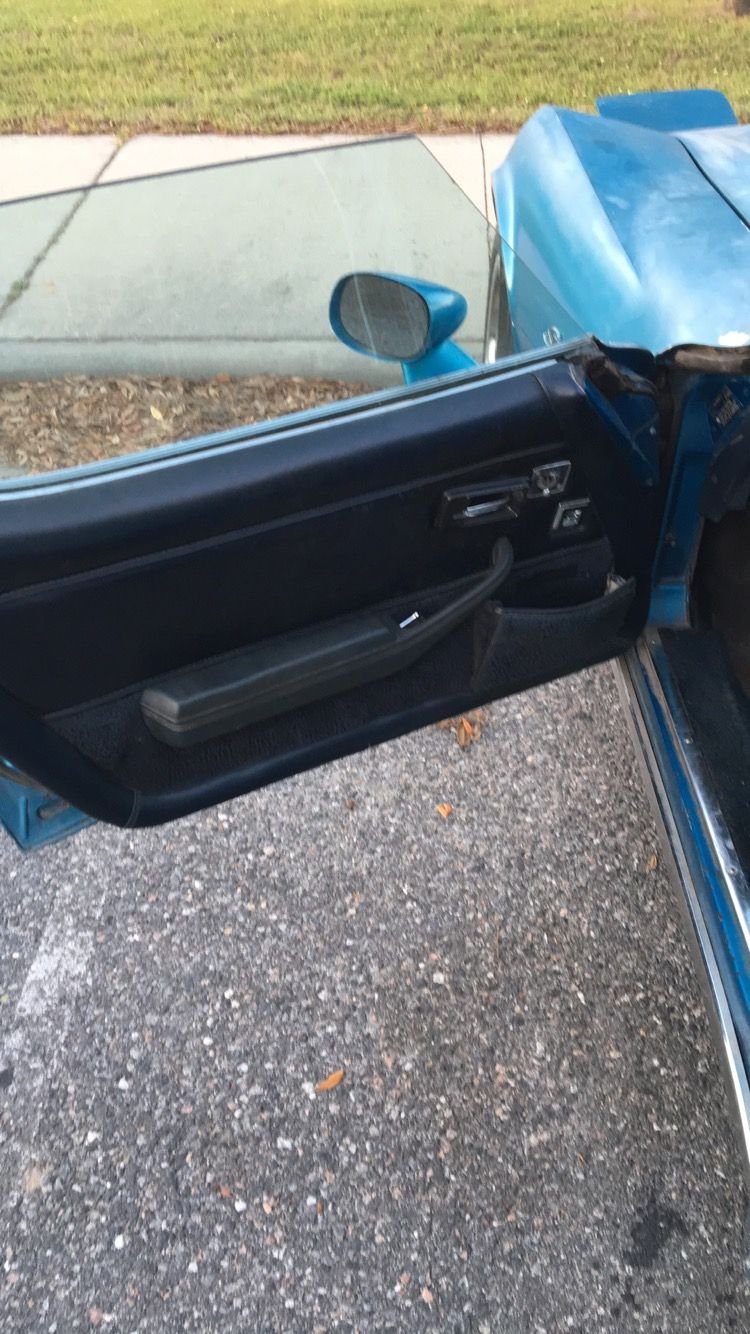

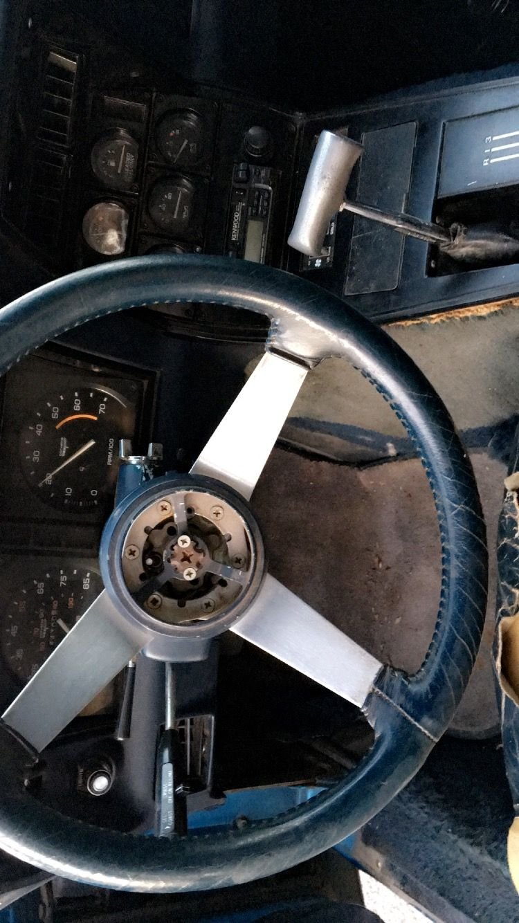

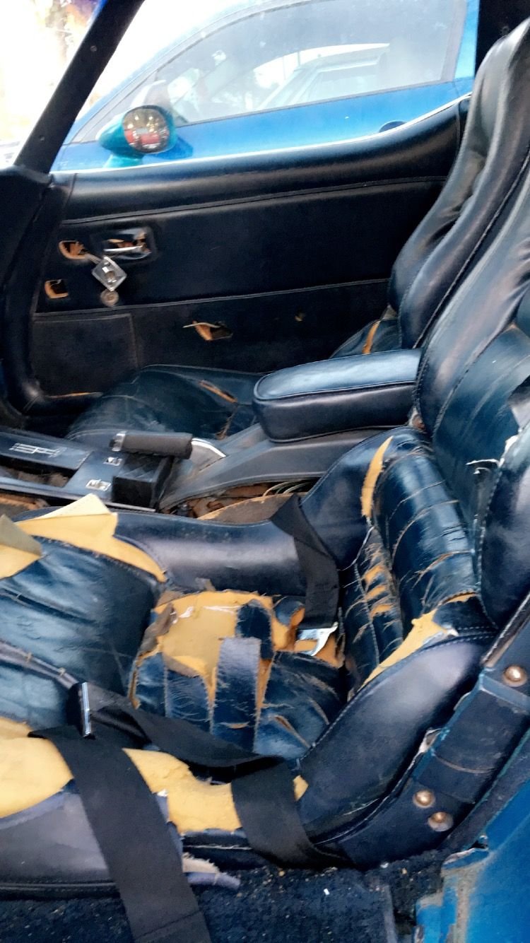

Hey sorry about the late reply But here are the pictures of the interior. <br > <br > <br > <br > <br >

Be careful, if the previous owner did sloppy work, and it appears that he did, this car could be an electrical nightmare and fire hazard. How well does the engine run? Sometimes these projects can become over whelming and cost a fortune to get right and you are better off getting something in better condition. I have an 80 and I hate the speedometer, it is ridiculous to have that in a Corvette!
