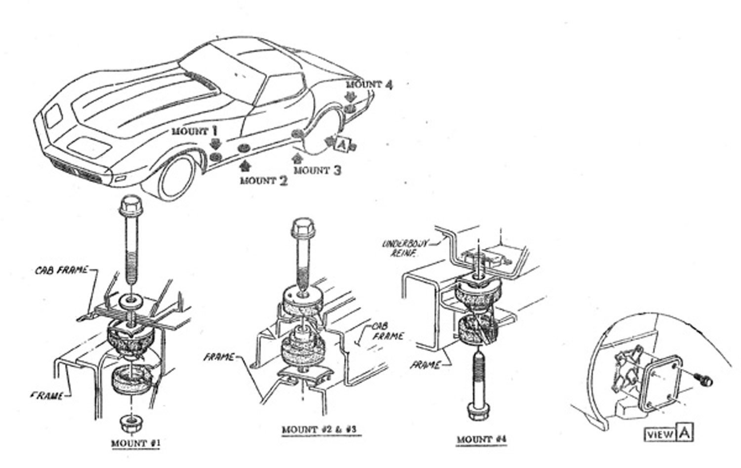

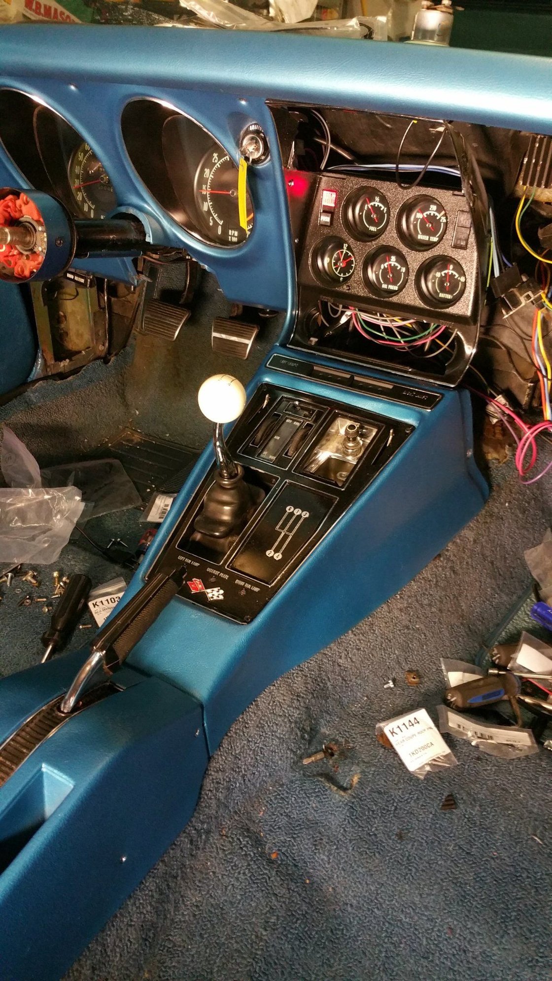

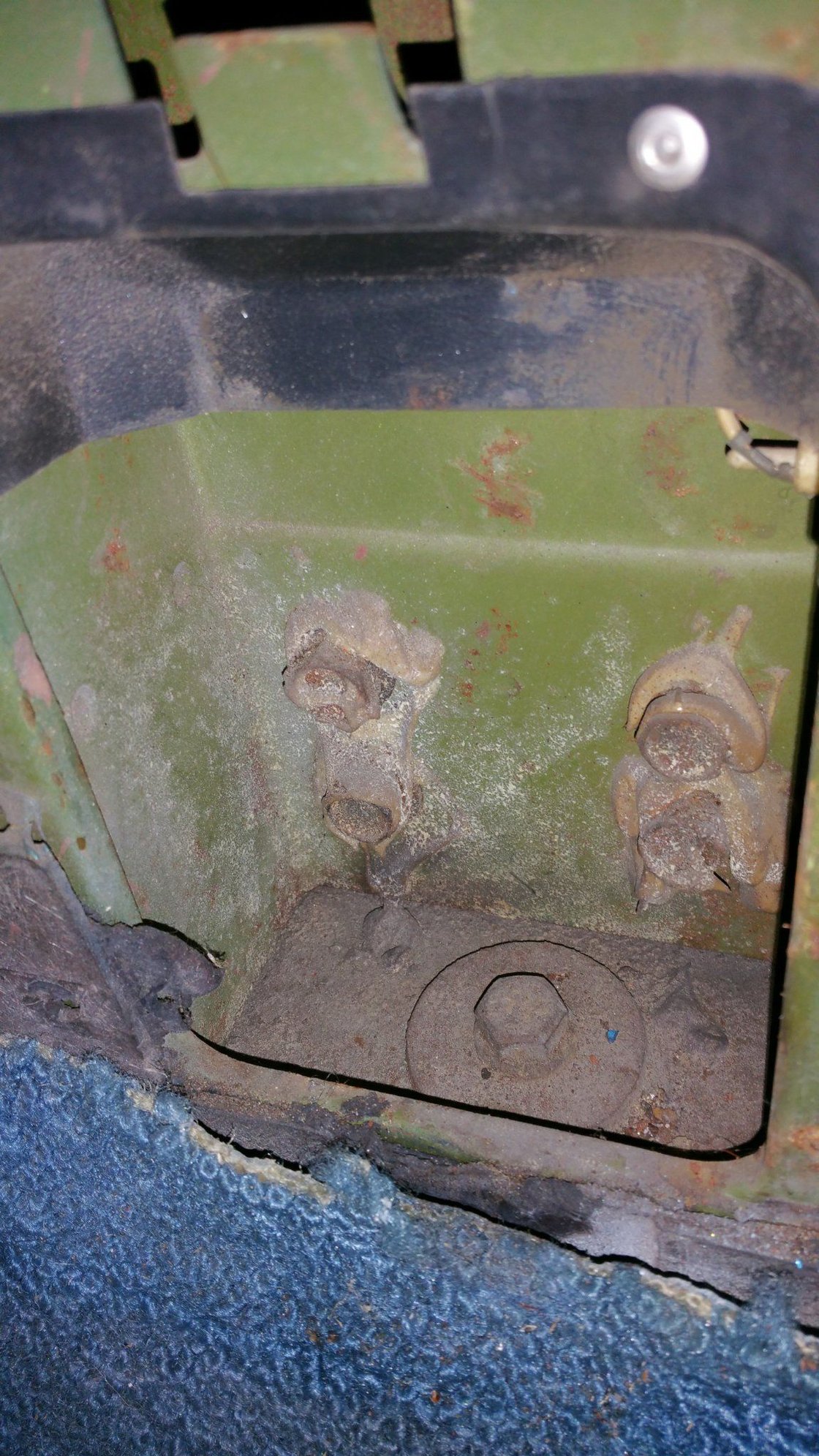

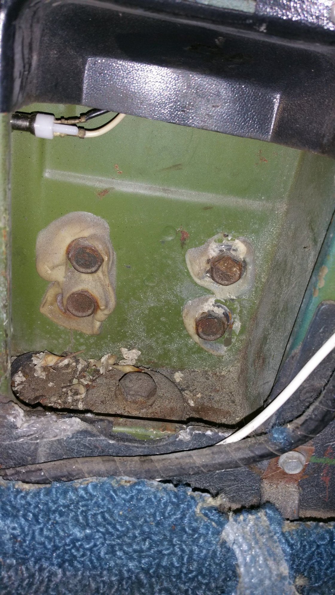

if its a dealer and he has a lift. Put it up in the air and look for rot holes behind the wheels in the frame. Have them take the sill plates and kick panels off and look at the body mounts for rust and there is a panel in front of the rear wheel. You can look in there for rust and with the top down you can shine a light down the rear door pillar to look in that same area. You'll need a good flashlight for that. With the wiper door open look for rust around the windswinds frame and you can look all around the glass. Its better with the trim off but they won't take that off. They'd probably screw up the trim if they tried.
Upper left hand corner is where to look
In front of rear wheel looking in
Front right
left front side

Wow...Thanks for all of those detailed pictures of where to find the demons.
