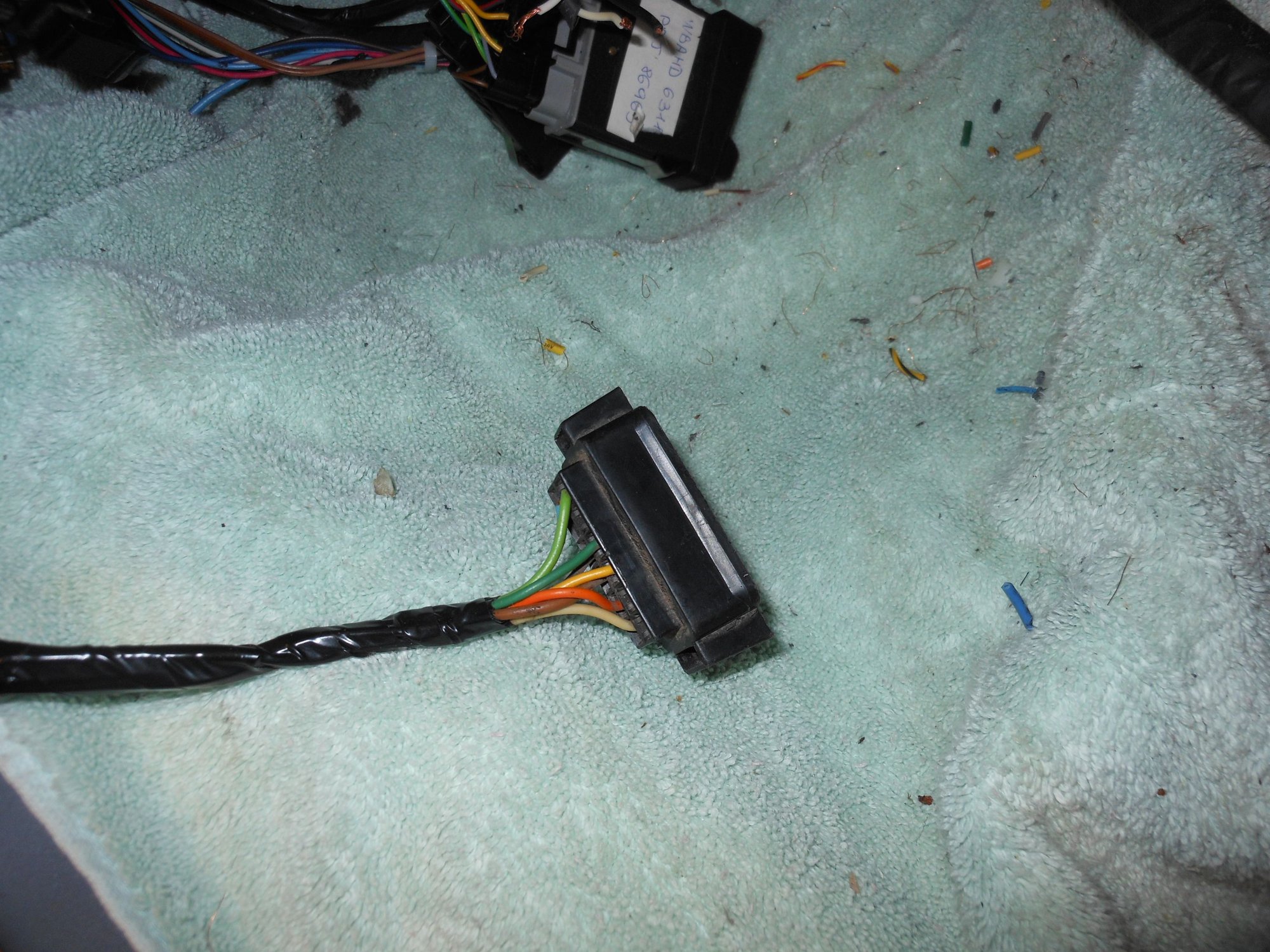

Hmmm -from the factory- there no constant hot wire - in the back of the car.
However - there is a constant hot wire that runs to the back interior light-it's orange- and it is in the same harness.
Try disconnecting the rear harness on the drivers side - up near the fusebox. It's got 12 pins-but only 8 wires. See pic
If the plate light still stays on- then somebody has adding a +12 wire somewhere-somehow?
If it goes off- plug the harness back in and pull the courtesy light fuse- if that stops the light- you'll need to troubleshoot the harness.
wiring diagram for a 72-
http://www.keystonestatecorvetteclub...tte%201972.pdf
Sorry ...my pics are not as good as Alan's!!!
