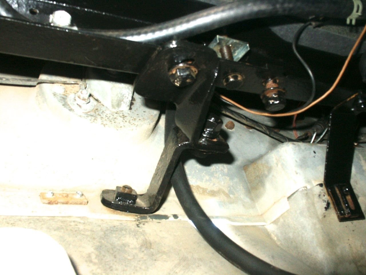

Part of the damage in the rear of my 73 is these bent brackets. I want to straighten them but dont know what they are supposed to look like. I cant find anything usable in the AIM or online.
the first picture is where they go on the frame. Followed by the parts.

The first brackets are for the license panel, you can see on page
160 of the AIM.
The other brackets are for the bumper supports, page 446 of the
AIM. Two outer and two at center.
Maybe you can see the license bracket on my 73
don't have photo of bumper brace:
Donnie

Donnie that pic actually helps alot
