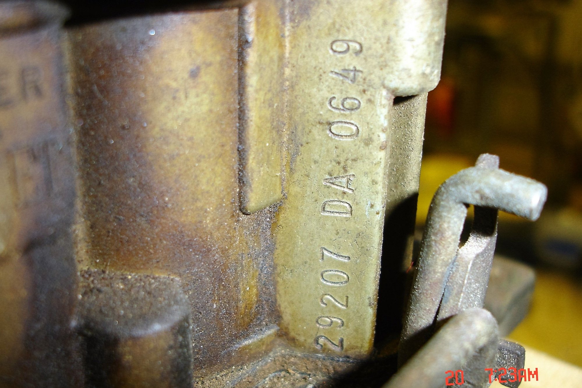

If you go shopping for a correct 350hp carb, be sure to get the DA suffix, Some 207 carbs are over the counter service replacements. They will work OK, but are worth a fraction of a real DA. Look for later dates than correct. Dont pay for the wrong part.

Yes, vettebuyer is correct. You want to make sure you don't pay a high price for a replacement unit. Here is an original unit. Vettebuyer that is a great picture of the engine as well as the A.I.R system.
