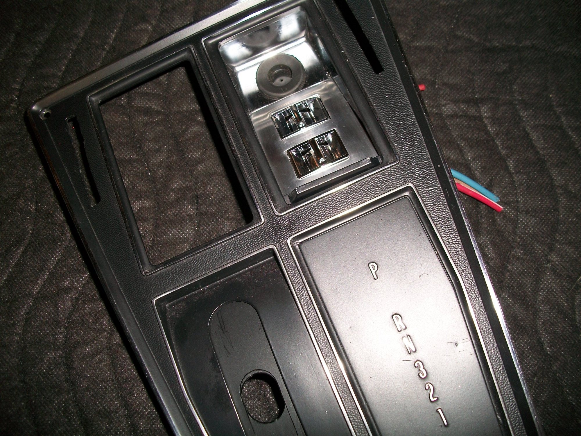

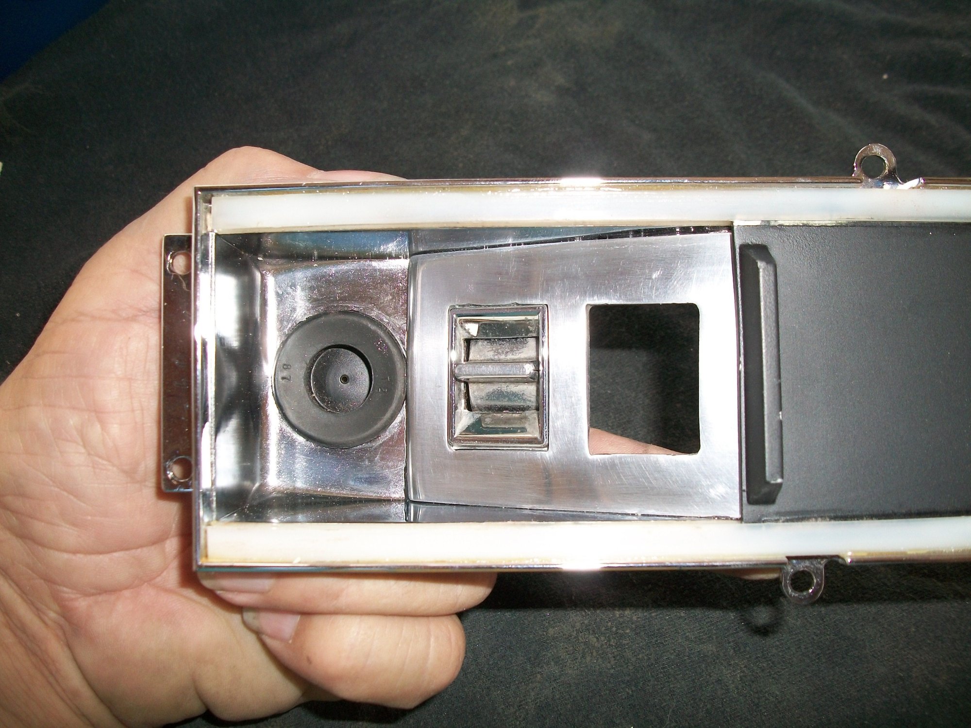

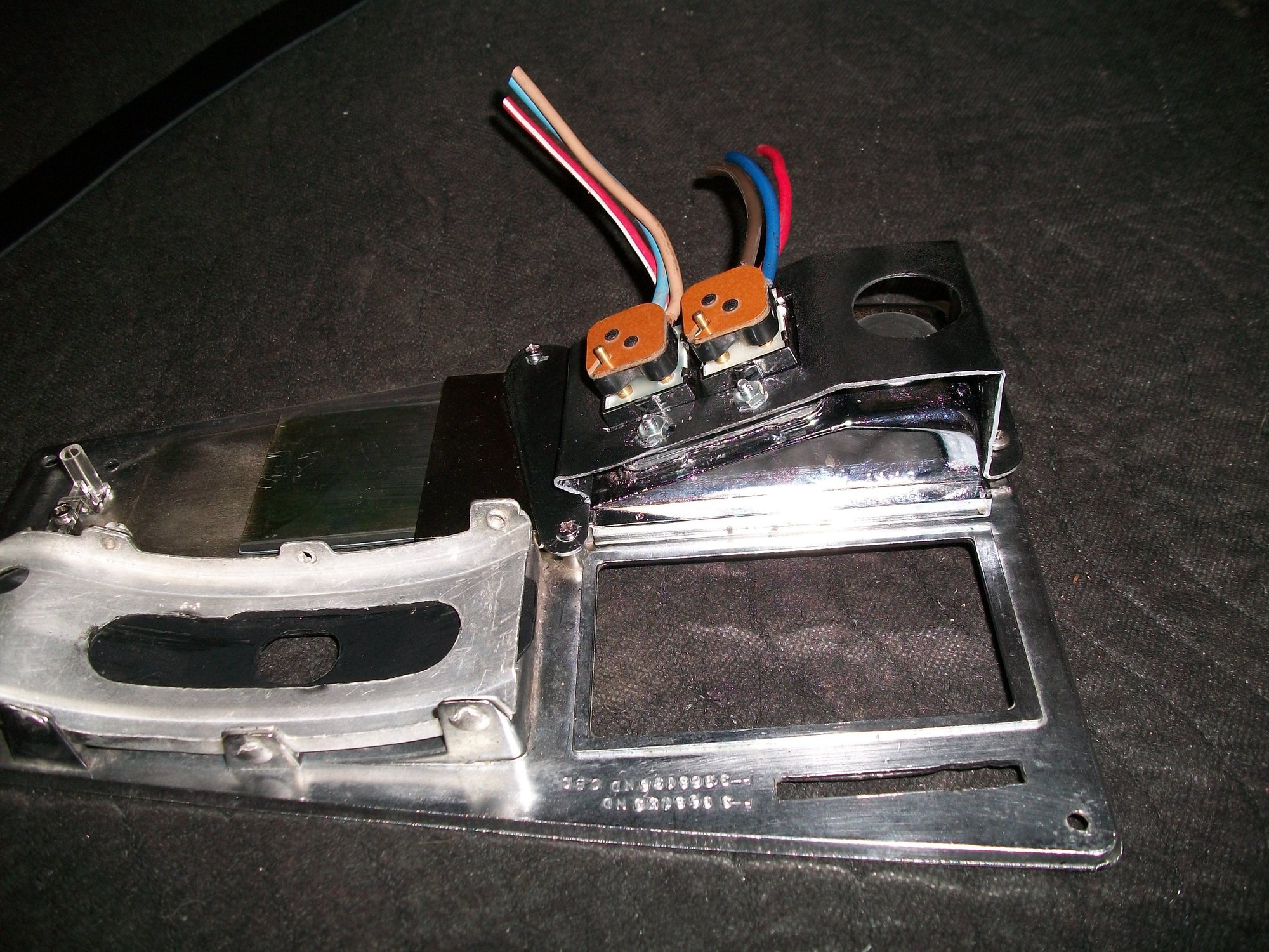

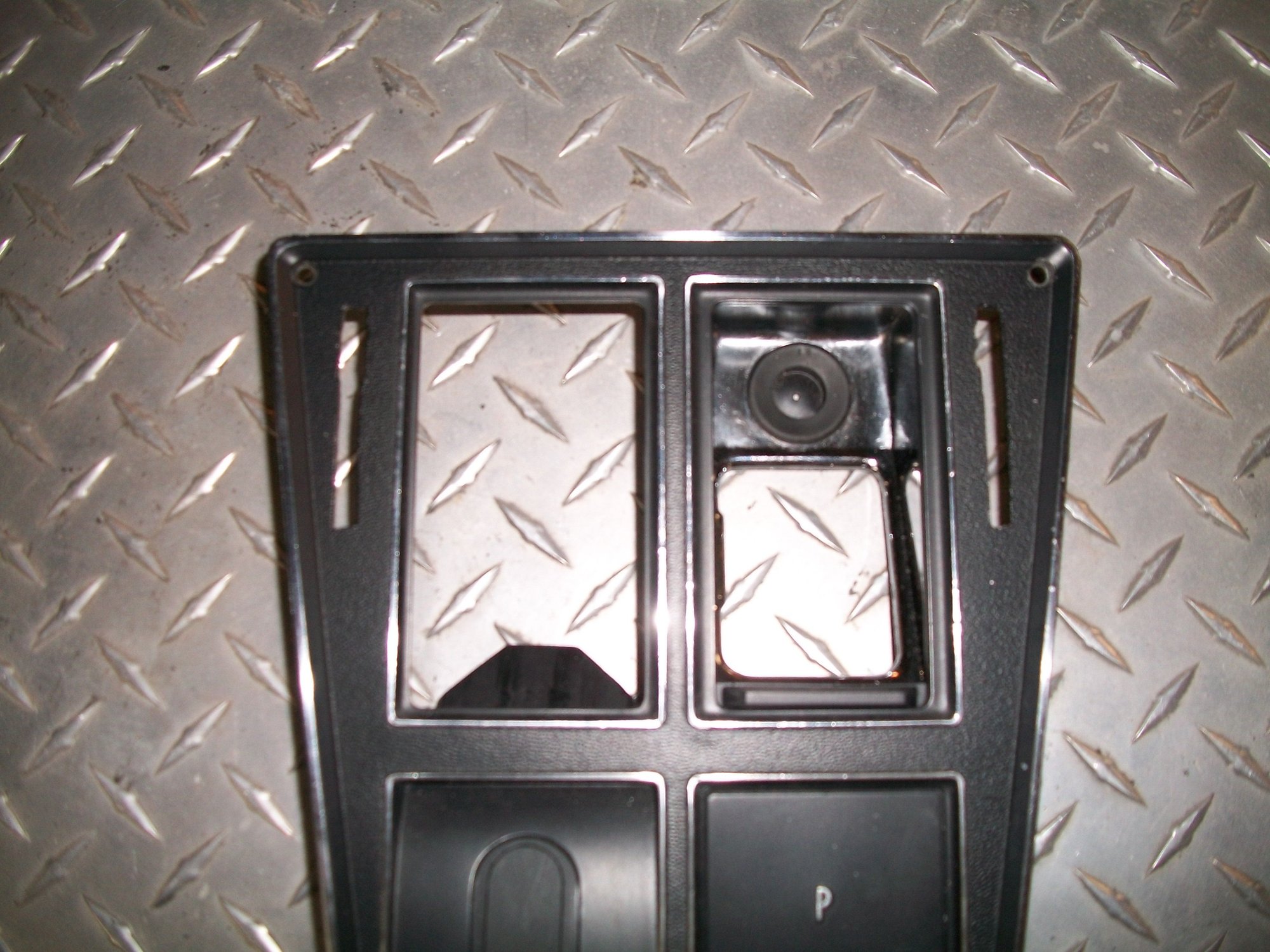

This weekend, I tackled a fun project. Since we decided on electric headlight & wiper doors, I had the idea of putting the manual over-ride switches in the ashtray. I`ll be using a couple power window switches. So I fabbed up an aluminum plate to mount them in. Then I had to make a bracket to mount the switches to from the bottom.
The lighter hole will be a port for the usb connection.

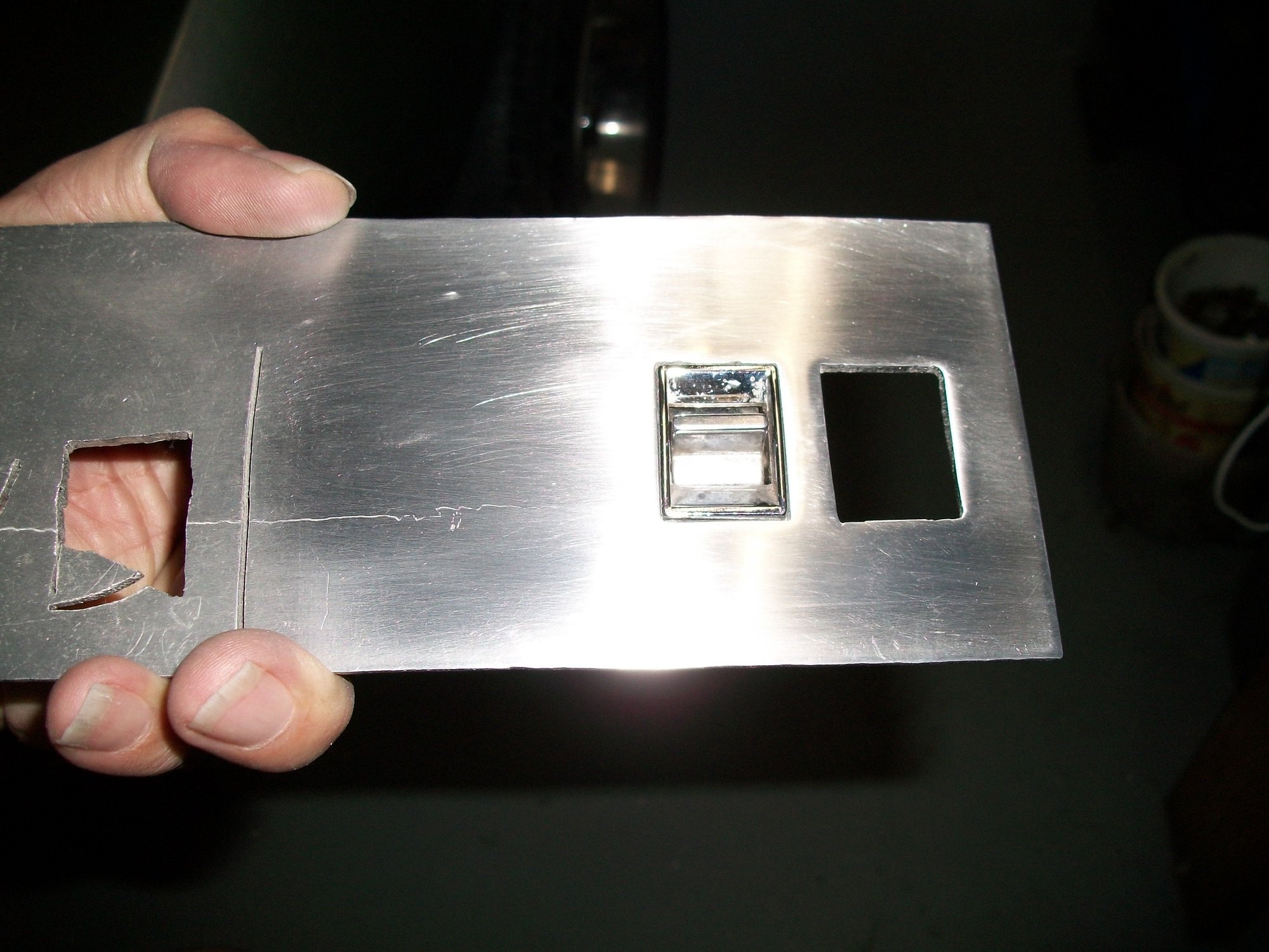

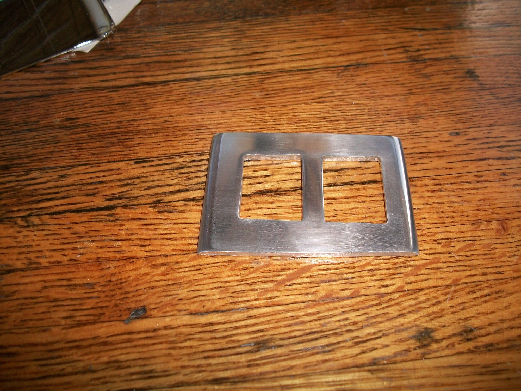

I cut a couple square holes in the plate for the switches....
then cut it to fit in the ashtray holder, sanded & polished...
this is what they`ll look like once it`s finished...

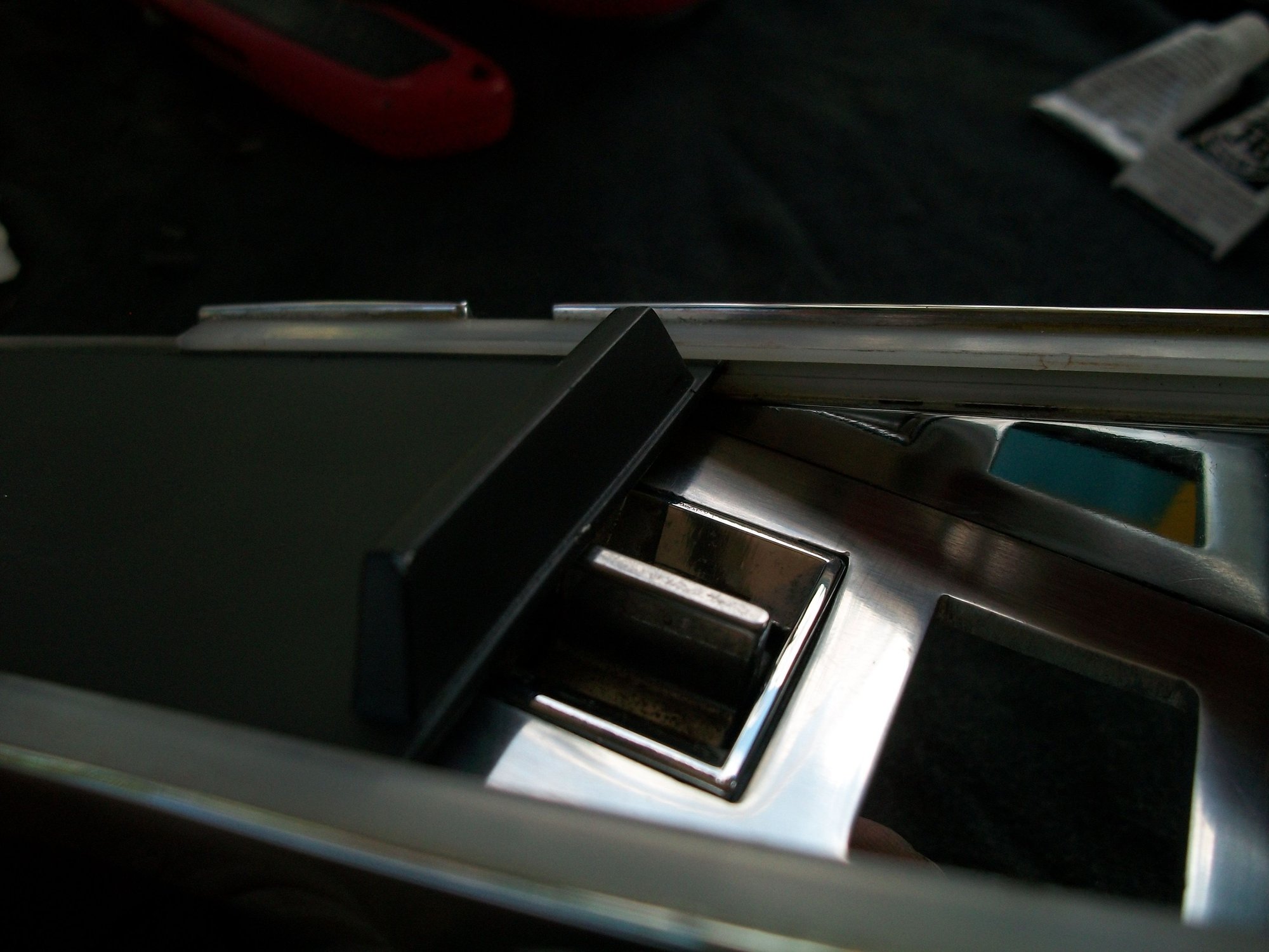

I had to ensure that the upper (wiper door) switch would be mounted low enough to let the door close

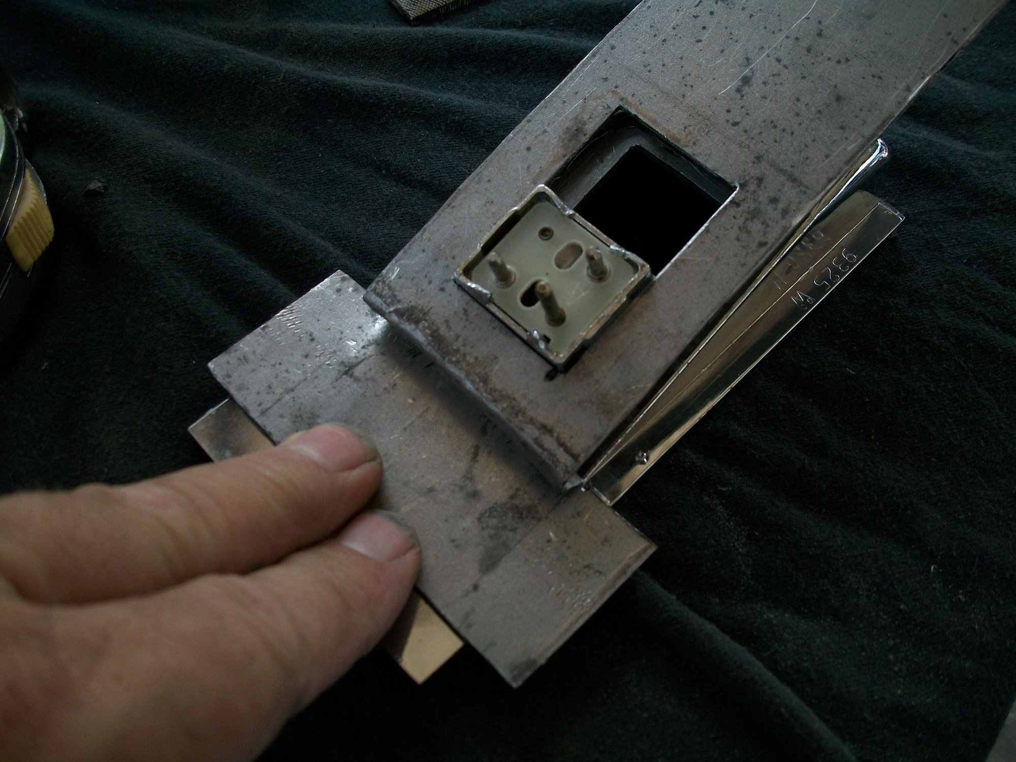

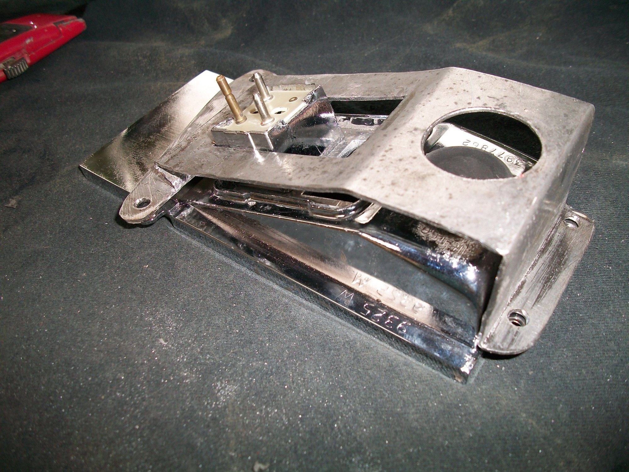

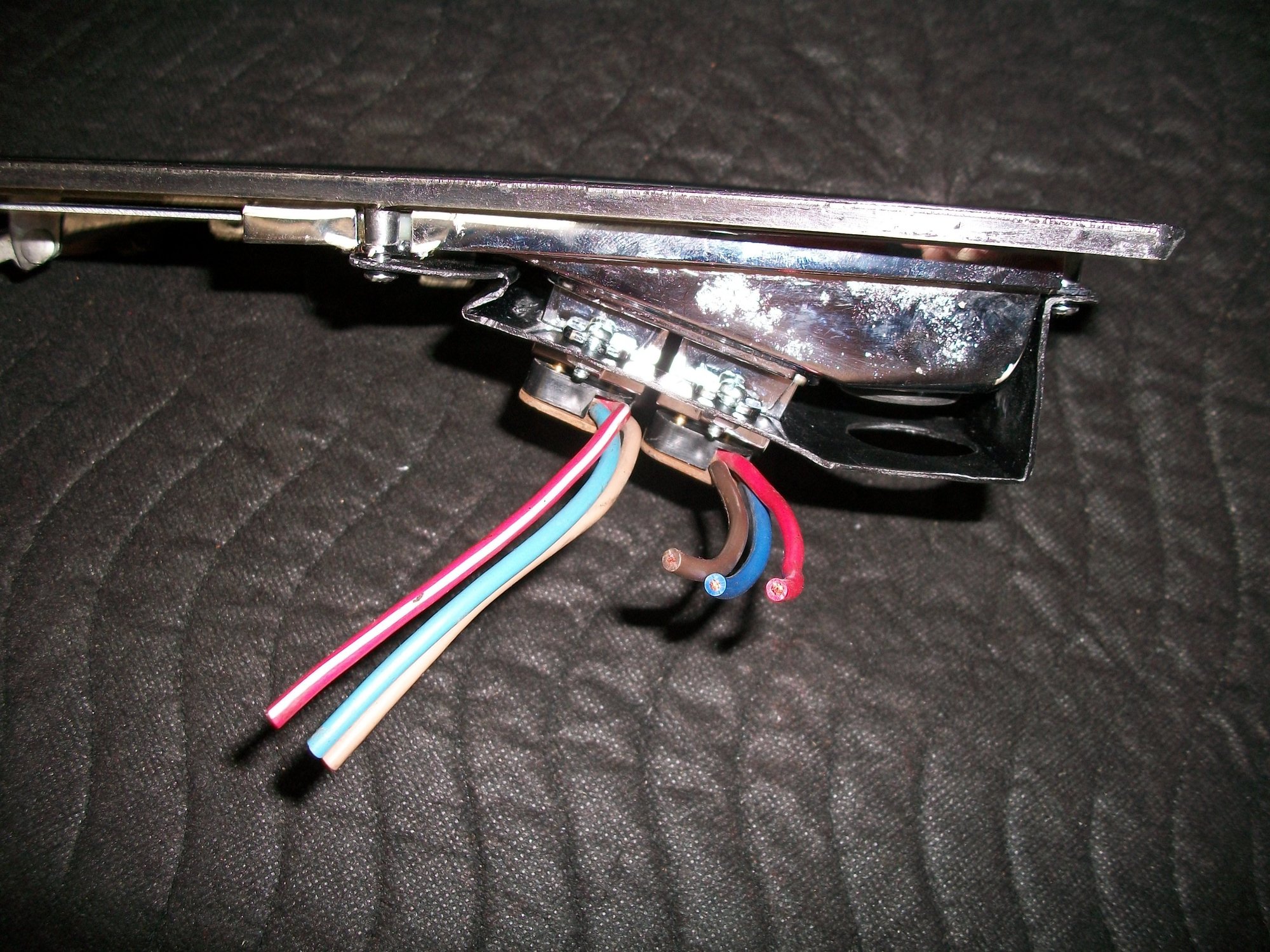

next I took some flat stock and started cutting holes and bending...
to make a bracket to mount the switches. They will bolt to the bracket, then the bracket will be held by the same mounting screws that fasten the ashtray holder to the shifter plate.

Time for another quick update. My son & I have been busy doing some little odds & ends. I finally got the switches mounted and connectors in for the headlight & wiper door over-rides in the ashtray area.

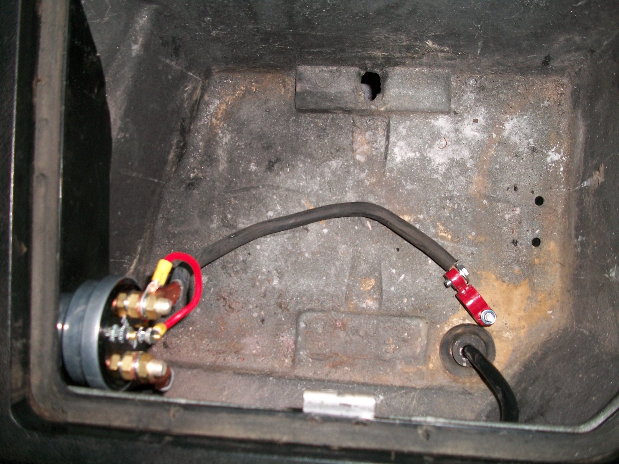

We also added a cutoff switch in the battery compartment, with the switch **** in the glovebox. (First we fiberglassed the cardboard glovebox to give it more strength to hold the switch).

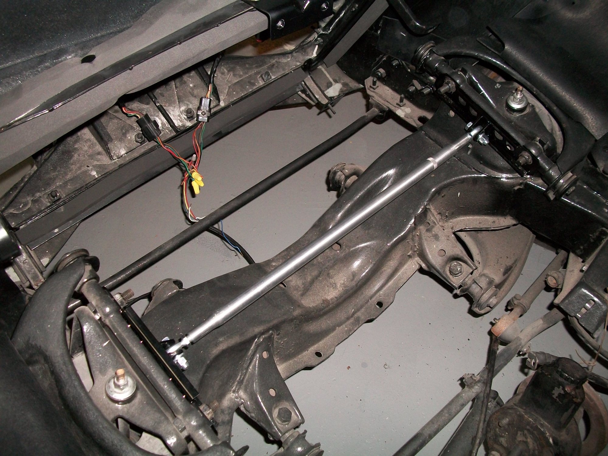

We added the glovebox light, battery hold down kit, brackets for the spreader bar, and new seals in the front end, air dam, engine compartment & radiator support.

That Speed Direct Shark Bite looks real nice in there too!
