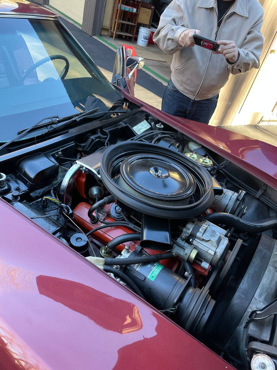

ALL 75’s came with air pumps etc …this is my unmolested all original 75 with 10k on her
