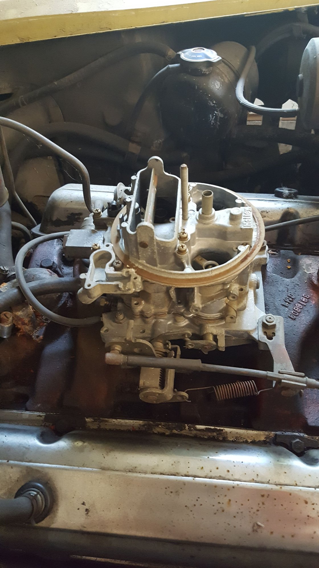

I am looking at picking up another 68 ...this one has a 327/350 with the HT block. What is confusing me is the carb. The car is a mid-October build, the block is matching numbers to the VIN, but this Holley that is on it must be an add on. The car has been sitting for a while. The numbers I see on the carb are L-7456 with a date code of 1608, telling me it was from june 9th 1968.
I guess my question is "was this ever a production carb?" or could this be an early holley service carb....
I expected to find a rochester quadrajet 7028207.
Thanks for any insight!!

I believe your 68 327/350 would have originally had a Q-Jet manufactured by Rochester or Carter on it; not the Holley shown in your photo.
I believe you're looking for a Q-Jet with a Chevy. number of 7028219; the 207 Rochester Q-jet you mention would be for a manual transmission 327/300.

Maybe I'm wrong, but I've read on many sources that the 327/350 L79 in '68 would have a Holley four-barrel.
On '68, only the base 327/300 was equipped by a Rochester carb
http://www.superchevy.com/features/s...vy-l79-engine/
http://vettefacts.com/C3/1968.aspx

The information I'm looking at indicates Holley sourced carbs were used on 427/400, 427/435, and 427/430 engines during the 68 model year.
Perhaps those sources you listed (I could only link to the second of them) are right?
I think perhaps the mention of the Holley in the links refers to it being used on earlier (65-66?) on ChevyII 327/350 engines?
Definitely getting out of my range of knowledge here!

How many is "many"? They are incorrect. Alan is correct regarding the Quadrajet for the L-79. The only smallblock C3s with Holley carburetors were the LT-1s.

Thanks everyone....after looking into this further, it looks to be a Holley 450 cfm Economizer carb, made to be a rochester replacement.

The Qjet 7028219 is the correct carburetor. I have a October 1967 build date, numbers matching with this unit. It is a L79 car. Allen is correct.

My late March 1968 Coupe L-79 had a Q-jet from the factory, like all of the 68's. Only the C-2's had a Holly carburetor. Lou.
