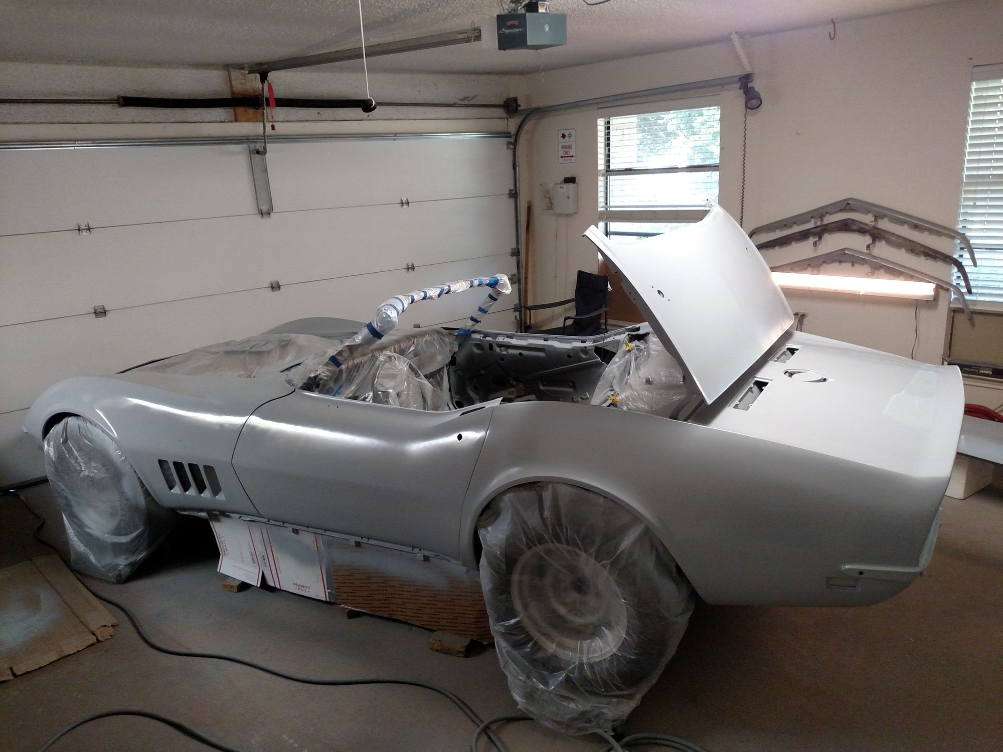

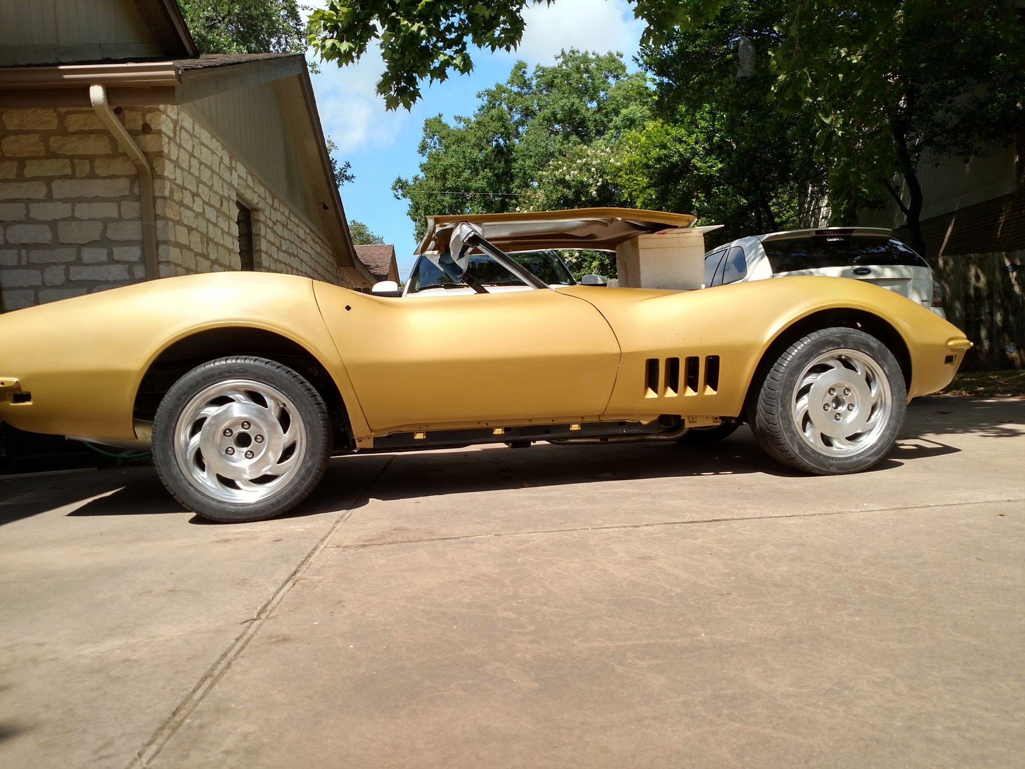

I just finished spraying my 69, original color RiverSide Gold.

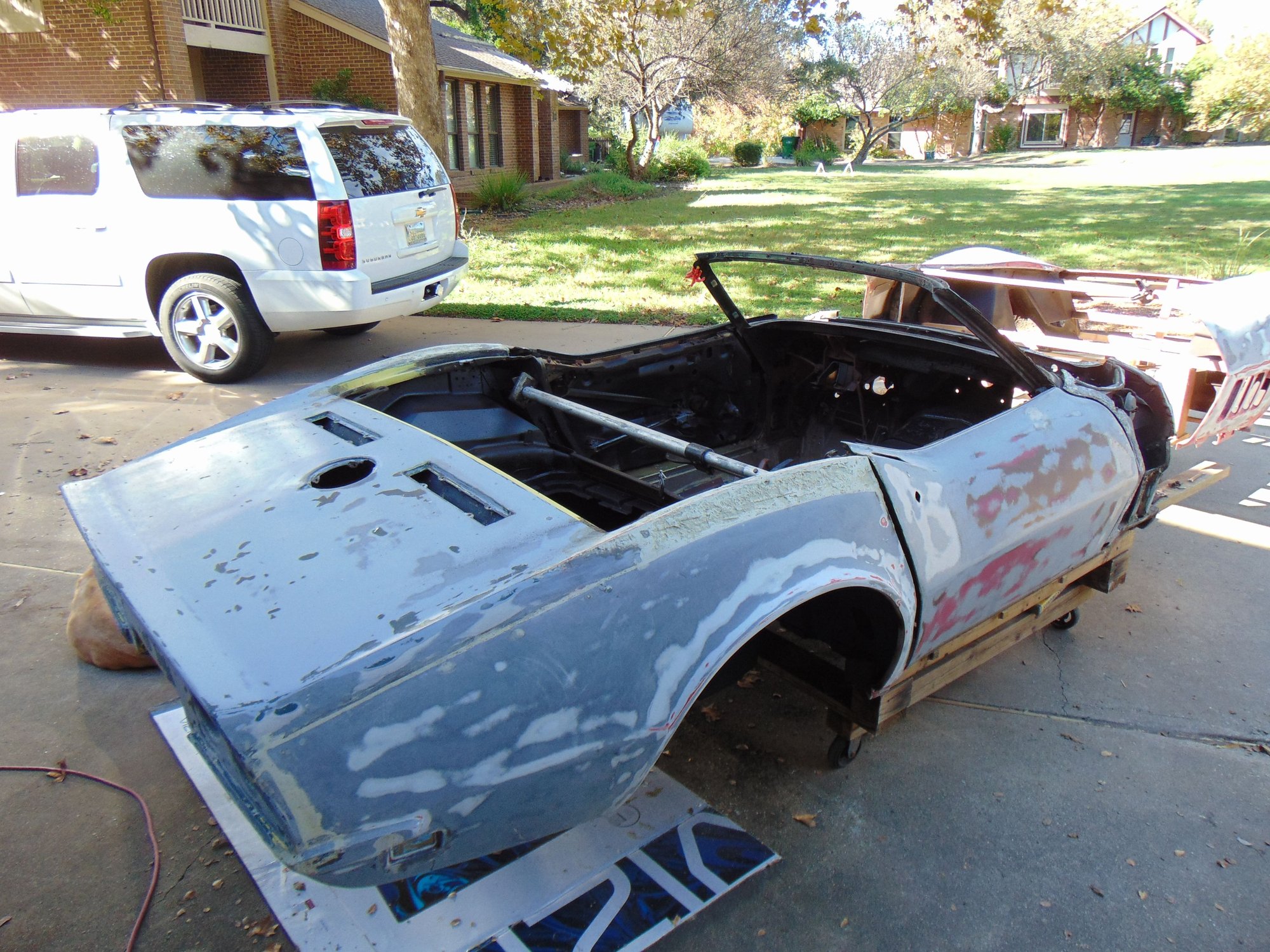

This was a huge project, this car burnt up in a fire over 20 years ago.
I replaced every piece of fiberglass, it is now full number matching car.
with original motor, all new HP inside motor.
RiverSide Gold Dupont CromaBase #980
Bake out in the Texas Sun !
wet sanding, I use SPI primer and clearcoat.

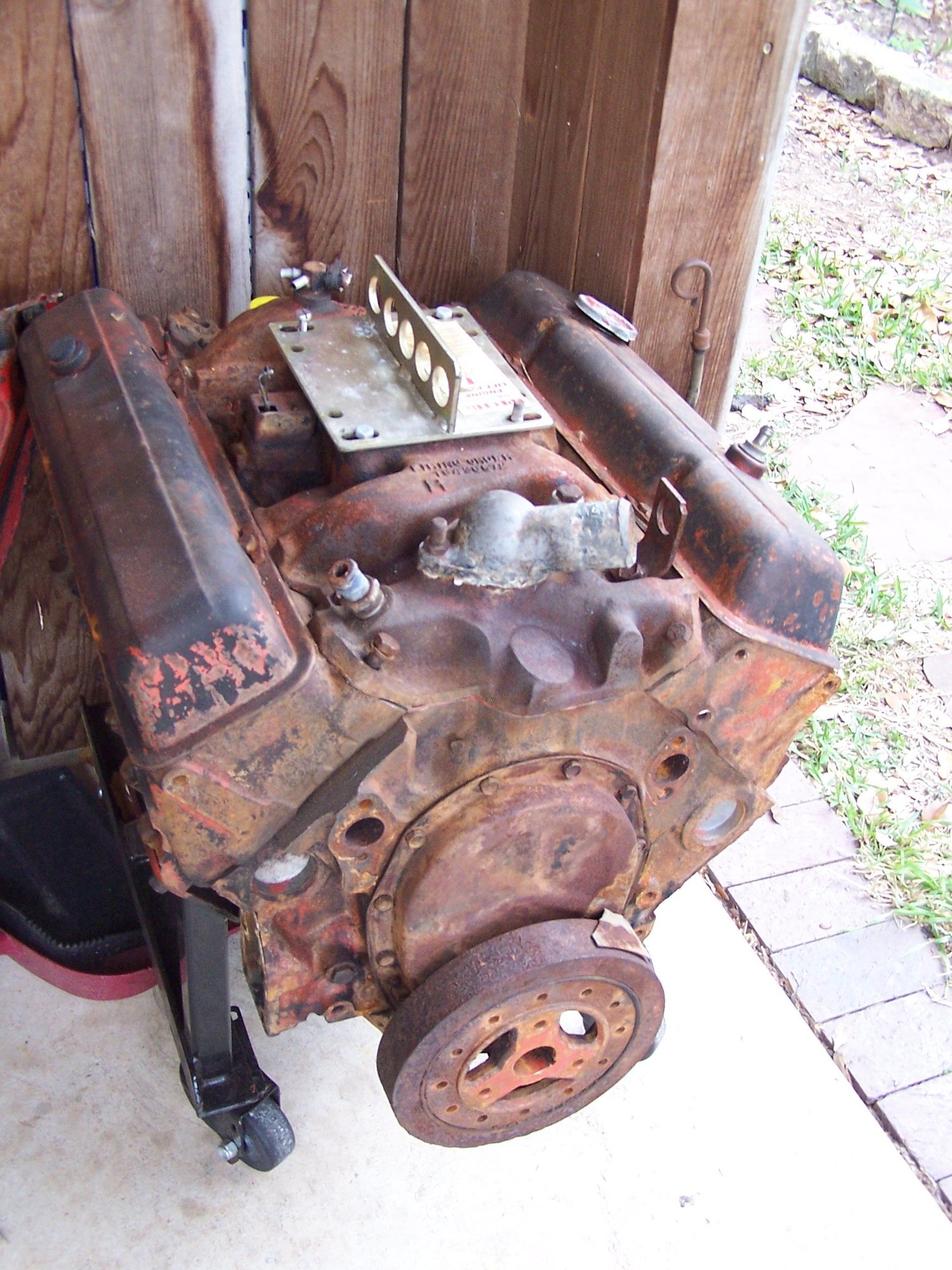

orginal block, all new insides including Crank and pistons 425 HP
the way I found it, everything burnt.

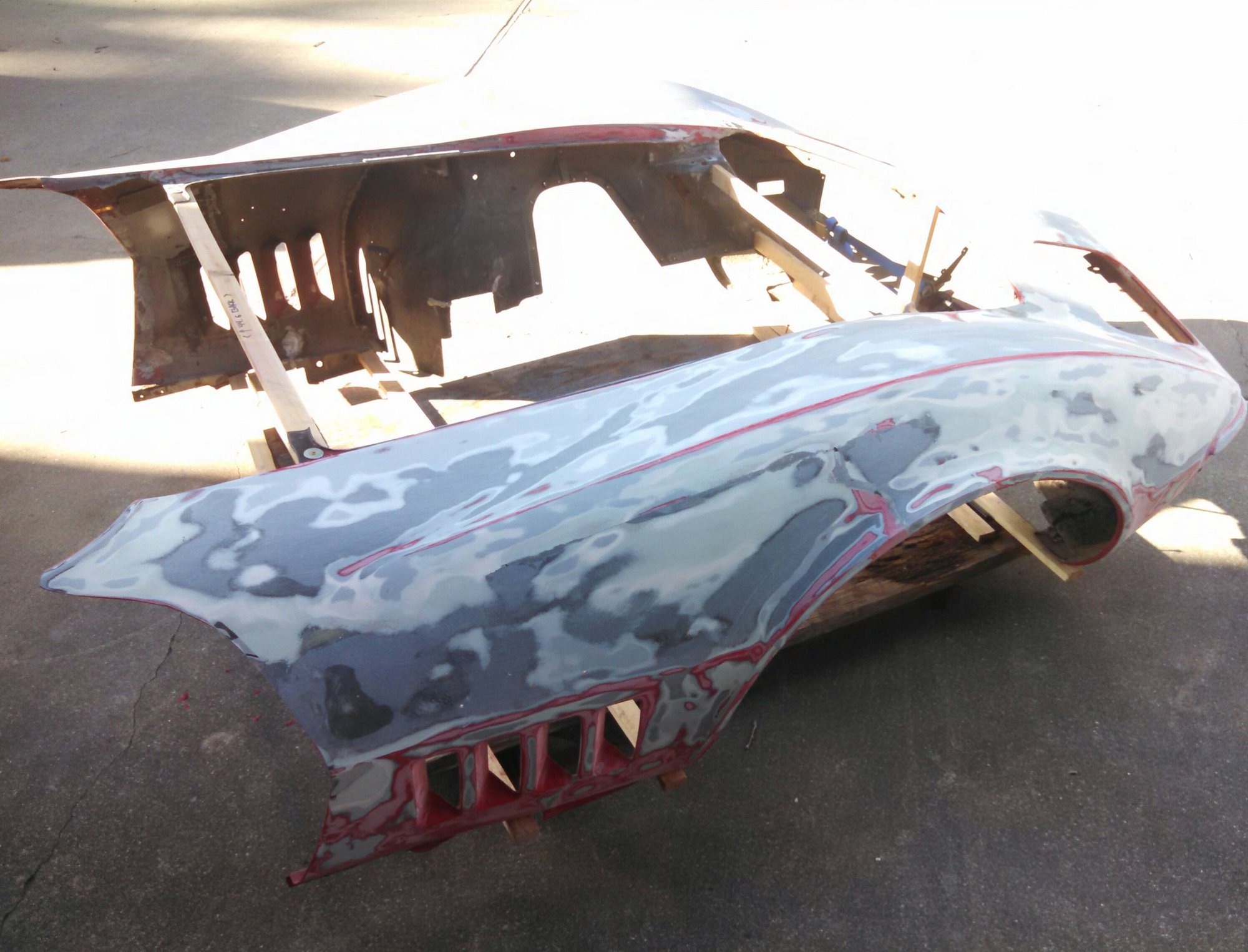

most burnt removed, prepping for rear clip
replacement rearclip, big installation job !
replacement front clip
original motor 350/350

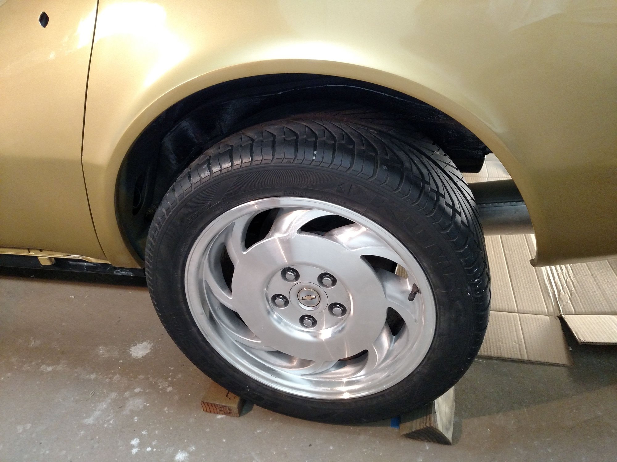

yes, C4 wheels with custom center caps !
the choosen wheel ! the wheels will be fully polished when done.

Yes, I do all work myself except, motor machine work.
including all body work, and paint.
I use SPI primer and SPI clear,
and buy my basecoat at local automotive paint store.
Had this Not been complete full matching#'s vehicle.
I would Not have replaced every fiberglass part,
just massive amount of work.
my hobby, has become full time work !
thanks ! 69VETT
