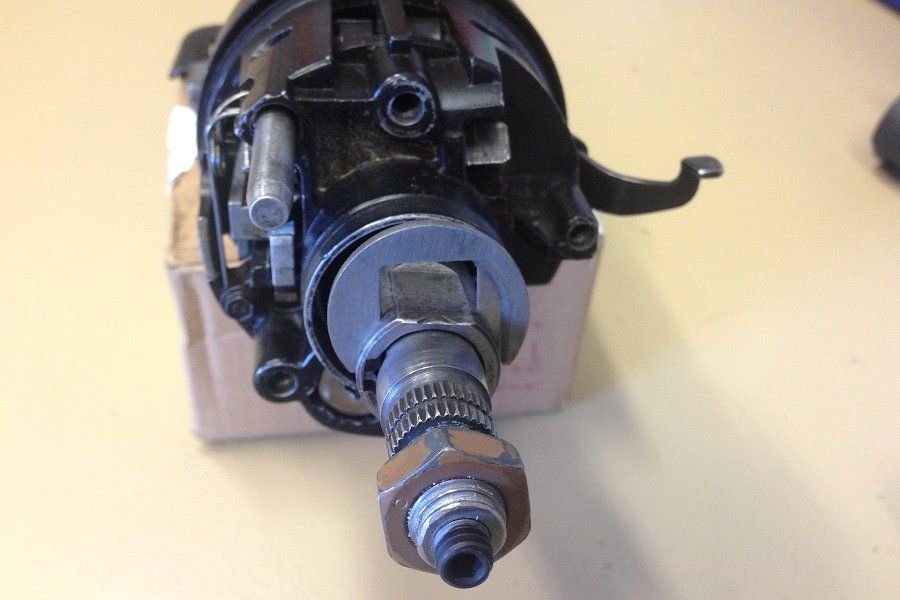

You mentioned that you "can't get the steering lock gear in place cause I can't compress it down enough." I assume you are referring to the steering wheel locking plate. Are you using a set screw to lock the telescope down?

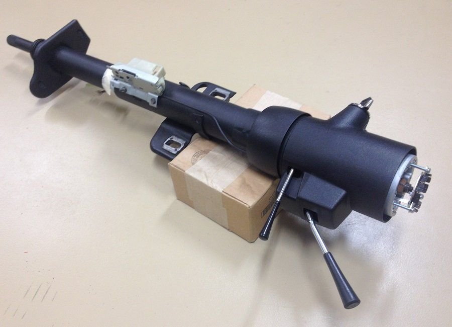

Anyway, I measured the 1979 T&T steering column I rebuilt, and it measures 35 1/4" from the end of the steering shaft to the top edge of the case.

You forget to insert an ALLEN head set screw down into the shaft....so it holds your telescopic shaft and THEN you can compress it and install the C clip and designed.
MAKE SURE you have you horn contact and the lock plate CORRECTLY installed. Many people often times did not pay attention and will flip the LOCK PLATE upside down and that screws EVERYTHING UP.
IF you still can not get it...and WANT TO take it part and lay the parts out and take a photo(s)....and label these parts...I would be willing to tell you what to install in correct sequence.

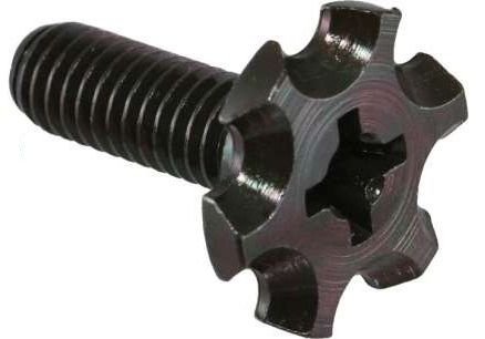

<---SNIP---> no, I didn't do what you said about the Allen set screw, I'm not actually sure how you mean to do that, I've never messed with a column like this before, one with the telescopic
FWIW...
Allen set screw (most hardware stores carry a wide variety). Match the thread to the star screw from your column.
You remove the star screw and use the set screw to hold the tele in place. Using a set screw gives you the room to properly use the steering column lock ring compressor.
