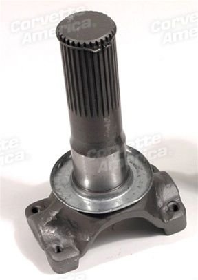

1976

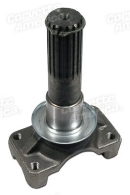

1980

That raises more questions than answers. The pictures of the new '76 and '80 yokes show a different number of splines on the different years. If true, then a '76 wouldn't fit in a stock '80 rear end.
That goes back to another post about possibility having the guts of a '76 rear in the '80 housing.

YES..the side yoke photo is that of a 1976 design side yoke and it does not appear to be modified.
Or better yet...another photo with both side yokes side by side so we can see how.... as you wrote.... someone cut one down.
