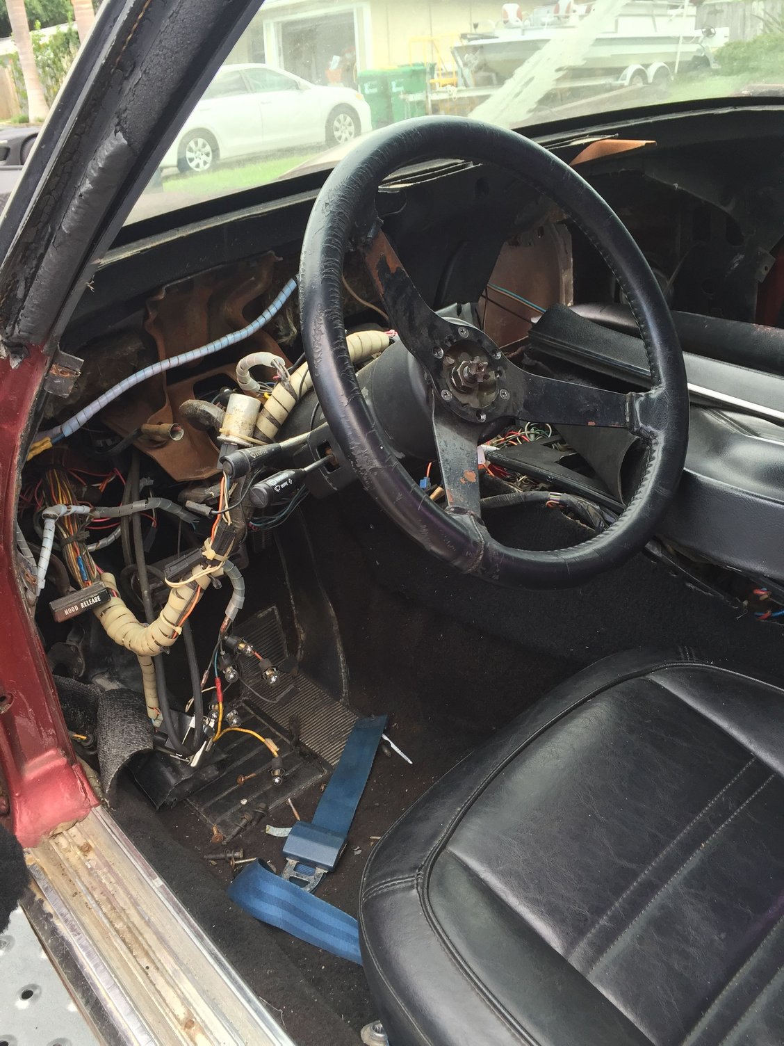

New to the forum, so I'll apologize if this has been covered somewhere else. I just picked up a 77 and an 89 that he threw in the deal. I paid basically nothing for the 77.
My question is, should I part this car out or should I put it back together for a driver? Its been hit on the front passenger side, the frame doesn't look bad, but I can tell from the body work that's been done. I know this car will not be a show queen or bring big money. But I'm a corvette guy and hate seeing them torn apart.

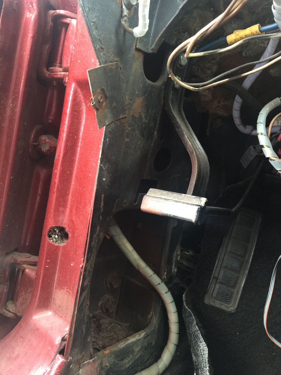

Easiest things to check is remove the kick panels and the interior windshield trim. That won't tell you everything, but you will know right away if it is Swiss cheese. Check for pieces of rust behind the kick panels.

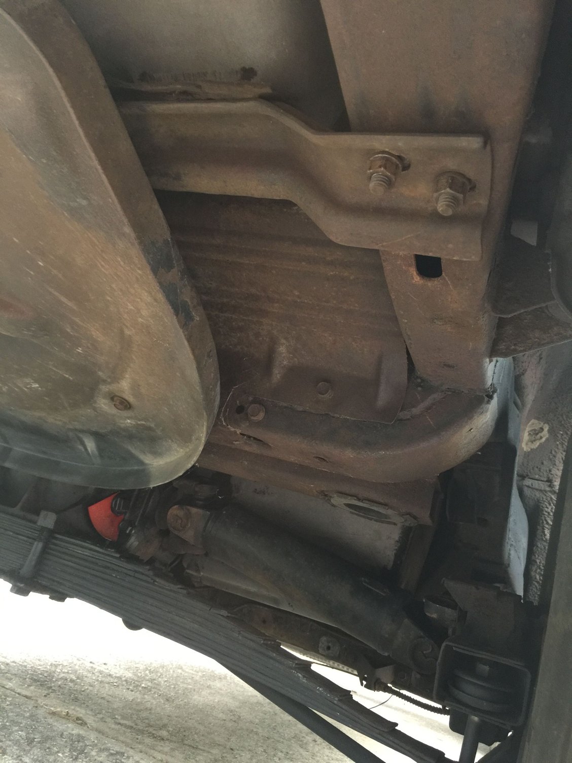

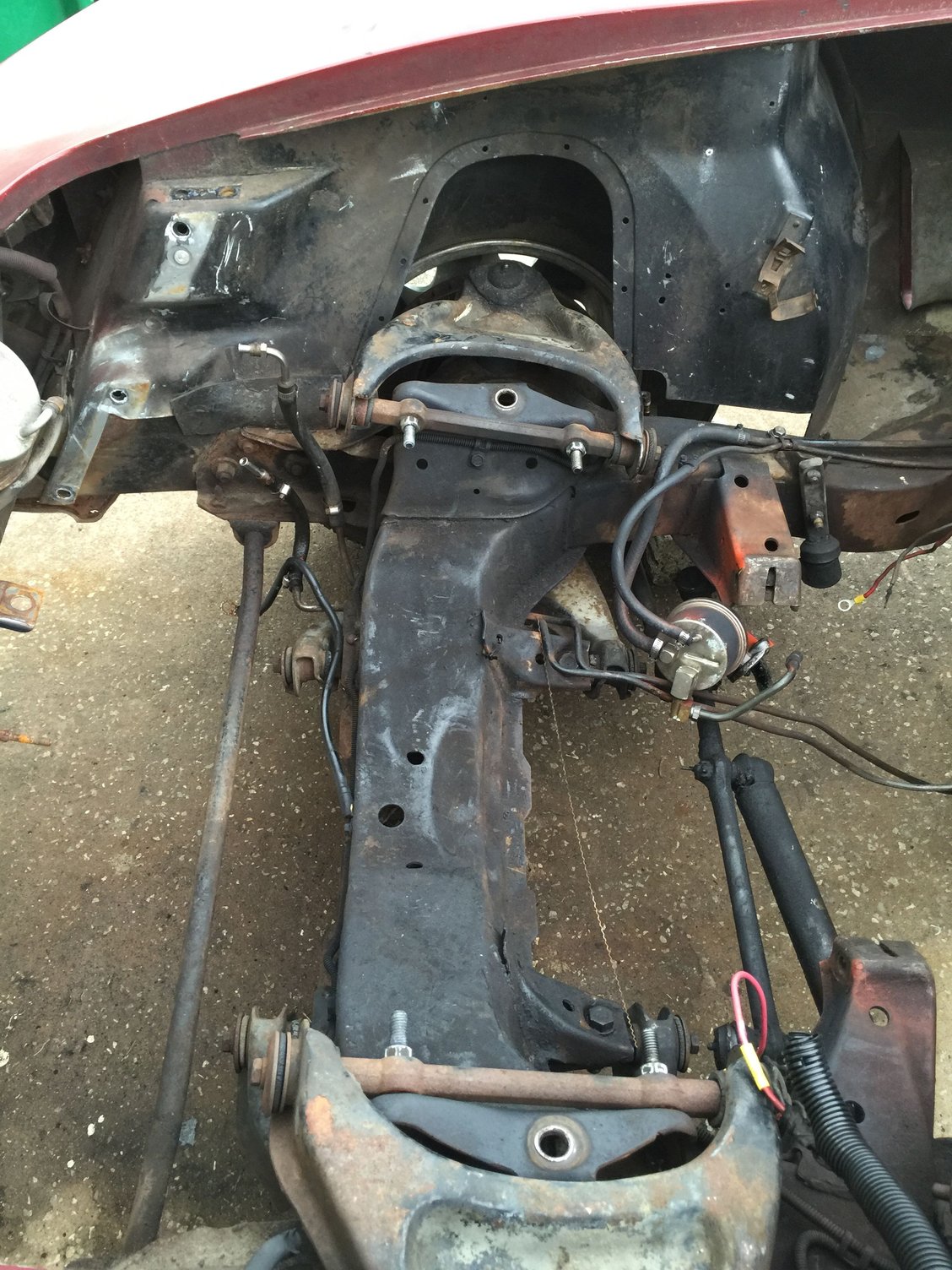

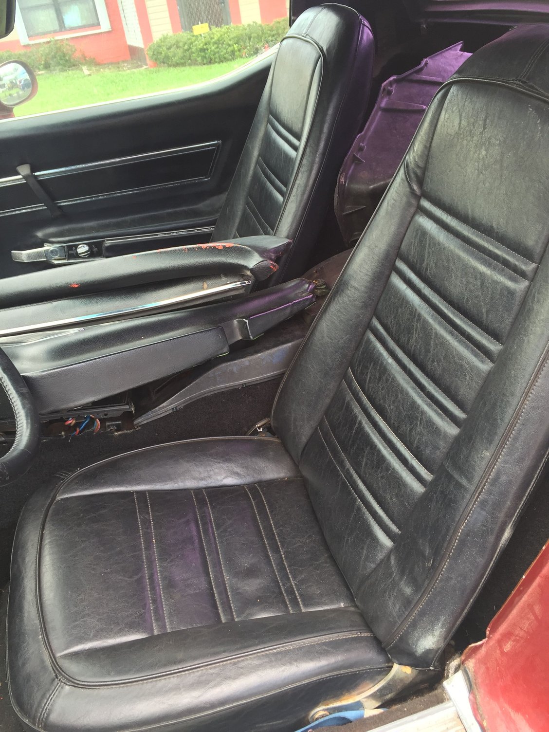

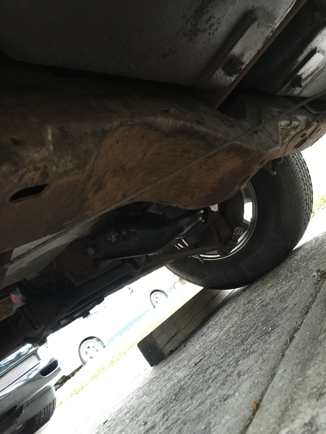

So it looks like a sort of restoration for this one! Won't be a quick one, but I'm going to keep it.
The birdcage looks good and frame looks good as well. I did see one spot on the frame that has a broken weld, but I'll take car of that. Tell me what you think about the pics below. I'm not in a spot where I can afford to buy a driver right now so this will be my project and one I'll probably keep for a long time since I'm starting with very little investment. Thanks to everyone for the input! I'll have to setup a build thread for this. Any suggestions on engines and transmissions? I know the typical 350, just making sure I'm not missing something.

None of the rust shown in those photos is a concern, IMO. I would look for a good LS package (engine, trans, ECU and cables) to stick in there. Complete drivetrain makes more sense to me than rebuilding old version hardware. Better HP, mileage, better running manners; O/D transmission with lockup; all-around improvement in performance, economy and reliability. And, with a lighter engine, the balance will be about perfect.
