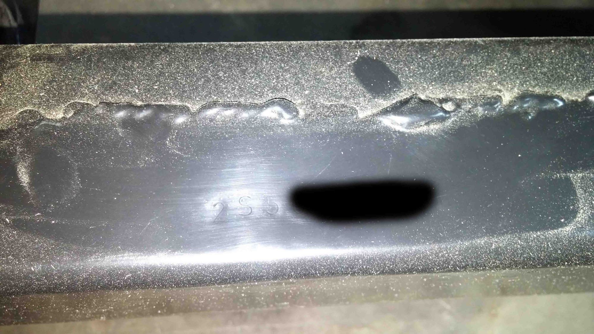

Had my frame blasted and powder coated and can read the frame stamp just fine. (I blacked out the end of the VIN... don't really want it online.... and hope you don't mind the dust! )
