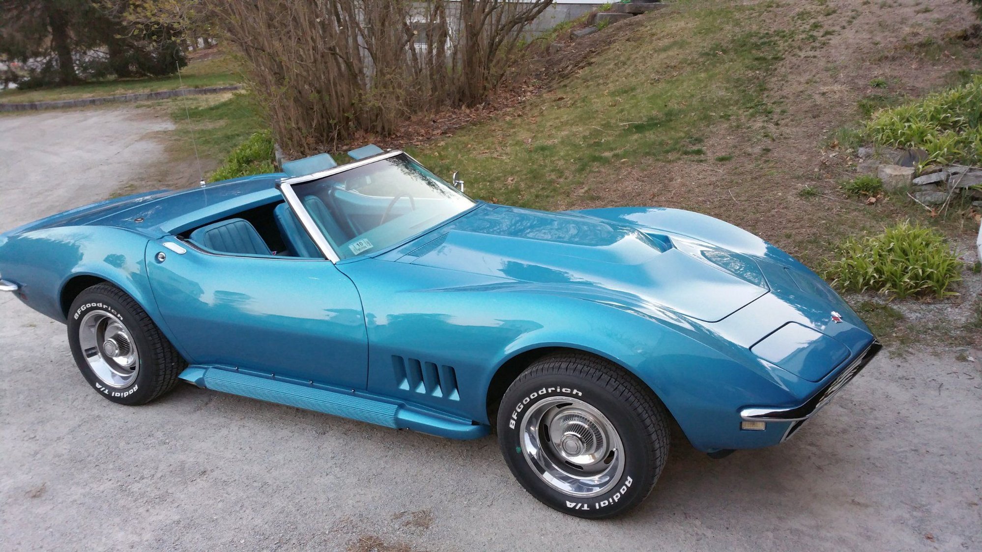

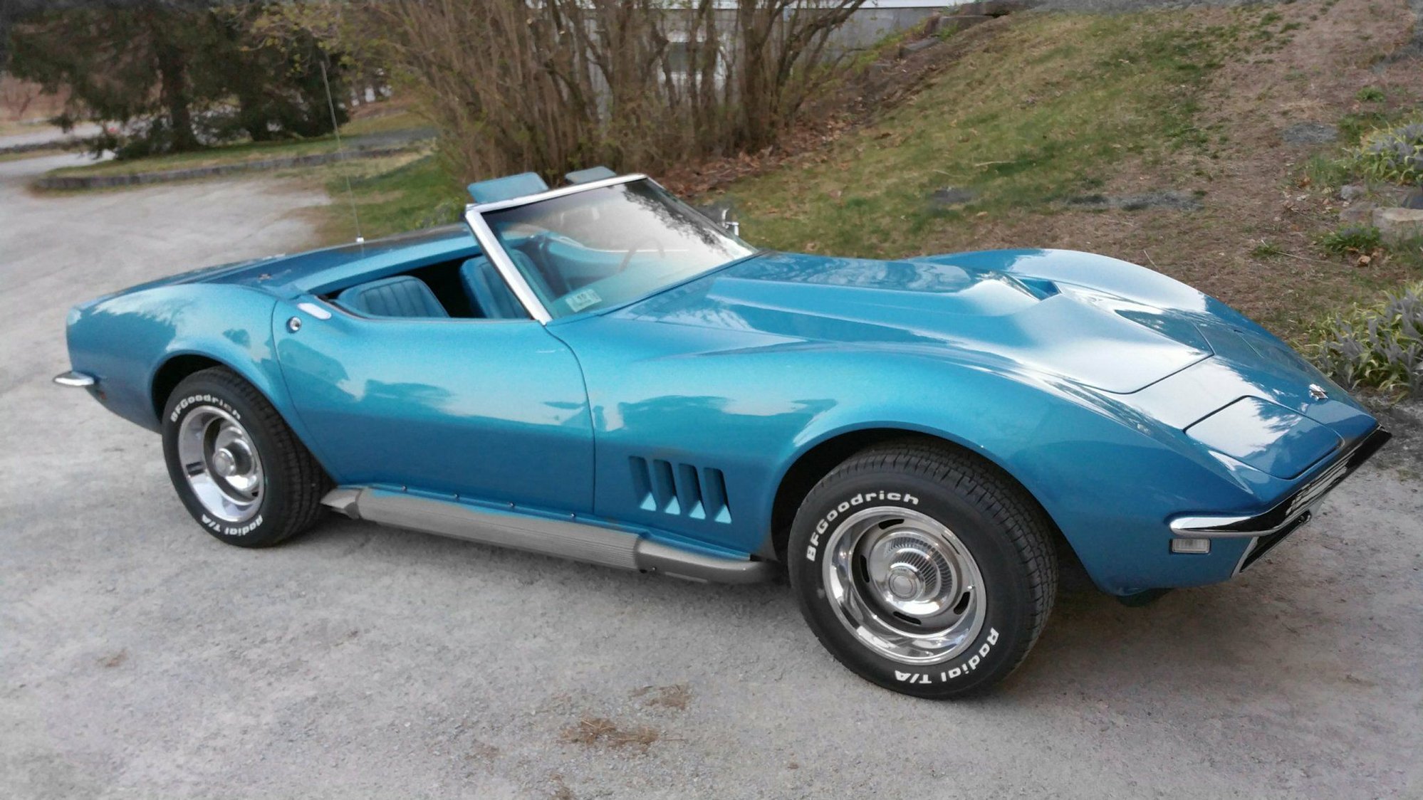

Mine are the reverse flow style. Moderate at idle and cruising, loud under throttle. I have the fiberglass covers as well. They were on the car when I bought it and bubba used what ever screw he could find to mount them. I glassed the old holes closed and redrilled them and used the proper machine screw with a plastic washer to prevent cracking. They are painted to match the car color but I think its too much. I want to chrome them paint platers are a dieing breed. I might try wrapping the ends and leave the middle.

Love the car and the side pipes look great. That's what I'm looking for.

Actually no. Theres a good gap on mine and the heat doesnt transfer well. Getting out after a 2 hour drive I put my hand right on them, may be warm or hot, but not burning at all.
I figure if they can chrome plate plastic model parts, someone can plate these, just no one around me. Mine are all blue still and the 2 others are obviously photo shopped. But it gives me a direction to try and go in

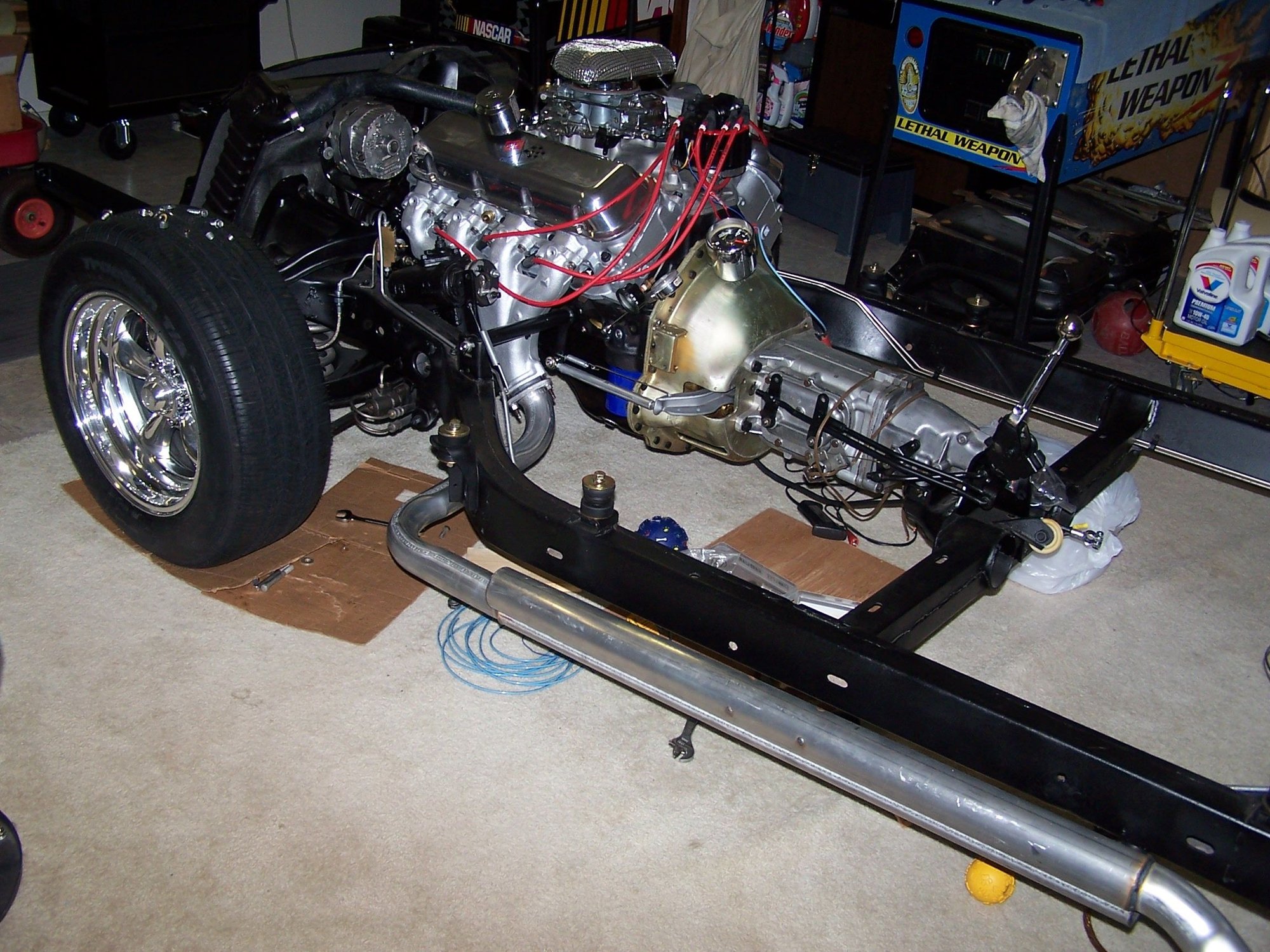

covers and Exhaust 2 different things.
I installed Sweet Thunder, they seem just right not to Loud, but sound great.

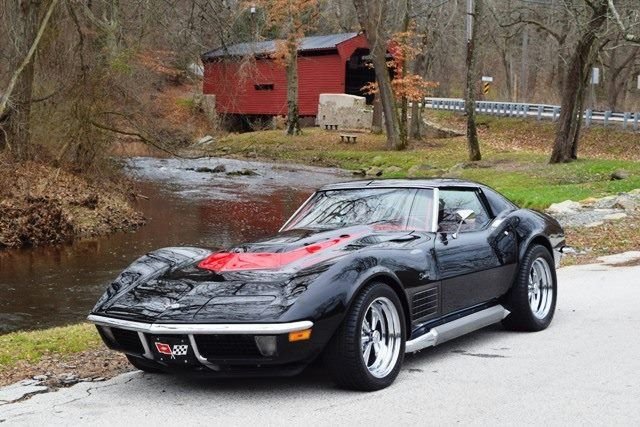

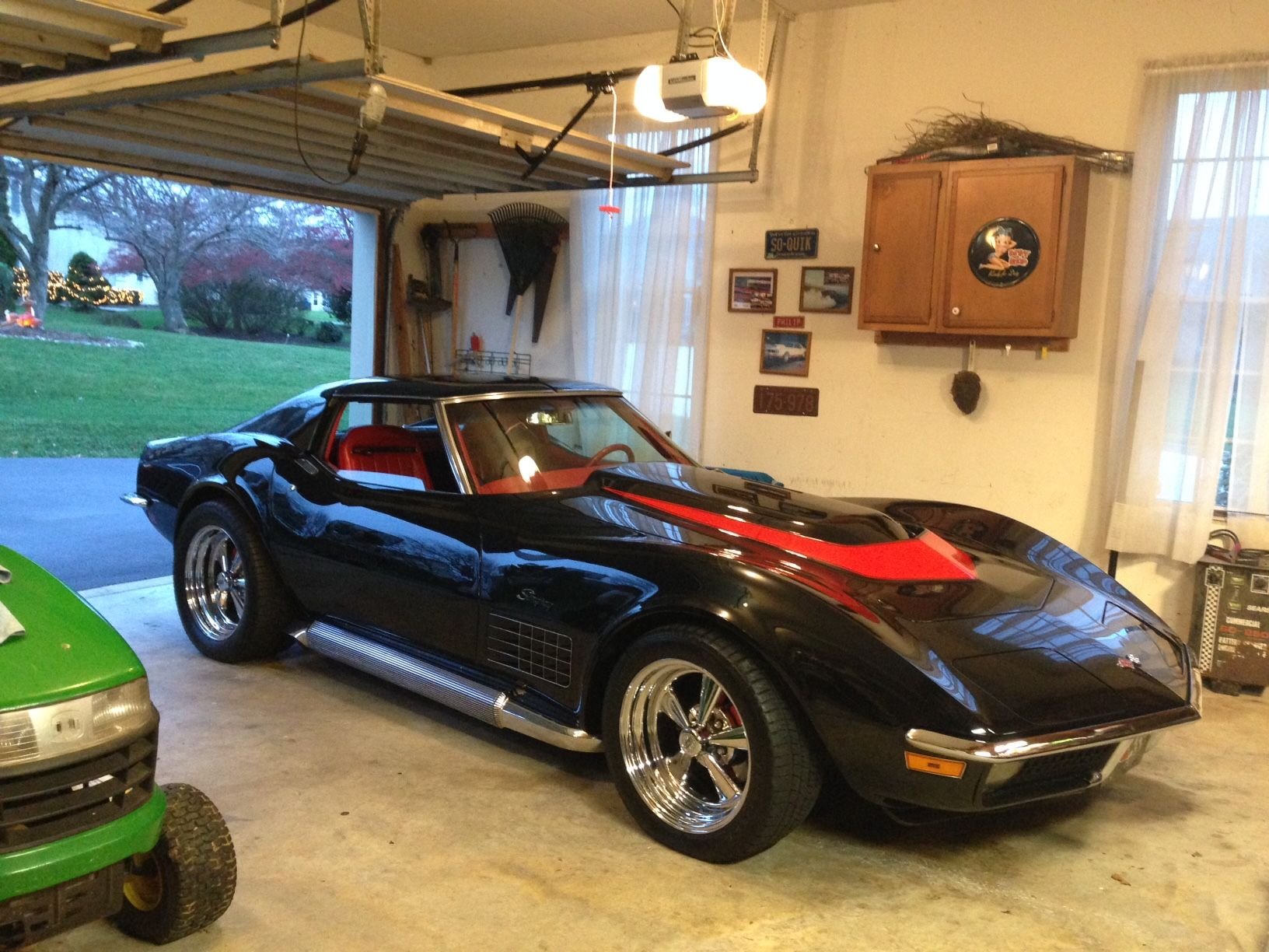

Default 71 Black Vette 383 stroker, 700 R4,AC,PS,PB,Tilt,PW
Use Headman side exit headers and sweet thunder exhaust
