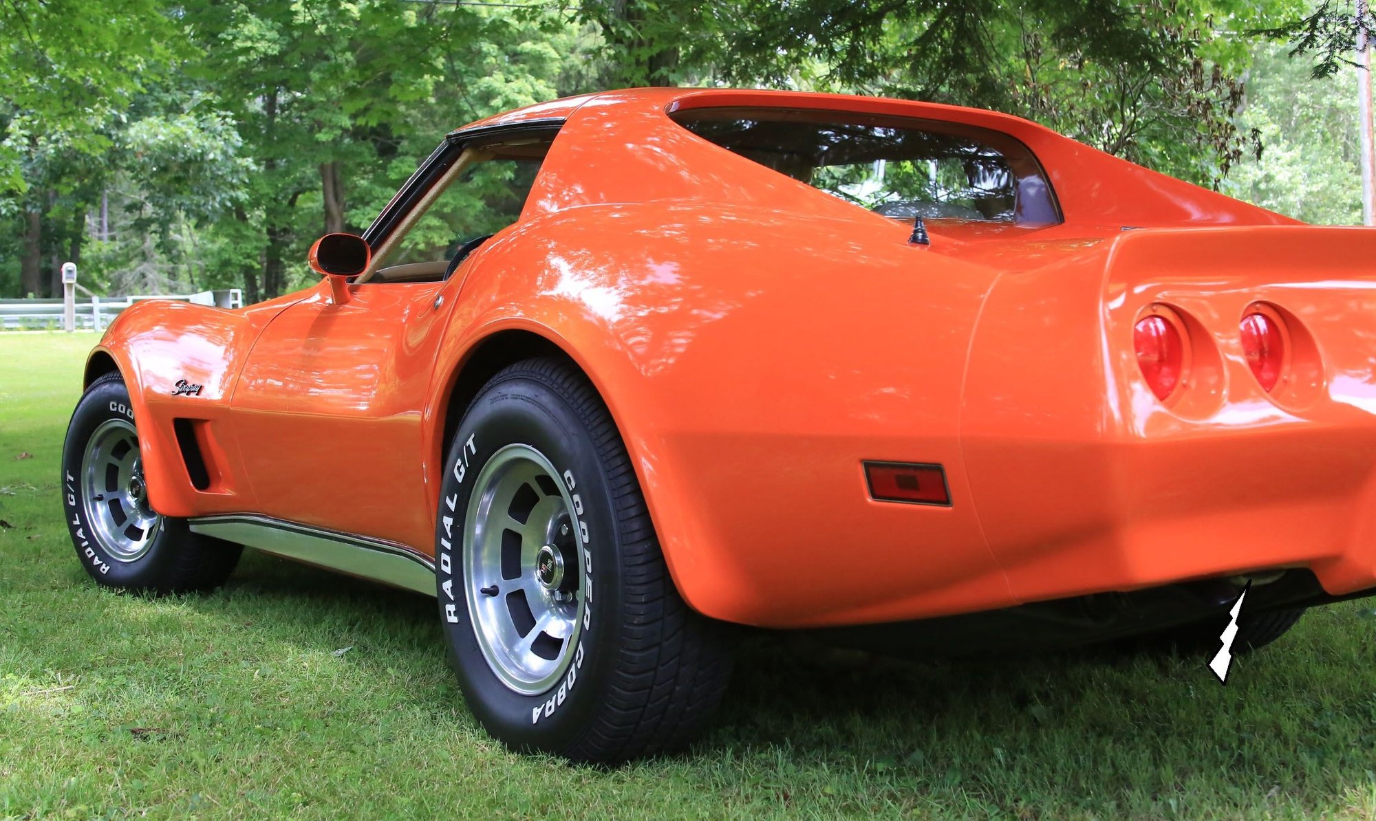

My 75 with bubbles, i looked at the leds but passed on them, just not old school.
Never missed the backup light after the bubbles. With your foot on the brake petal the illumination from the four brake lights would far excede the backup light

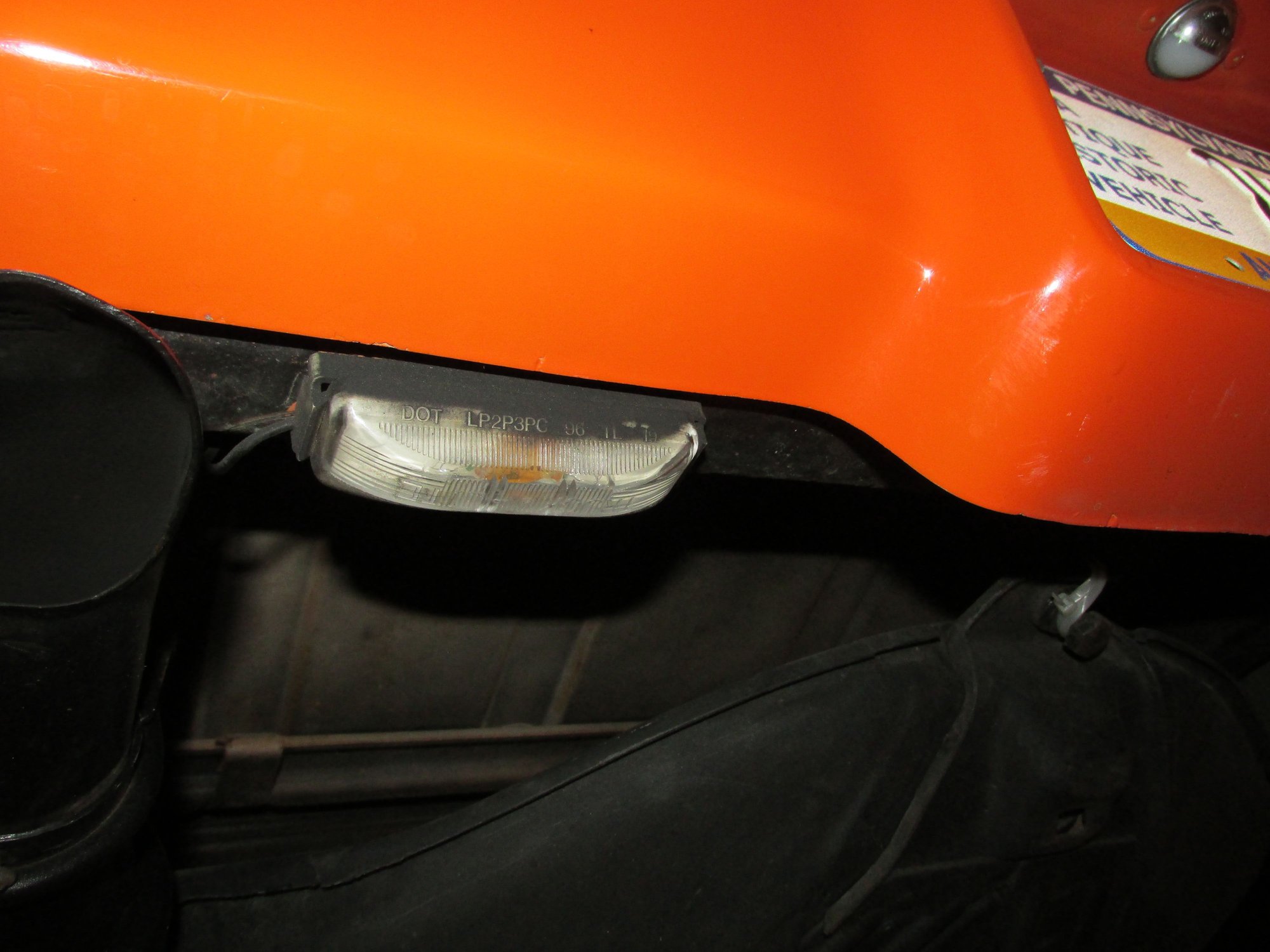

I have Grote # 9076 brake lenses on all 4 lights. There are a pair of 1"x3" surface mount lights mounted to the bumper cover support on either side of the license plate. Lights are barely visible but provide enough light to back into a dark garage.

Originally Posted by oldgto
Do you ave a better picture of the reverse lights? I`d like to see how they look.... as I`m not yet 100% sold on the LED license plate frame idea.....
This is the driver's side BU light about half way between the exhaust turn down and the license valence. hope the pic helps.

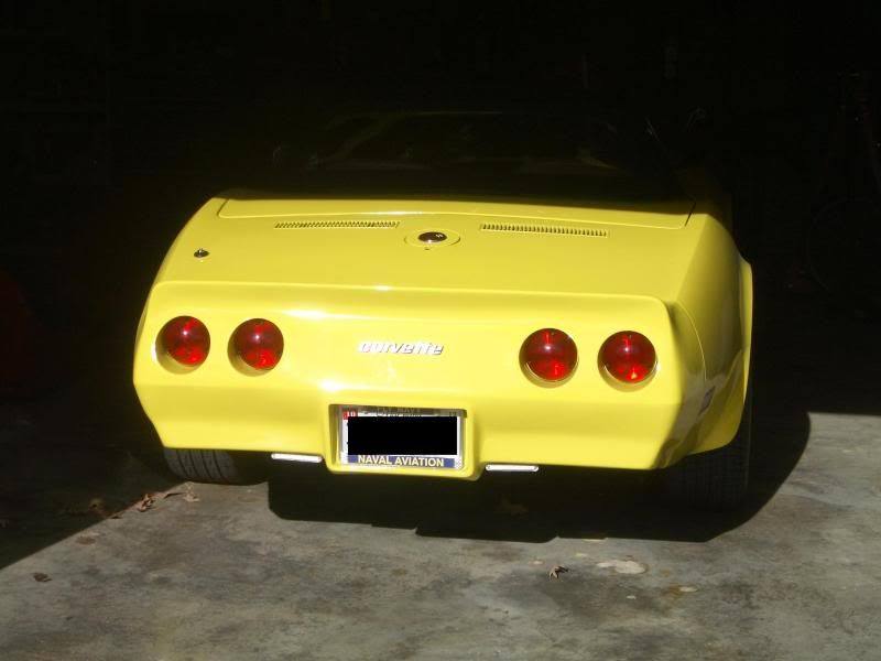

LED's on bottom edge of the bumper. Not really bright but satisfy legal requirements for inspection (or if someone hits me when I am backing up).
Old Jul 18, 2016 | 10:53 AM
Richard Daugird's Avatar
Richard Daugird
Joined: Dec 2015
Posts: 3,181
Likes: 732
From: Texas City, TX Texas
Those last two are pretty slick! However, I was thinking more of some that faced rear, to do double duty;for backing up, and to ward off the a$$hole behind me with the blinding blue headlights! Maybe something behind the seats in the rear window?

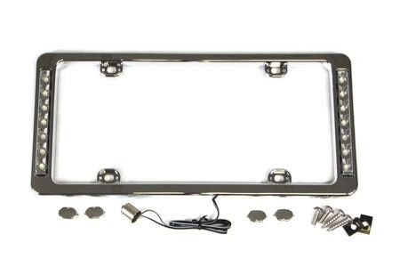

That... and this picture of a forum member`s car.... got me thinking about the LED license plate frame....
Here`s one I found on-line for about $36

The frame only covers around the edge, and the lights are along the top, or sides of the frame.
License plate frames are legal here in Florida, but I don`t know about other states.
