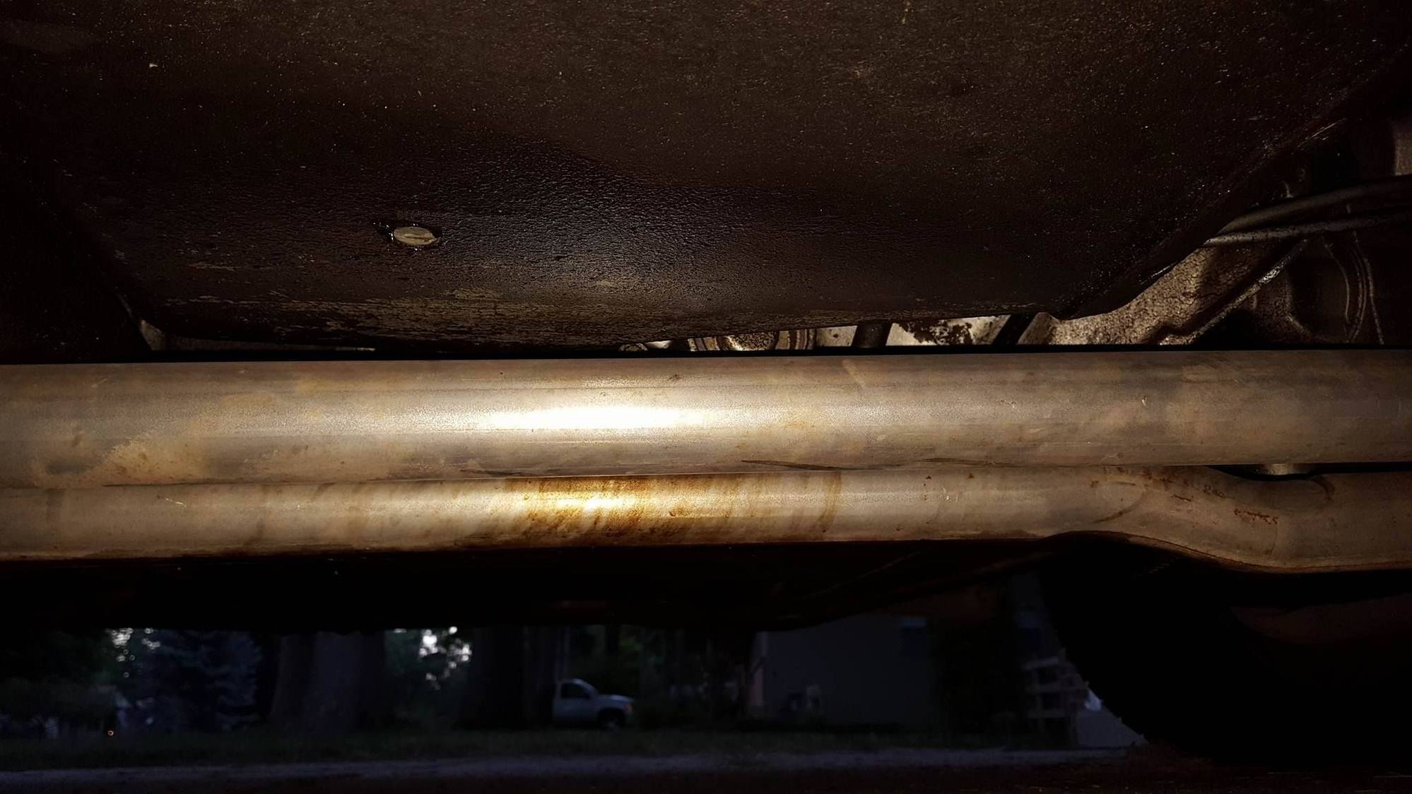

Old Jul 20, 2016 | 09:30 PM
Exuerate's Avatar
Exuerate
6th Gear
Joined: Jul 2016
Posts: 6
From: Michigan
apologies for the rushed random pictures. gotta work at 3 am.
Old Jul 21, 2016 | 08:36 AM
gerry72's Avatar
gerry72
Joined: Aug 2000
Posts: 3,711
Likes: 43
From: San Antonio TX
Most of it looks okay. The fit of the front fenders seems a bit off toward the top. The gap seems much wider and a bit proud of the alignment to the door. May just be an artifact of the photography. If it's not the photography and it really is like that, you might want a bit more inspection of the front frame rails or how the front clip is bonded to the bulkhead. There is quite a bit of fluid leakage, but that could be nothing more than valve cover gaskets and the trans pan. Hard to say without cleaning and leak checking, but if it is those gaskets, they're cheap and easy to replace.
It's not a perfect car, but it's also not bad. How acceptable its flaws are depends upon your ability to address them. Some folks work on their cars as time, money and skills allow. Other folks fix cars with a checkbook. Old Corvettes are not for people who fix cars with a checkbook.
Old Jul 21, 2016 | 08:46 AM
AllC34Me's Avatar
AllC34Me
Senior Member
Joined: Jan 2008
Posts: 12,146
Likes: 2,038
From: Easton, PA
St. Jude Donor '10
The pictures help a lot, thank you for sharing them. Looks like a lot of potential there, nothing that would scare me away really. Have fun with it.

Old Jul 21, 2016 | 09:18 AM
2TONE82's Avatar
2TONE82
Joined: Nov 1999
Posts: 2,460
Likes: 352
From: Madison Alabama
Are you sure it is an 82? A lot of badges, emblems from an 81 to include speed, teach and steering wheel but seems to have the monoleaf rear spring for an 82...can you provide the VIN?
It is sitting high in the back, like when rear-end suspension work has recently been done or it's been on a lift. A few other things I'd question but those are the big ones for now.

Old Jul 21, 2016 | 11:08 AM
76C3forme's Avatar
76C3forme
Joined: Apr 2016
Posts: 494
Likes: 93
From: Bucks County PA
Wondering if the Previous owner just added those emblems?? He or an owner before him, obviously added the Stingray Emblems on the fenders at some point.
Nothing that would really stop me from buying the car. (But I'd want to remove the kick panels and check what's visible at least of the birdcage and make sure there is no damage there. I've seen a lot of nice looking cars that have had T-Top leaks and the lower birdcage is completely rotted out under the kick panel.
Looks like it could be a pretty cool project though..
Old Jul 21, 2016 | 11:42 AM
2TONE82's Avatar
2TONE82
Joined: Nov 1999
Posts: 2,460
Likes: 352
Originally Posted by 76C3forme
Wondering if the Previous owner just added those emblems?? He or an owner before him, obviously added the Stingray Emblems on the fenders at some point...
Agree but am starting to wonder if this was the joining of two cars...the speed/teach emblems and steering wheel were not easy emblems to replace. VIN will tell and am interested to see the motor - crossfire or not? But at $5K it's a great car to learn on, very similar to my first 82. Great learning experience!
Old Jul 21, 2016 | 01:37 PM
Buccaneer's Avatar
Buccaneer
Joined: Nov 2005
Posts: 3,532
Likes: 1,185
From: Arizona - If you don’t know CFI, STOP proliferating the myths around it...
WOW! Just WOW! I'm with 2Tone, lots of 81 items and mix matched things for sure, if it's an 82. Is it a crossfire motor? Looks like collectors edition interior, but horn button is not 82. Wheels are not looking like 82 and center caps are 81. Where's the front lower spoiler? Lots of work for sure and IMO $5,500 would be too much. Good luck with the car.
